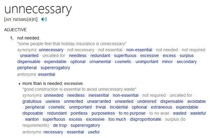

I never said it was wrong, I said it was unnecessary.
No I would say it should not be done. It's not necessary.
Do you want to try and claim that there is no intimation of any degree of "wrongness" in doing something which "should not be done"?
Do you want to try and claim that there is no intimation of any degree of "wrongness" in any of the synonyms of "unnecessary"?
