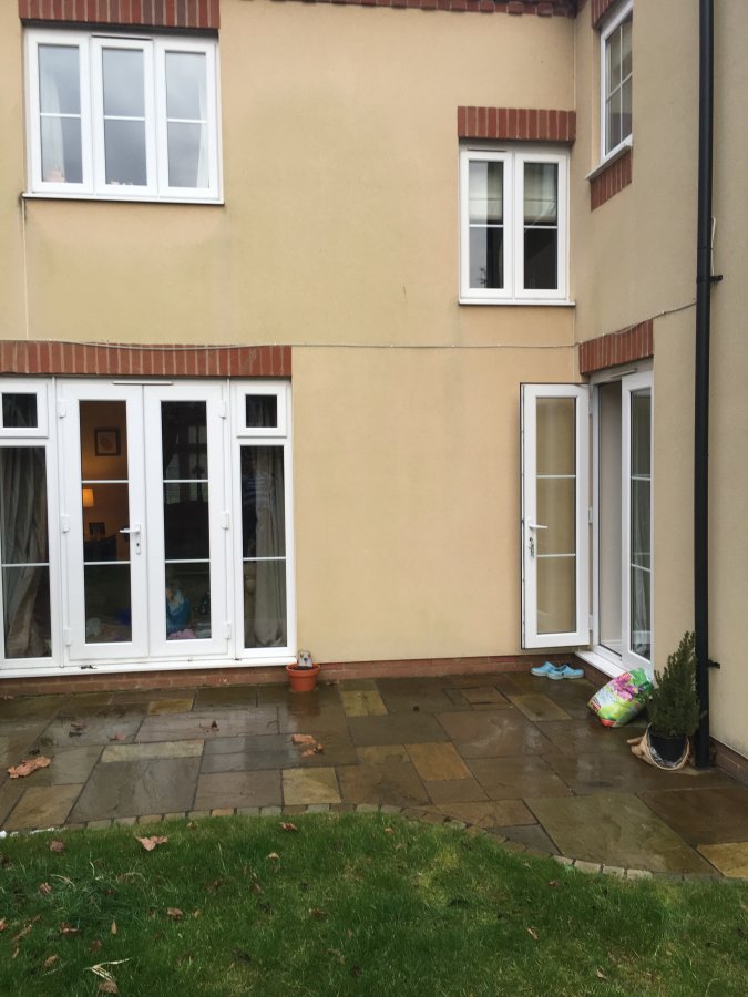

Hi I am planning on a single storey rear extension filling in the L shape quite straight forward with a flat roof but the problem is I have a low window for the stairwell in the corner which restricts how I build the warm flat roof I planned , can I hang the roof joists lower to keep the deck down giving me the space for the roof and pitch ? I will post a section up f what I mean soon

Thanks for the reply I am not to concerned with the lower ceiling height I wanted to avoid adjusting the window if possible,in regards to a cold roof I did consider it but i thought a warm roof would be better
Basically I have 525mm from existing lintel to the window , so when I build up and have new doors I think my cavity lintel will be about 225mm high leaving me 300mm and 150mm will be taken by joist height leaving only 150 for insulation and board/pitch, that's why I thought having the Lintel with 1 course of blocks above then hanging the joists down but this also concerns me as the joist won't sit past the outer skin giving a issue forming the fascia

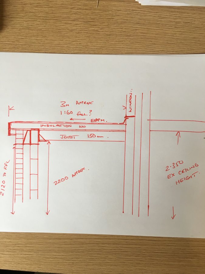

Rough sketch added is this feasible as I really wanted to leave the window alone
If not it will have to be cold deck

Just going by that sketch, I think it would look crap. Change the landing window, or alternatively agree a roof construction with the inspector that involves complete insualtion within the joists and a little beneath - just like a SIPS panel roof.
I spoke to a labc inspector today where I work he said go with a cold roof with possibly 50mm insulation on top of the deck he recommended felt over rubber Edpm which I was going for ? I thought the rubber would be better ?
The inspector said I would need to retain a air void with the cold roof and not to fully fill
It's difficult to ventilate a cold roof in that situation. Not impossible just awkward.
Not sure what that inspector is thinking when he suggests insulating a cold roof deck. That's a warm roof!
I know it should be vented back to front ideally but would a few pipe type vents on the roof do the job ?
