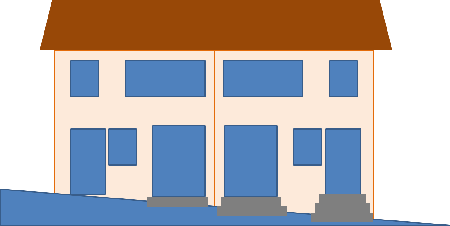

Hi Everyone!
I have scoured this thread for answers to my planning query - which is around from which point we measure the eaves height for our proposed single storey extension (flat roof). Our property is located on sloping ground, however it doesn't slope from "front to back" like most properties seem to when searching! The ground slopes downward from "left to right" as in the diagram below. This would be the view when looking at the property to the rear. We are located in the right hand property, our neighbour in the left.

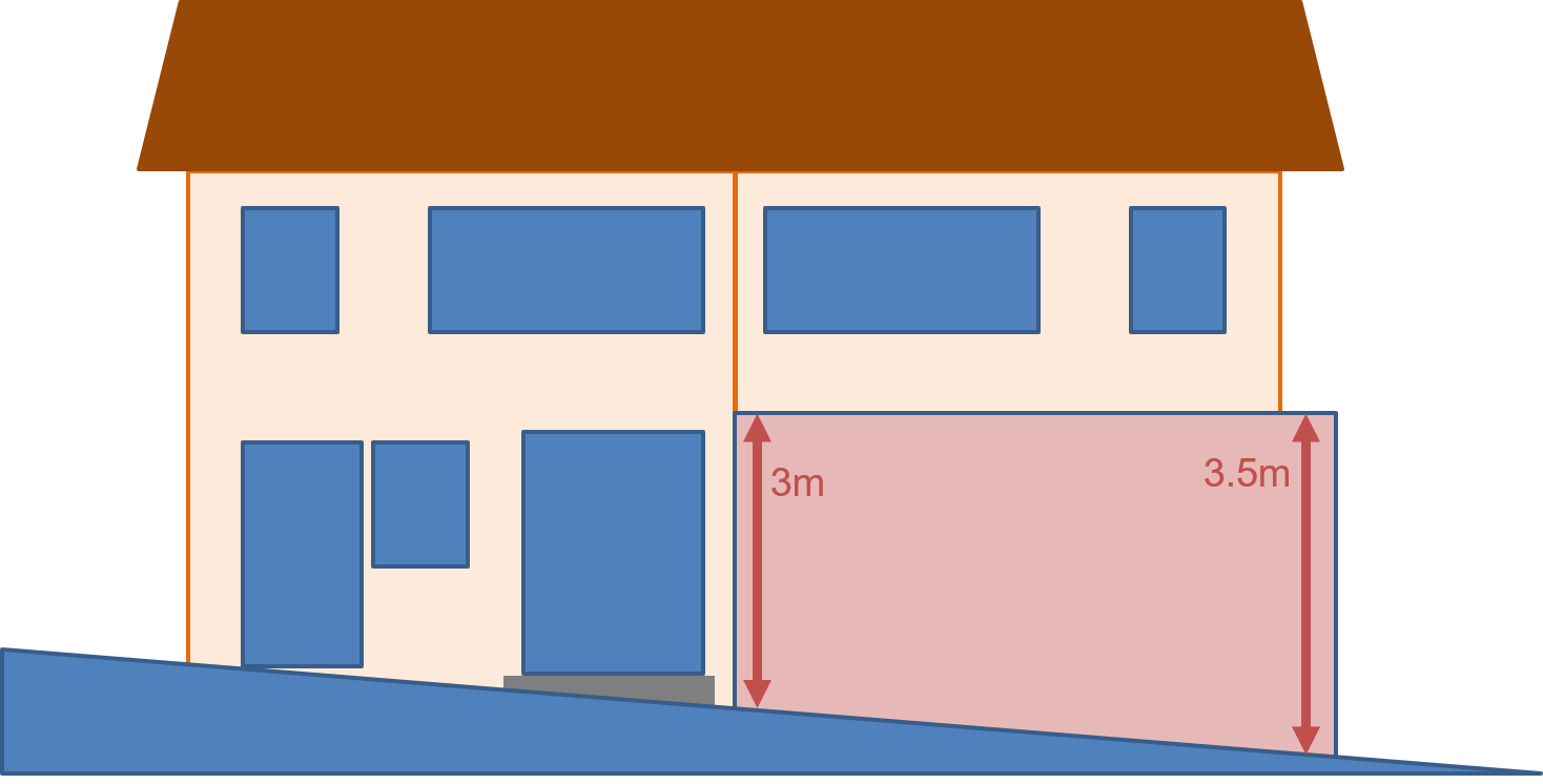

The issue we are having is from where can we take our maximum 3m eaves measurement when planning the extension - as in the second diagram? We hope for our application to fall under PD, however the planning dept at the local council invalidated the drawings my husband sent in as the eaves height (on the right of my naff drawing below) of 3.5m is too large. They seemed to completely overlook the sloping ground here?
I hope the diagrams I have included make sense (n). If we took the eaves height to be 3m at the right hand side, that would give us a height of 2.5m at the left of the extension in that diagram.

Highest ground level, next to the extension. There's loads of threads on this.
Dimension the eaves height on the side of the higher ground

Page 13 shows you how to measure the eaves for a sloping site.
In this link is the measurement shown for a double storey extension? Or is the principle the same in that the eaves height is governed by the highest point... again thanks, sorry if it's like spoon feeding...
Honestly planning this extension has been such an eye opener and learning curve!
It’s the same principle for both single/two storey extensions... outbuildings too.
