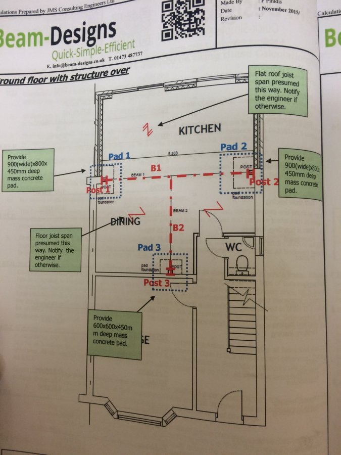

the extension will just be the standard 3m on building regs
iv had a plan and calcs done for the steels to make the back of the house open plan consisting of 2 posts and a beam to support the rear of the house and then bolted to that anopther beam and a post in the centre of the house to support the upstairs joists
now i wanted to do the footings and underpin what i can, then build shell for the extension, then break through, dig for the posts and then pour concrete for that and install the steels...can someone confirm that this is the correct order or should all concrete go in at once thus meaning the house will be in pieces at the back until shell is built to make watertight again?

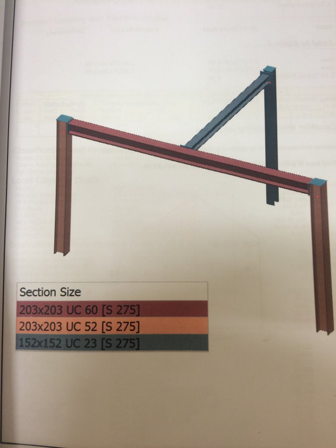

3 posts and 2 steels so a T suspended by 3 posts
The 2 main ones supporting back wall/roof to be sat on a foundation /pad 900x800x450 deep and the third on 600x600x450 pad
Do i dig and pour the pads then have the steels made to suit i take it?

No just single to rear not a wrap around
I cant support the upstairs joists off the internal wall as its only 100mm and is studded next to it so would have to create a corner for the support
The rsj would be resting right next to studding hence the reason a steel post is needed
The pads though
Are they literally 900x800x450 holes dug, filled with the correct spec concrete then the steels are measured up and resin bolted into the concrete or do i have to set steel feet into the pad stones that im creating and then bolt from the steel post to the steel foot?
Certainly looks like pad 3 and post 3 could be avoided if the nearby wall has a decent foundation.
You need to ensure your pads are the correct depth for the ground conditions, and set top of concrete to the correct level - probably the same as the strip foundations. Ideally you need a couple of sections drawn to ensure you set everything to the correct levels.
You don't cast the posts in - you should get the fabricator to weld on a base plate and resin fix some bolts into the ground. As there shouldn't be any moment or uplift on the bolts four M12 anchors with 100mm embedment and a suitable resin should be adequate, but ask your designer as they should specify.

@R.R; agree entirely regarding post 3; if the wall between the dining- and lounge is brick or block, there is absolutely no need for a steel post there - beam 3 could go direct onto the wall with a suitable padstone.
With regard to the other 2 columns - I was sceptical at first but, seeing the plan, presumably they've designed it for lateral stability as well as supporting the back wall.
I think that is just how the regs are
Post 3 has a stud wall right on the edge so cannot have padstone and would need underpinning
Architect said used to work to failure value of 4 or something but its 8 now so prob why it looks a lot beavier than usual??
Either way thats what the se says and what building control will be referring to and im not going to argue it

So within reason the pads can be varying heights and steels can compensate for height differences i take it
Yes, the pads can vary slightly, but try to keep them within an inch or so, as then you will be able to use a cementitious grout to bring up to level. Get the columns all cut the same length and use the grout to make up for any discrepancies.
