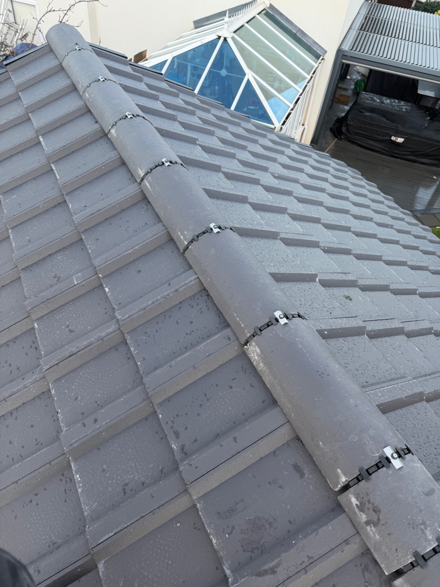

I'd been waiting for a clear and dry day to fit the dry ridge on the roof, as the first step is sticking a breathable (i think) membrane down over the ridge batten of the roof. You then lay your ridge tile, bang one of the plastic tile jointer and then once the second tile is in you screw down down the stainless steel fixing into the batten...being careful not to over tighten.
Well the day started out dry, but pretty much as soon as I laid the membrane down this happened:
Suppose I shouldn't have expected anything less in the winter!
Ridge tiles all on with the fixings. You can get some dry ridges with plastic fixings between the ridge tiles, but the stainless steel I think is a bit better given that it'll be exposed:

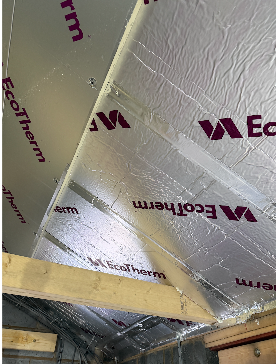

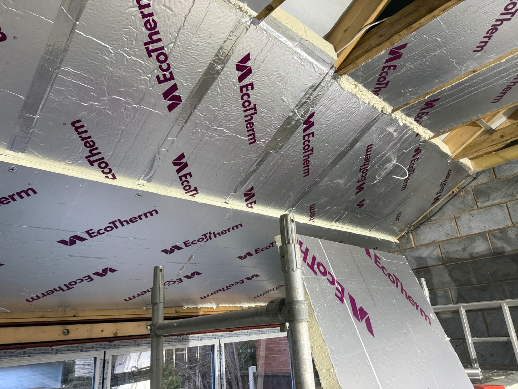

Moving onto the inside, I started to fit the 100mm insulation between the rafters.
This was a pig of a job as I measured and fitted the rafters rather than being (in hindsight) sensible and using a bit of wood or something to exactly fix the width of the rafters all the way along. This mean that my spacings were all different top to bottom (unusually by +/-5mm, but enough that every bloody piece of PIR had to be cut to the space and then shaved/wrestled/bashed into place. Also I was too casual about the angles at the top, meaning extra foam was needed in places.
You live and learn!
50mm PIR then goes over the top at a 90 degree angle and it all gets foamed and taped as you go to fill in the little gaps.

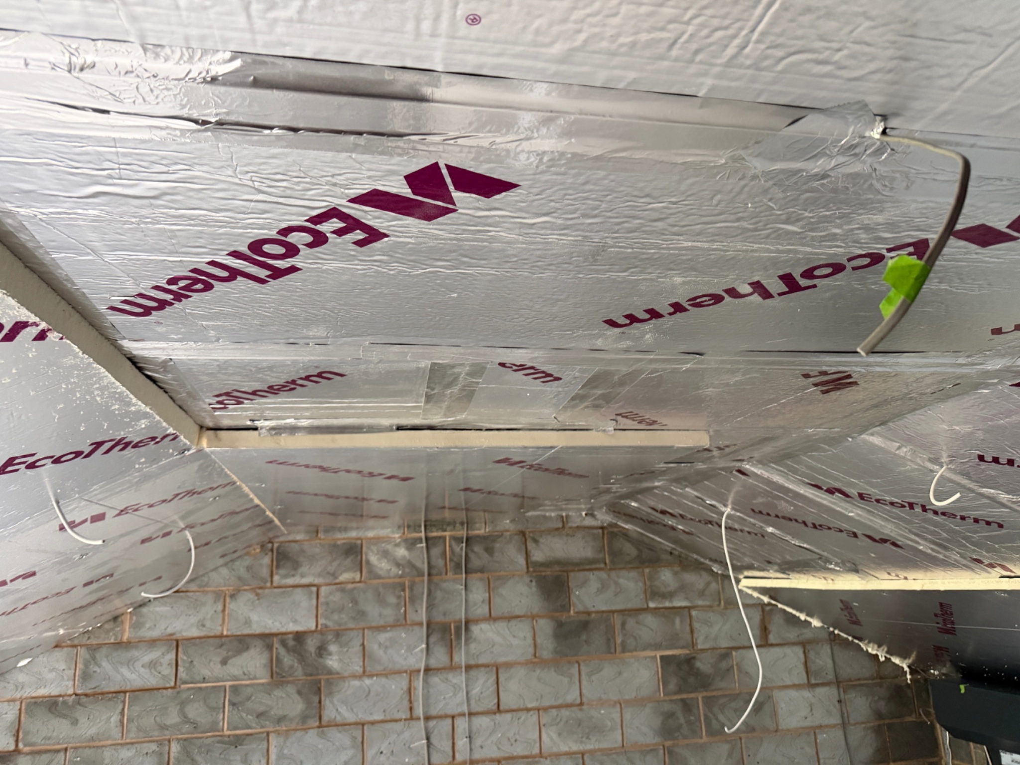

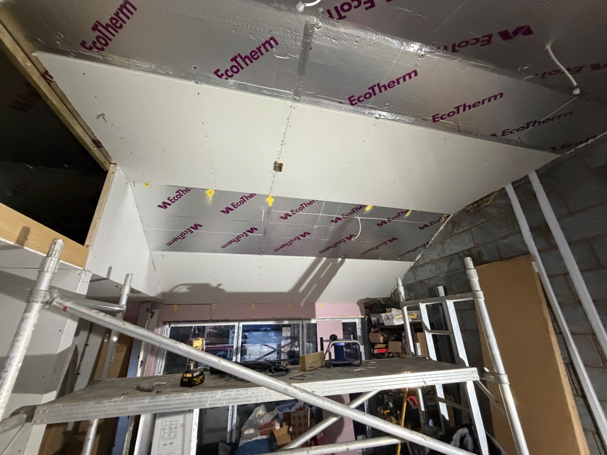

I've deviated from my plans a bit as the original plans just had an inverted V shaped vaulted ceiling, but I wanted somewhere to run wires, and also to avoid faffing with boxing in the RSJ, so I used a load of left over timber to add a flat panel to the roof.
I am also having a small kitchen area so planned to have a small internal stud wall to break up the space. On top of this area I also wanted some general storage, and therefore although I insulated all the ceiling like its vaulted, approx 1/3 of the space will have a regular ceiling at 2.4m with a bit of storage above.
In order to accomodate the ceiling, I had to cut back into my newly fitted insulation to allow the joists to sit on the wall plate. I figured it would be easier to get the insulation in place, cut out a slot to the wall plate, then fit the wood...rather than trying to work around a pre-fitted ceiling.

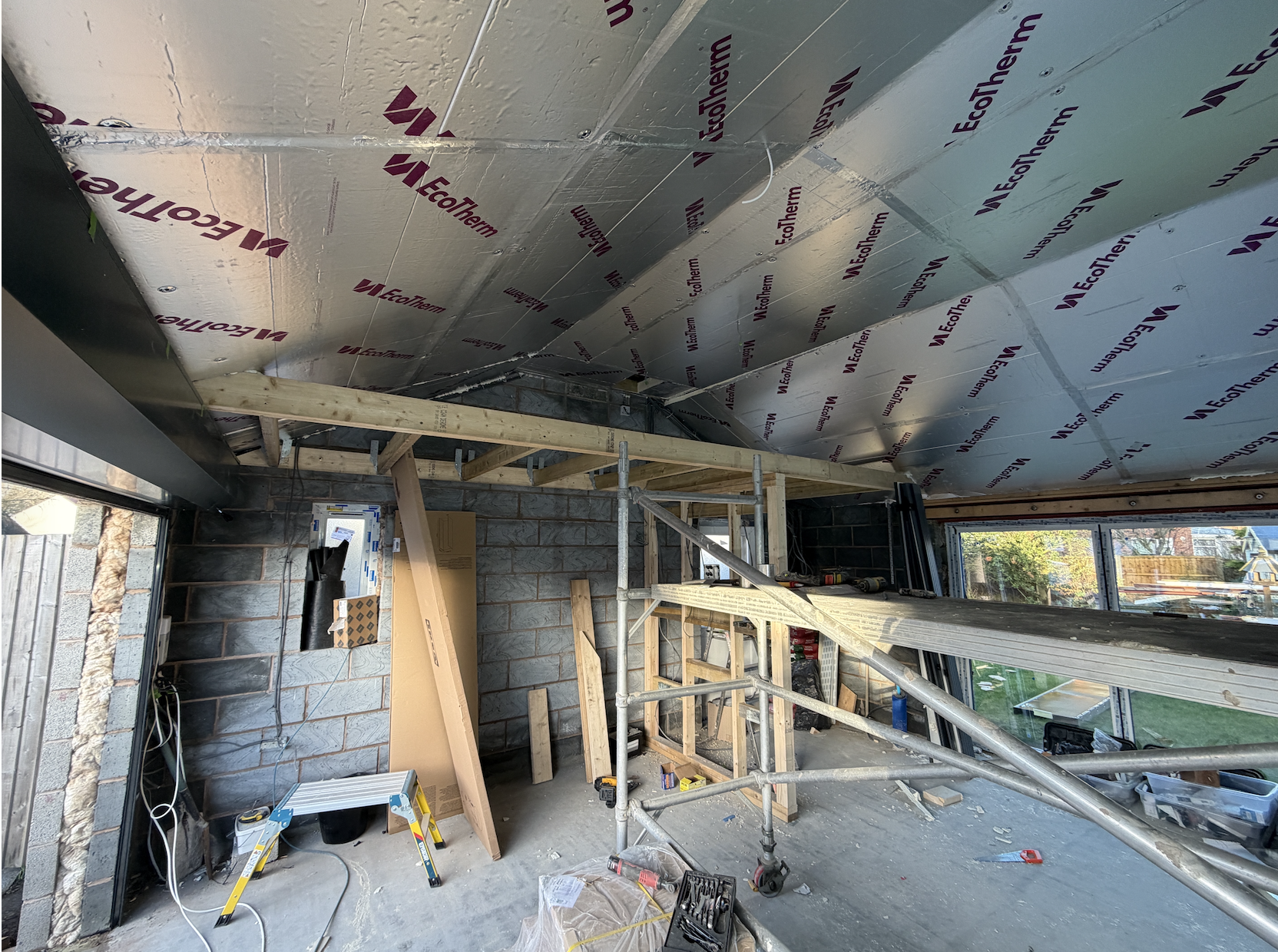

I've got two 6 x 2s which will be coach bolted together (wasn't done in the picture below) that run from wall plate to wall plate. I have one of the 6x2s cut so 50mm of each sit on the 4x2 stud wall (with the other side on the wall plate) and then one 6x2 that runs over the longer span and entirely over the stud wall, with a shorted bit just on to the other wall plate. Once bolted together I think this should be fairly strong - I've not had any calcs done for this bit, as it's just for a bit of storage - the height above is limited, so it;s not like I'll be walking around up there!
The other side has a ledger plate wish is through-bolted into the wall, with the 5x2 joists on hangers running at 90 degrees. I used 5x2 here as I had a load spare from my decking, and once i stick loft boards on top it'll be about the same height as the 6x2s on the perimeter.
Some of you may be wondering why I went with the joists running parallel, rather than just more joists from side to side. That was because at either end there was some noggins in the roof that held the wall straps in place. (You can see one taped over on the image above. These straps were only about 100mm off the wall plate height, so I wouldn't have been able to fit deep enough joists for the span on the wider side (about 3.5m), so I needed to fit the wood in a way that didn't interfere with those straps.
It's kind of hidden in the picture below by the scaffold, but I've tactically put noggins in the stud wall for sockets, and where the wall cabinets and radiator will go, so give me some decent fixing spots.

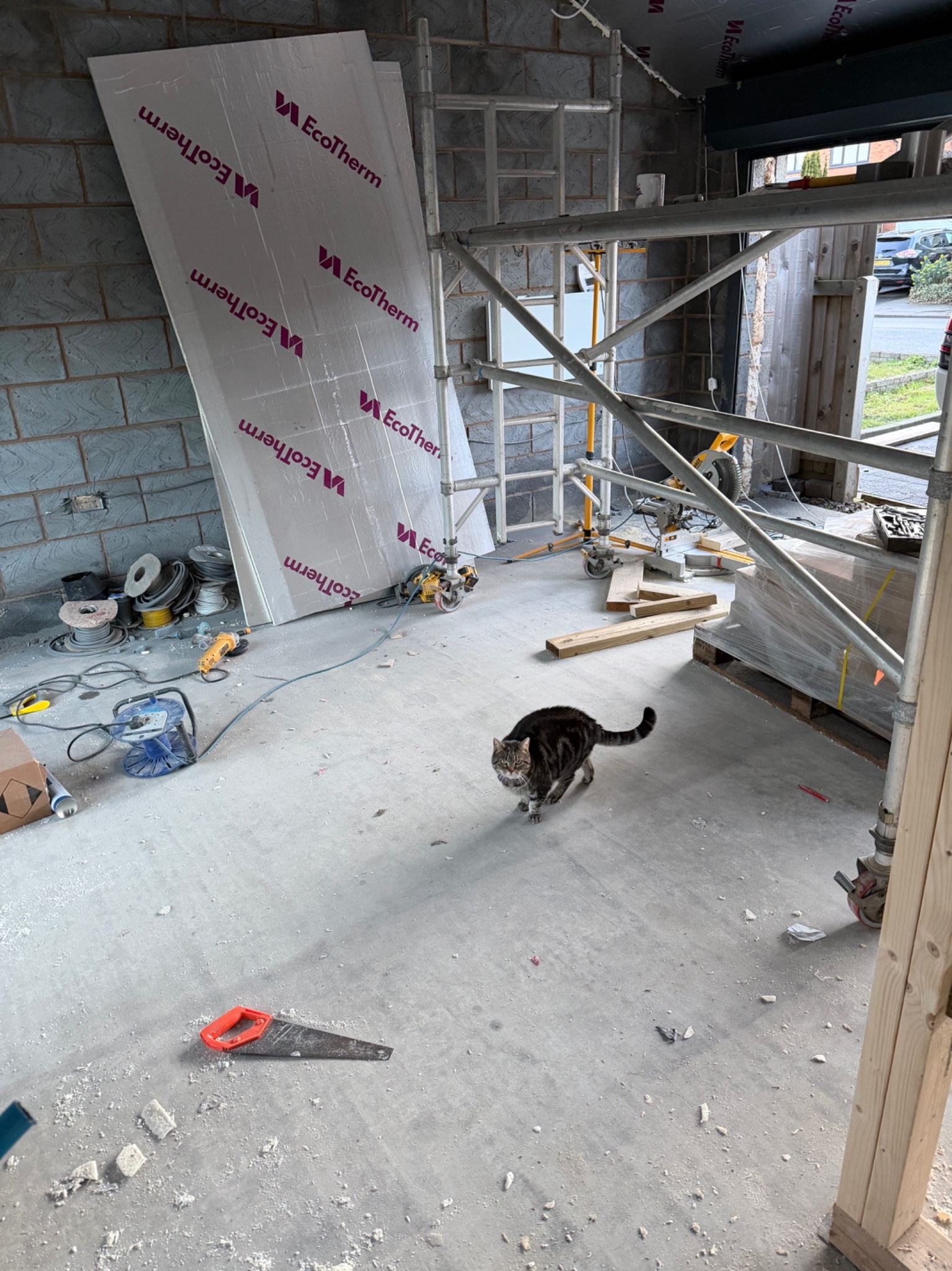

Getting closer to being finished now, and Milka approves of the new space!

Only thing I'd have done differently on the ridge is cut more tiles down to get rid of the need for the short piece near the end of the run (eg if there was 45 inches left to go, and ridge tiles were 18 inches, I wouldn't have 18, 18, 9.. I'd cut eg 3 inches off 3 tiles and have a 15, 15, 15) but I sure wish the roofers my FIL had employed had taken the same care you did with his ridge, save me having to climb up there with new tiles and re-align the screws so they actually went into the timber
Just goes to show how getting a quality result can be down to care and thought as much as experience, and how DIY jobs can be as good as trade when a homeowner is more invested

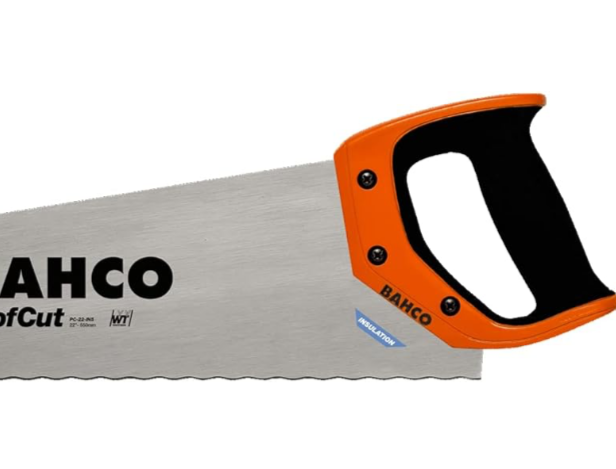

Oh, and a btw - youre probably mostly done with insulating now but you can get dedicated insulation saws that are toothless and make nearly no dust:
Thanks, yeah I learnt my lesson from the extension when it came to the ridge tiles, but thankfully it was only about an inch to be cut off the final tile, so I just did it because it was barely visible from the floor.
Good shout about the saw - my mate had mentioned there were similar jigsaw blades available, but it was already too late for me. I has a couple of weekends looking like a snowman :D

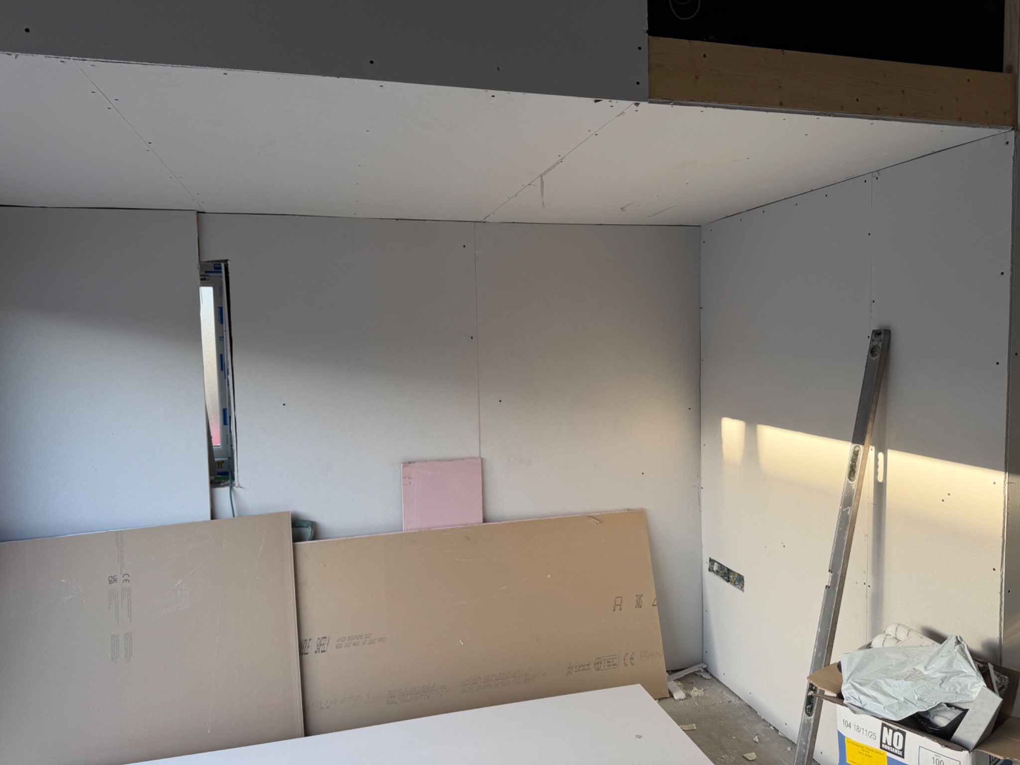

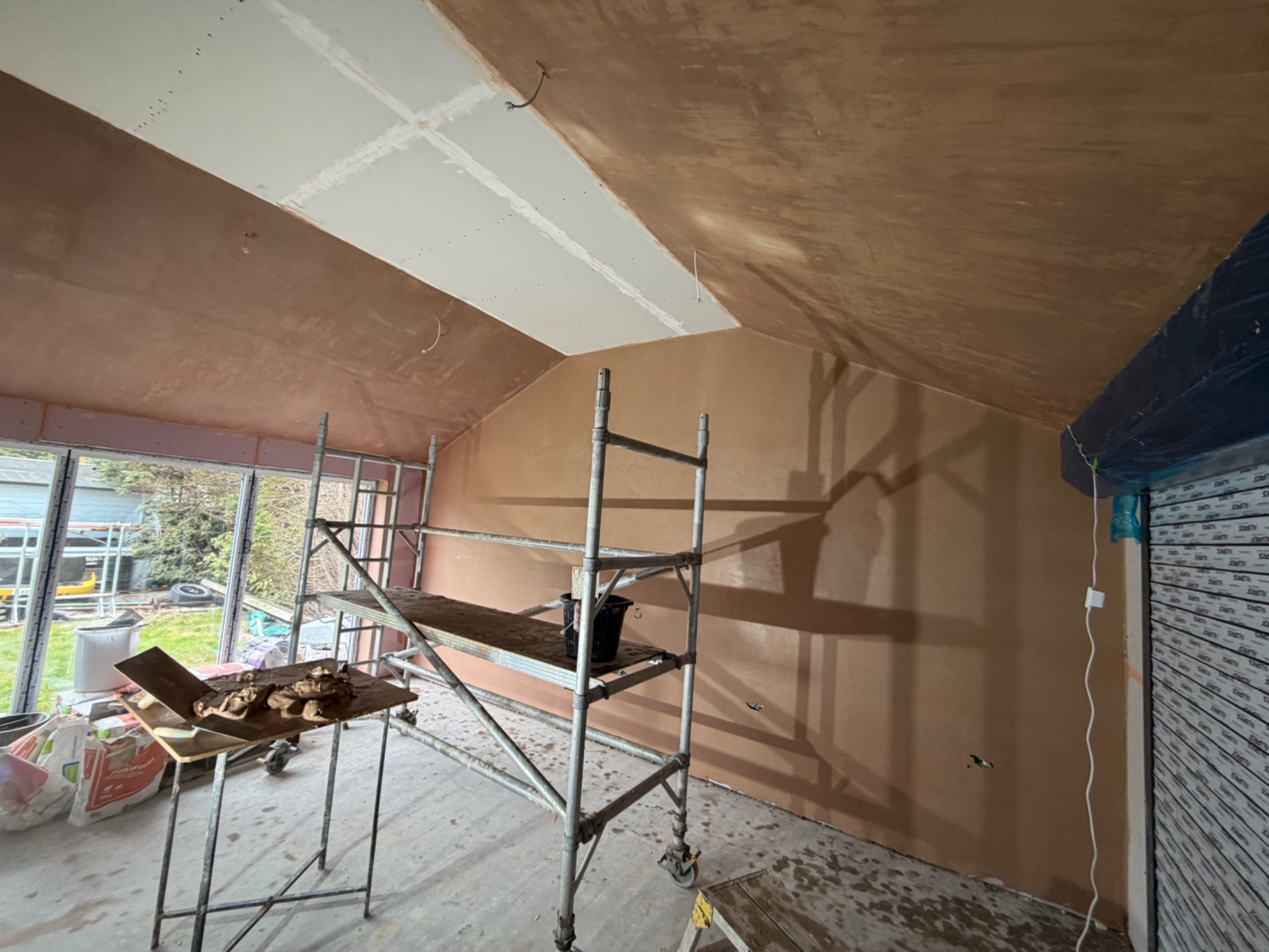

I ran all the wiring for the first fix electrics quite a bit earlier in the build, so that meant I could get straight on with fixing the plasterboard.
Due to all the insulation I had to use 100mm plasterboard screws and have a bit of guesswork to get the PB on the vaulted ceilings because I’d not precisely measured all the roof joists to make them uniform. I used the 8 x 4 sheets of plasterboard, but the 9.5mm ones as I find them much easier to lift and fit - especially as I usually had to hold them in place on my own while Clare screwed them in!
On the walls, I’d learned from my experiences in the extension build and avoided the PB adhesive which you mix up and just used the spray on expanding PB adhesive - it’s more expensive but sooo much easier to use. I also stuck in some token PB screws where needed to get the boards aligned where needed as they screw straight into the thermalites with no bother.

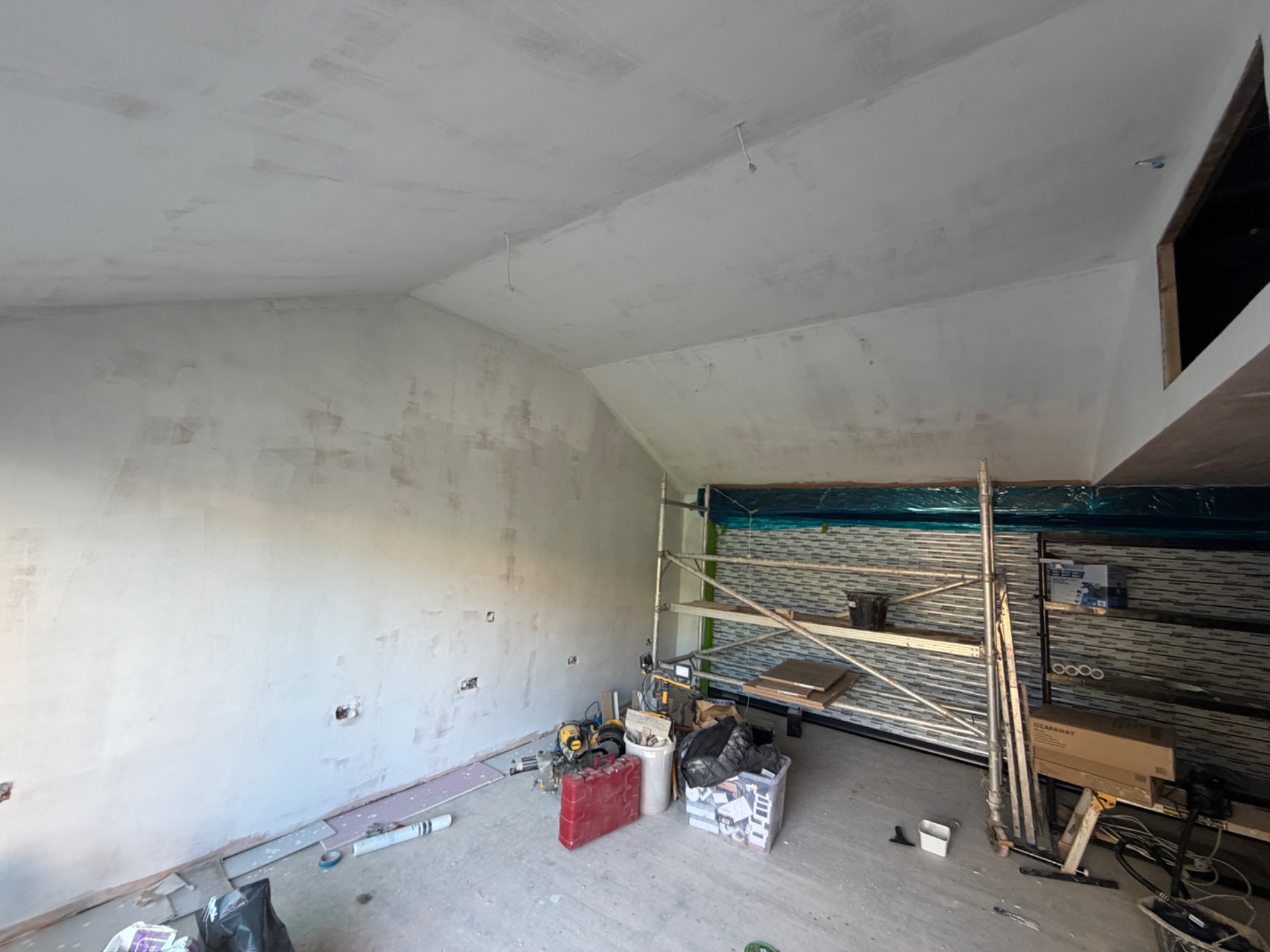

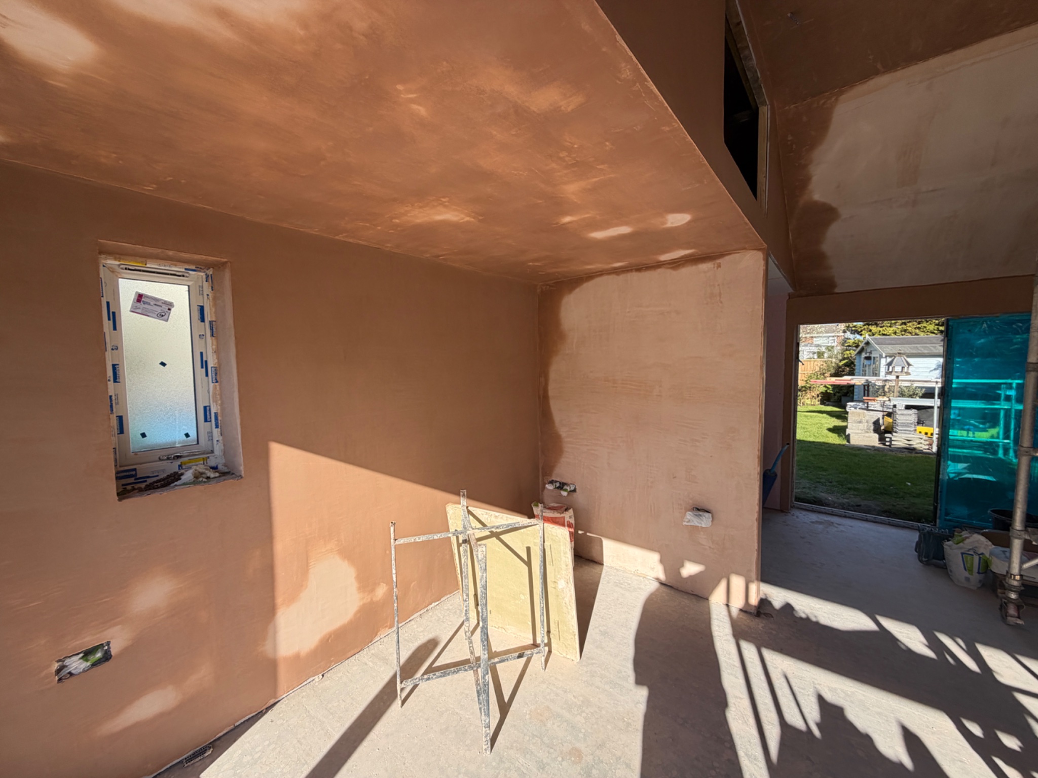

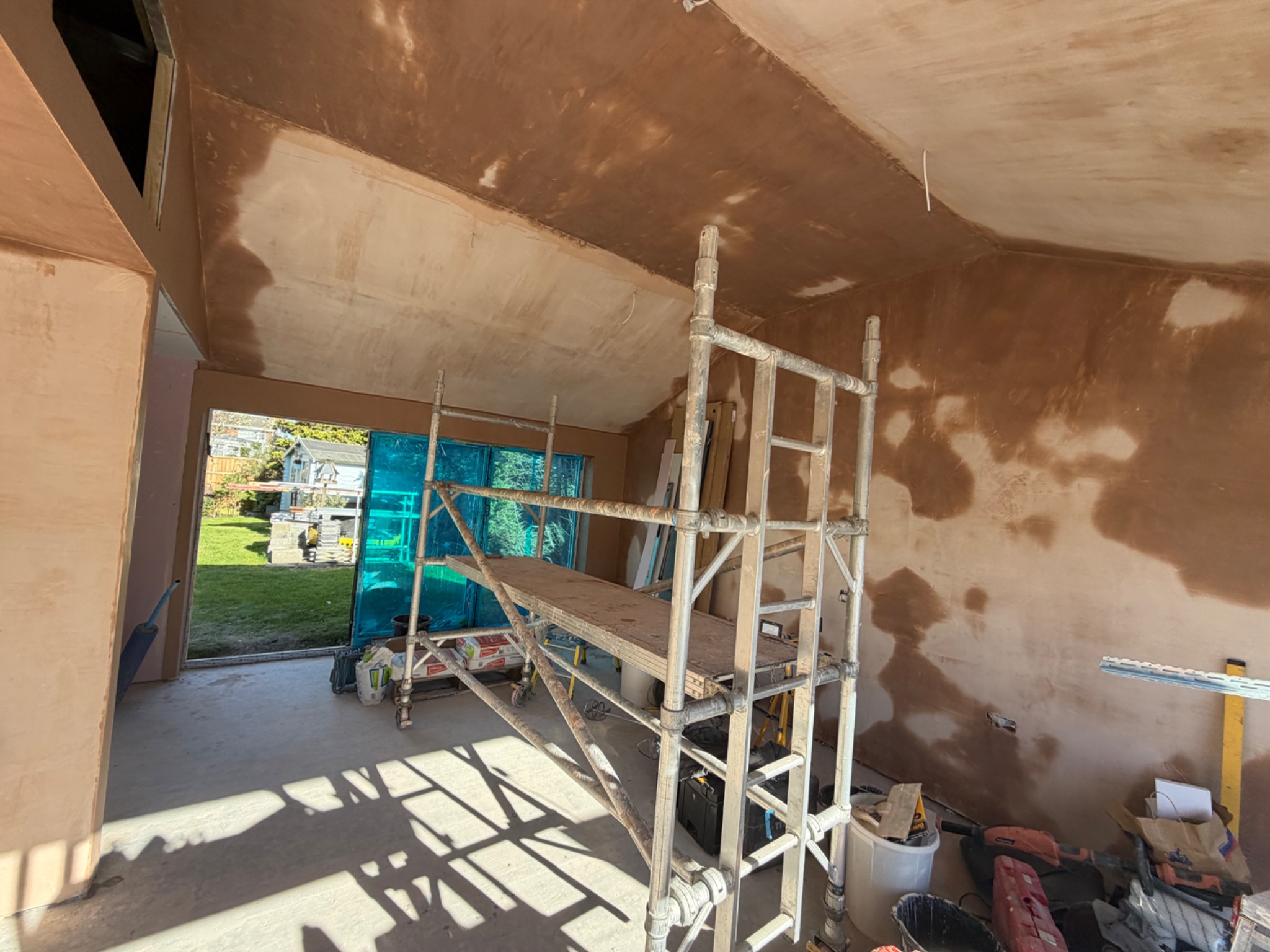

Then I was able to get on with the bits I actually really enjoy with the building - getting the plastering done - because it starts to feel like you’re on the home straight!
Plastering went all fine, although a bit later on a few screws I’d done in the vaulted ceilings popped out…which was a bit annoying but my fault for not screwing them in fully!
I really do rate my 900mm speedskim with the stainless steel blade - it really does help me as an amateur plaster getting the finish to be decently smooth without too much filling and sanding later.
Mist coat on:

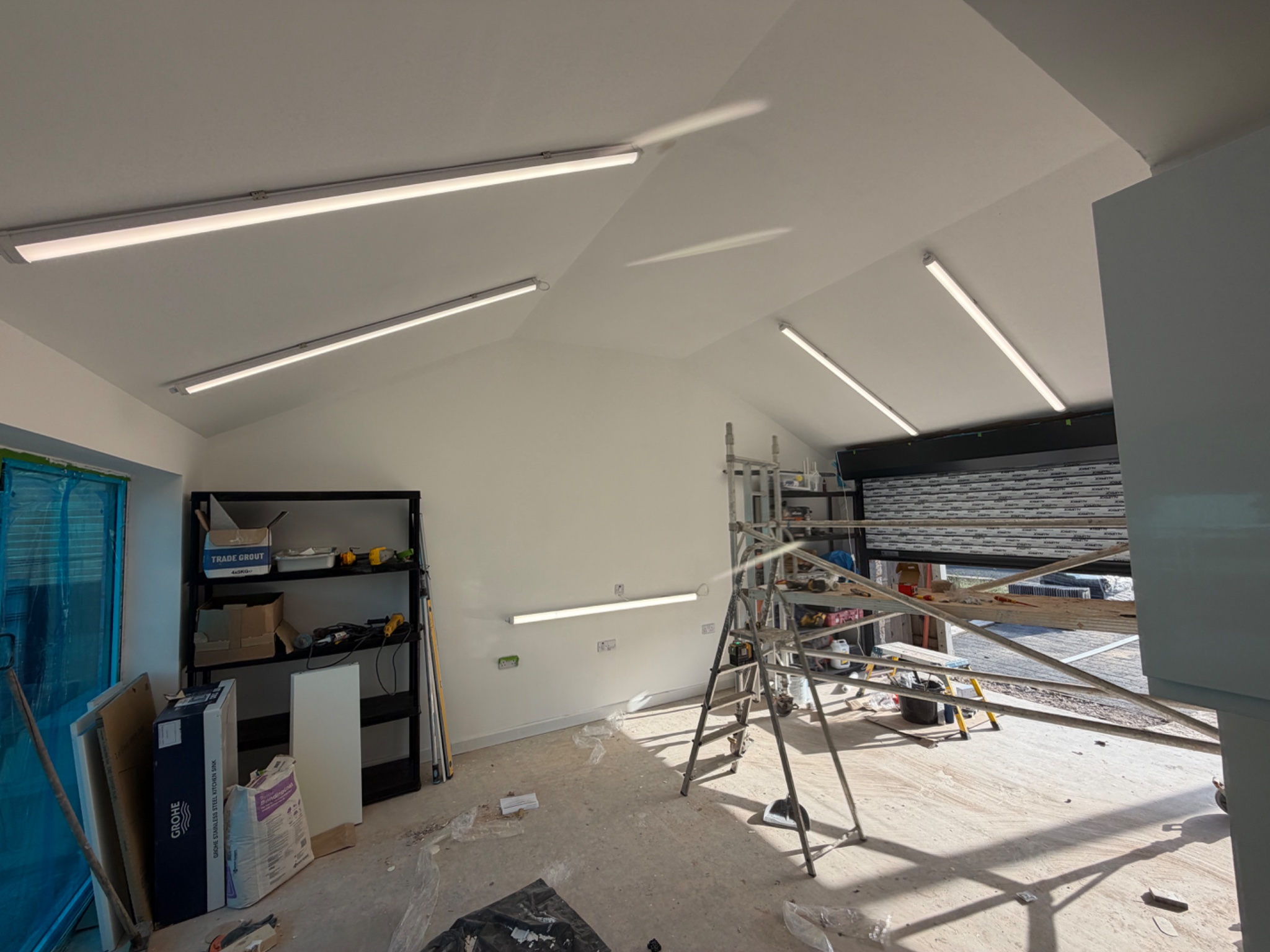

Had the electrician in to connect up the fuse box in the garage and back to the connection in the house…it was all good with my connections/wiring/etc.
Walls painted, lighting working :)

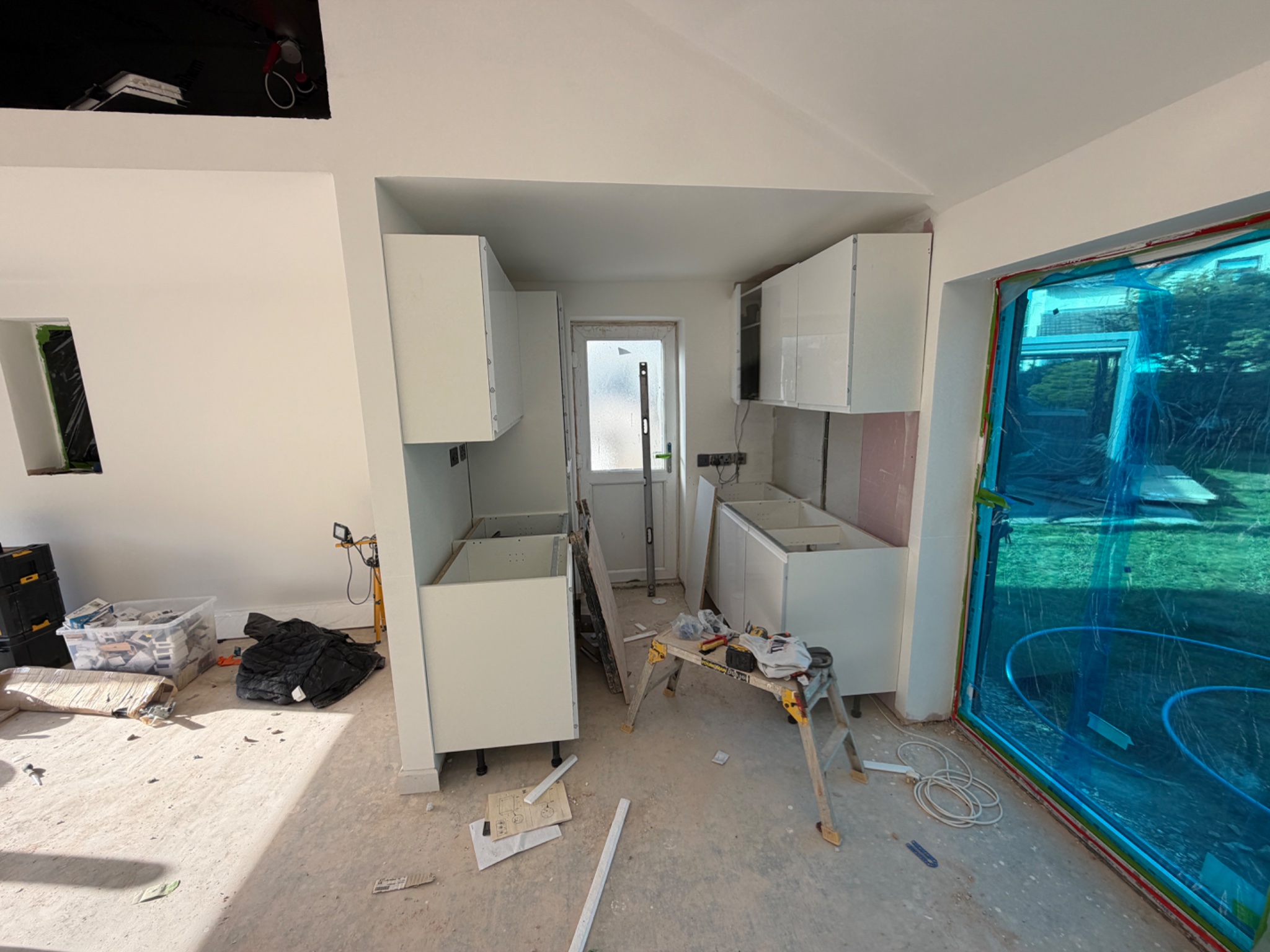

Kitchen units going in too…so all coming together!
As it’s been a while, trying to remember the costs spent…might be out a bit. Plasterboard, plaster, adhesive, beads, etc £850. Electrical stuff and pro to connect it all £1200. Kitchen units, doors, etc £600. Total garage spend to date £36.5k ish and total overall spend £155.5k.

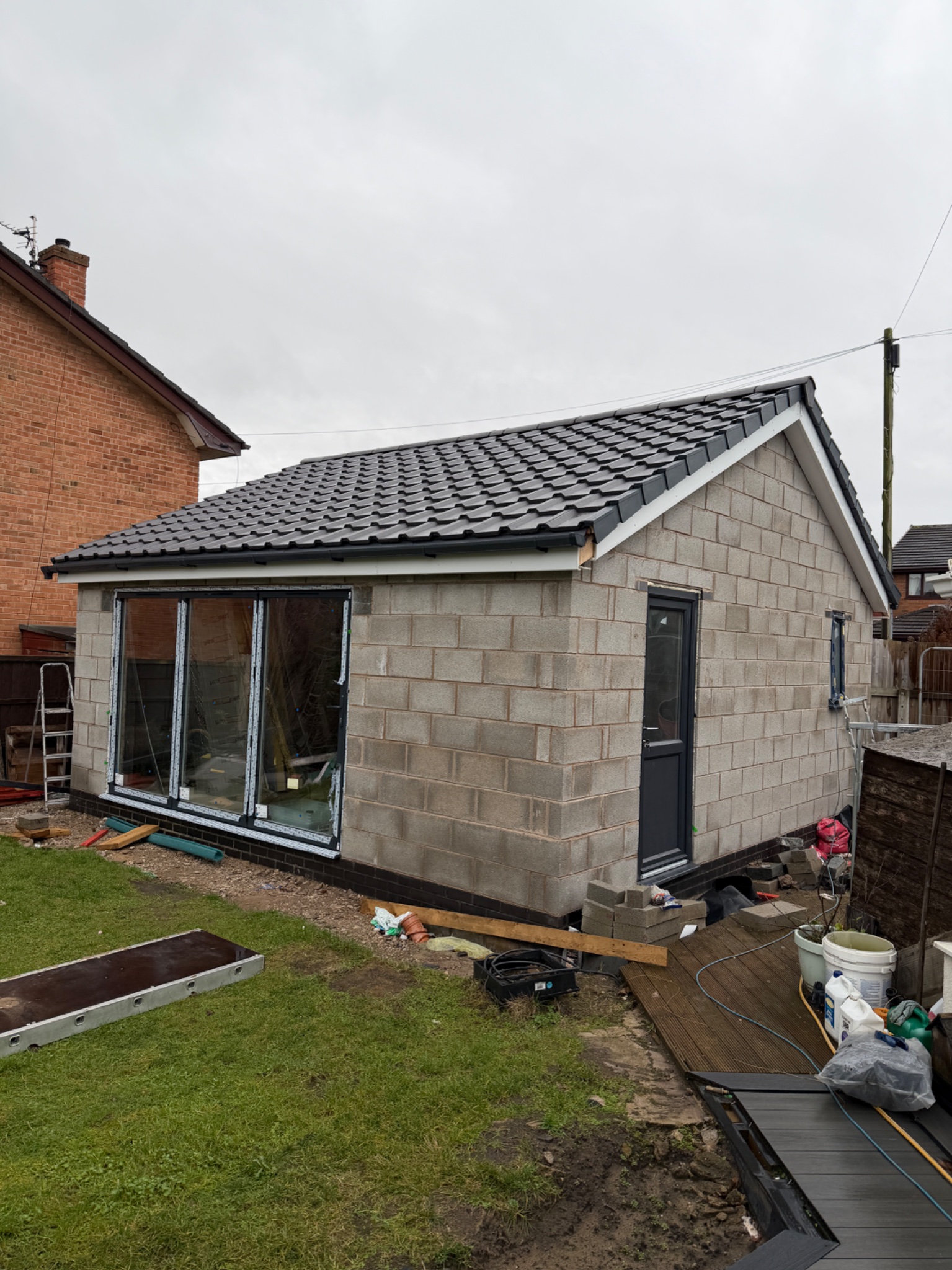

Can’t remember if I posted this before, but view from the garden of the completed building (bar rendering).
