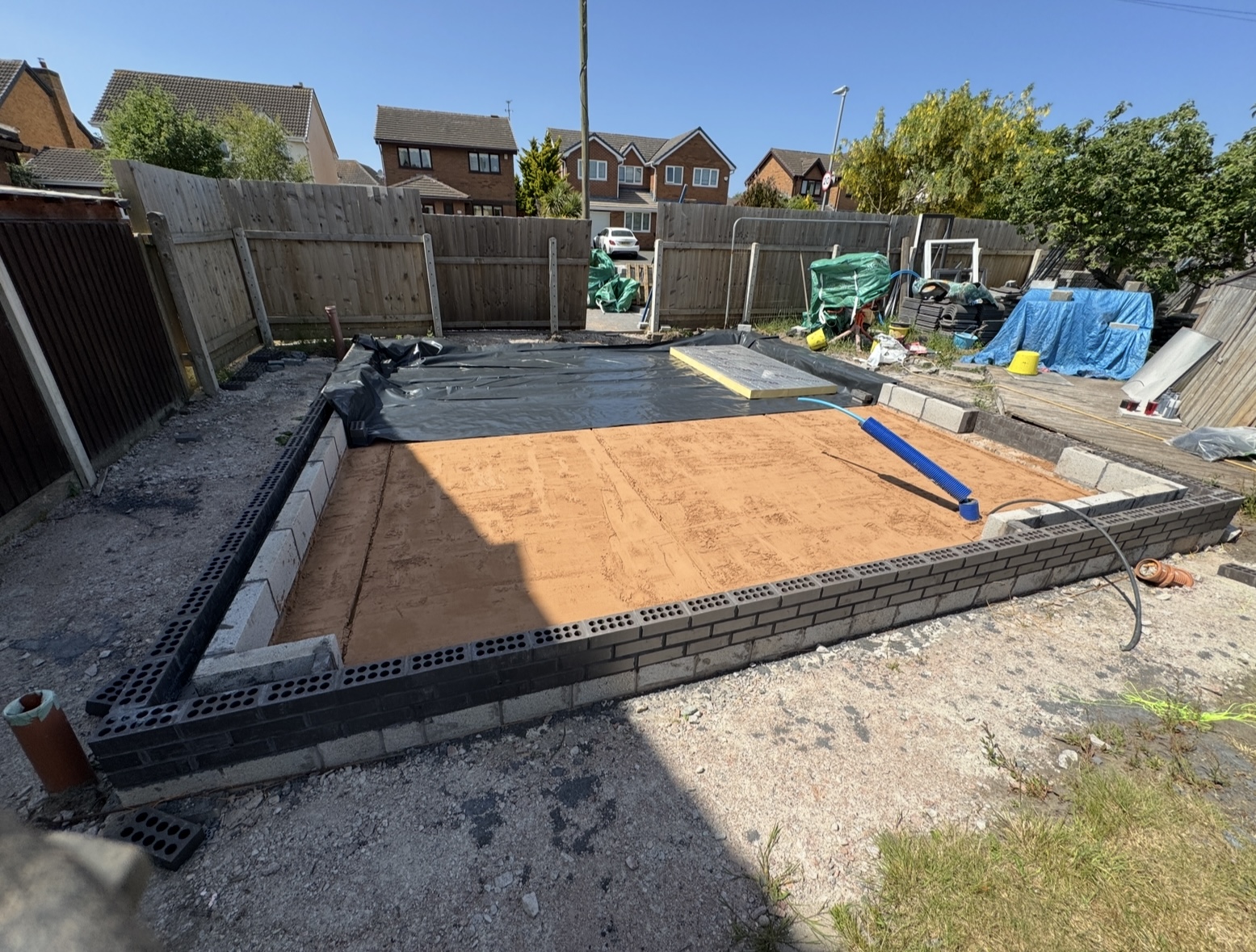

100mm of MoT1 was put into the inside of the extension, which was then whacked to within an inch of it life.
Around 25mm of blinding sand went in top of that to protect the damp proof membrane from the sharp hardcore. In reality it’s more than 25mm of sand in places, but you need it pretty level to support the insulation evenly.
I use metal conduit pipe and my screed level to get it flat. Milka the cat didn’t appreciate my attempts to level, so did her own efforts :)

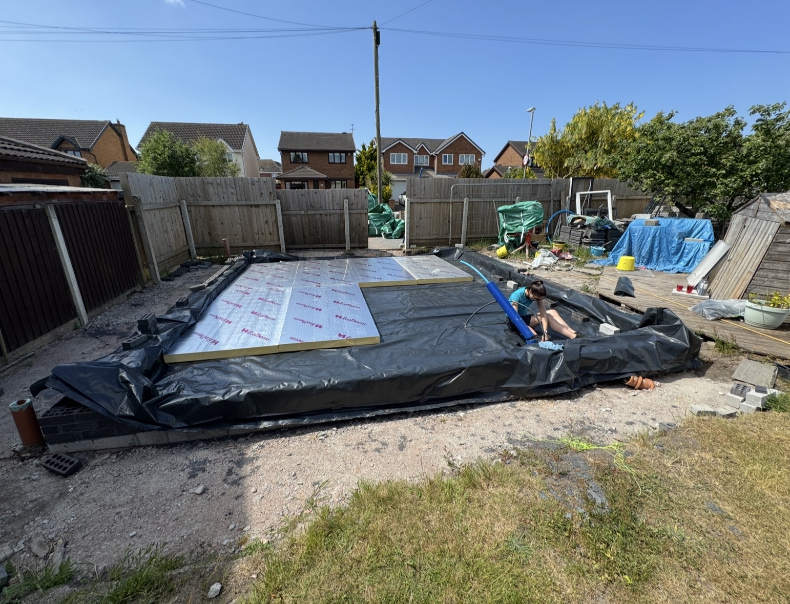

DPM starting to get laid. Shot of my brickwork too. The foundation blocks and first layer of bricks will be underground once the garden is reinstated.
100mm PIR boards going in. Clare doing a good job of taping up the holes in the DPM where the pipe and cable went through.

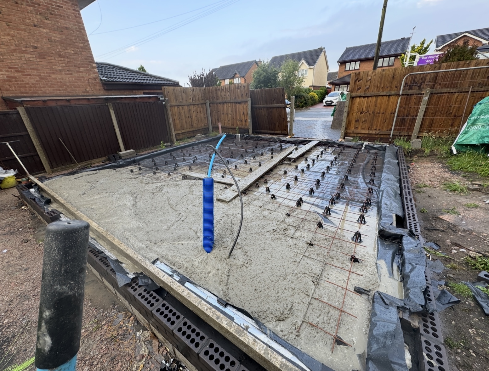

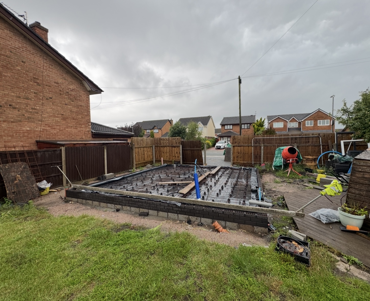

I had the rebar in and then building control come out to check everything before concrete. They wanted an extra layer of DPM on top of the insulation, which wasn’t on my plans…but BC get what BC ask for, so I had to cut all the tied rebar, take it all out and then put another DPM layer down, before putting the rebar back in.
Managed to put a bad gash in my leg scraping it on the rebar when that was done too, which added injury to insult!

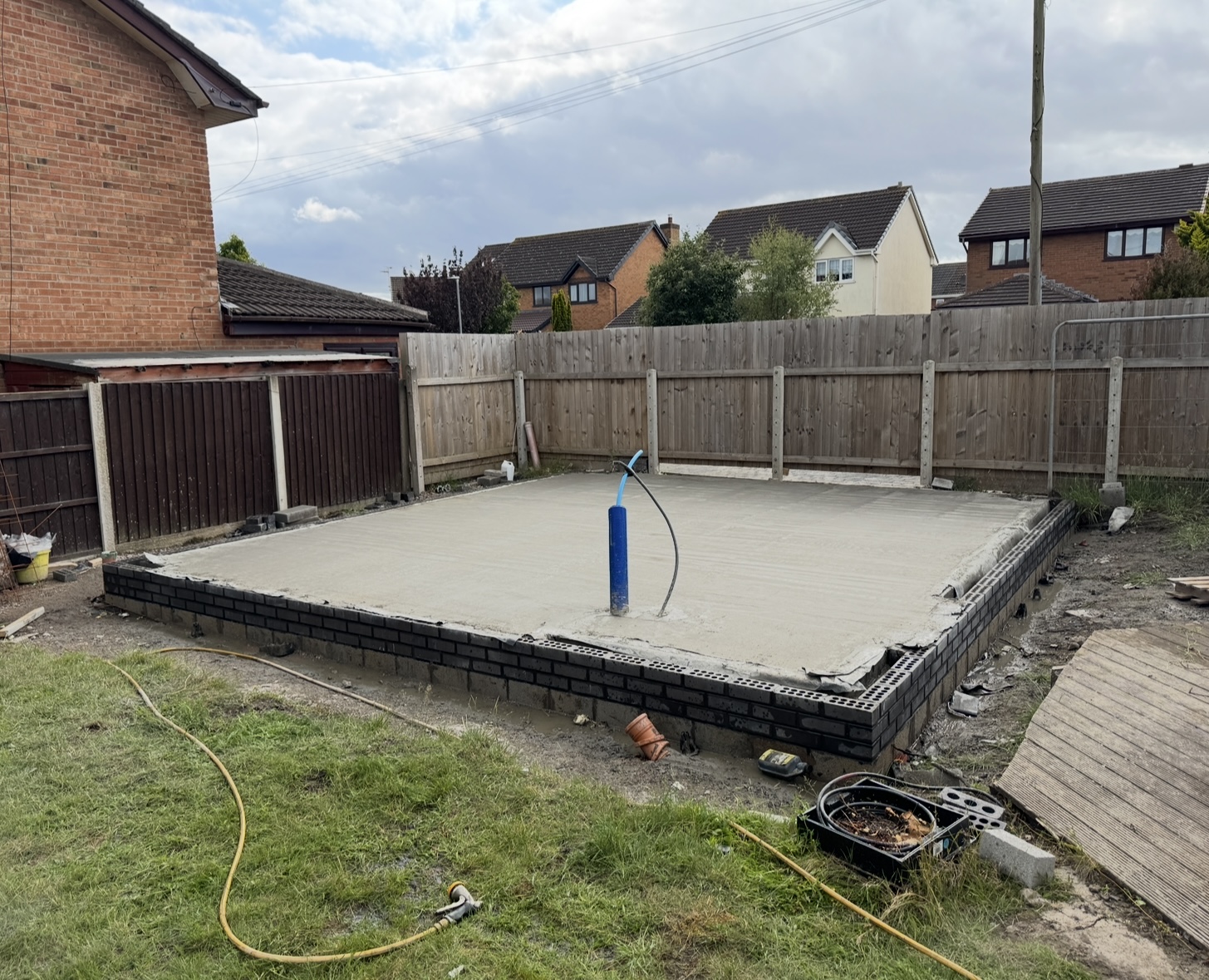

However, finally the rebar was back in and tied, with 75mm spacers under the rebar (as I was having 150mm of concrete).
I hired a 7m tamp and an easy float to make the levelling of the concrete easier - you can see the tamp poised for action in the foreground…and a few scaffolding boards to help the barrow man.
Concrete staring to go in. There was only one guy on the wagon, so he barrowed 6.7 m3 of concrete in 90 mins on his own…the guy was a machine!
It had rained cats and dogs throughout the night beforehand, and that why you can see a lot of water on the on the DPM.
Didn’t get any pictures of the tamping or the easy floating unfortunately. Had a mate come over to help, along with Clare, which was handy for using the heavy tamp.
I didn’t get the smoothing perfect, but good enough for a garage floor.

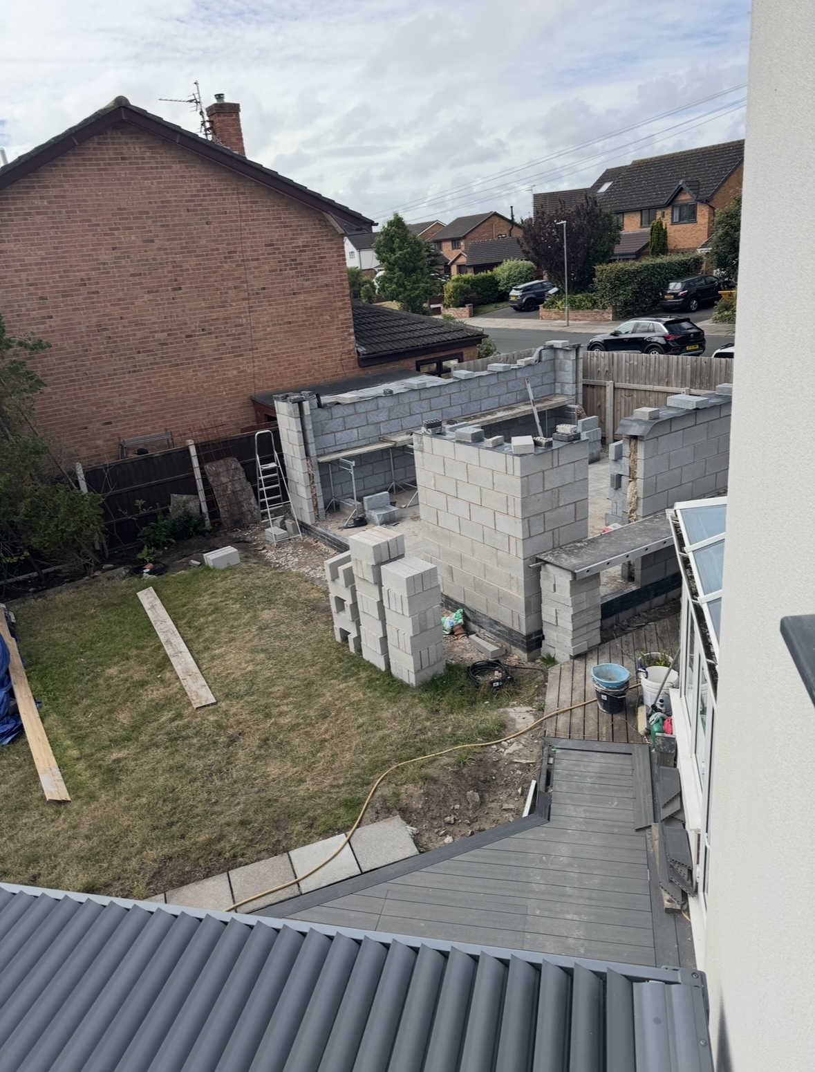

So onward with the block laying, have had tons of pallets of blocks delivered.

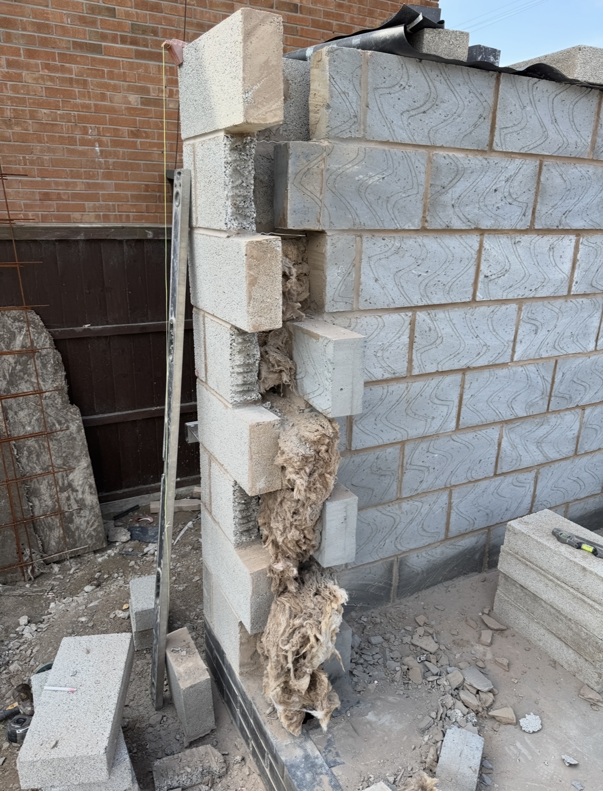

I’ve gone for plasmor fibolite 7nm blocks for the exterior and thermolite 3.5nm blocks for the inside. I used the plasmors for my extension, and I like them as you can lift and lay with one hand. The 7mn isn’t needed for the build, but will take the render better at the end of the process.
Setting out before getting started:
I was able to get a course laid each day, with all the cuts and faffing.
Weather wasn’t playing ball so I had to stop and start a bit.
I didn’t think I’d need a scaffold for this build but I bought a couple of staging boards to help with working at height. Forgive the blocks holding it up; I don’t have space for a trestle on that end.
Even more sketchy:
I did make a boo-boo as I decided to go against my plans and shorten one corner to give more space on the other size, but then I was reading up on minimum returns being 665mm and I was at 610mm. I might have got away with it, but I want things done correctly so (after 8 courses) I decided to to take it down and do it right. Waste of a day, but hey ho.
I post my mistakes so that others can learn from them.
As it’s stands, currently nearly finished the 9th course so pad stones are going in and steels are on order. Still going….

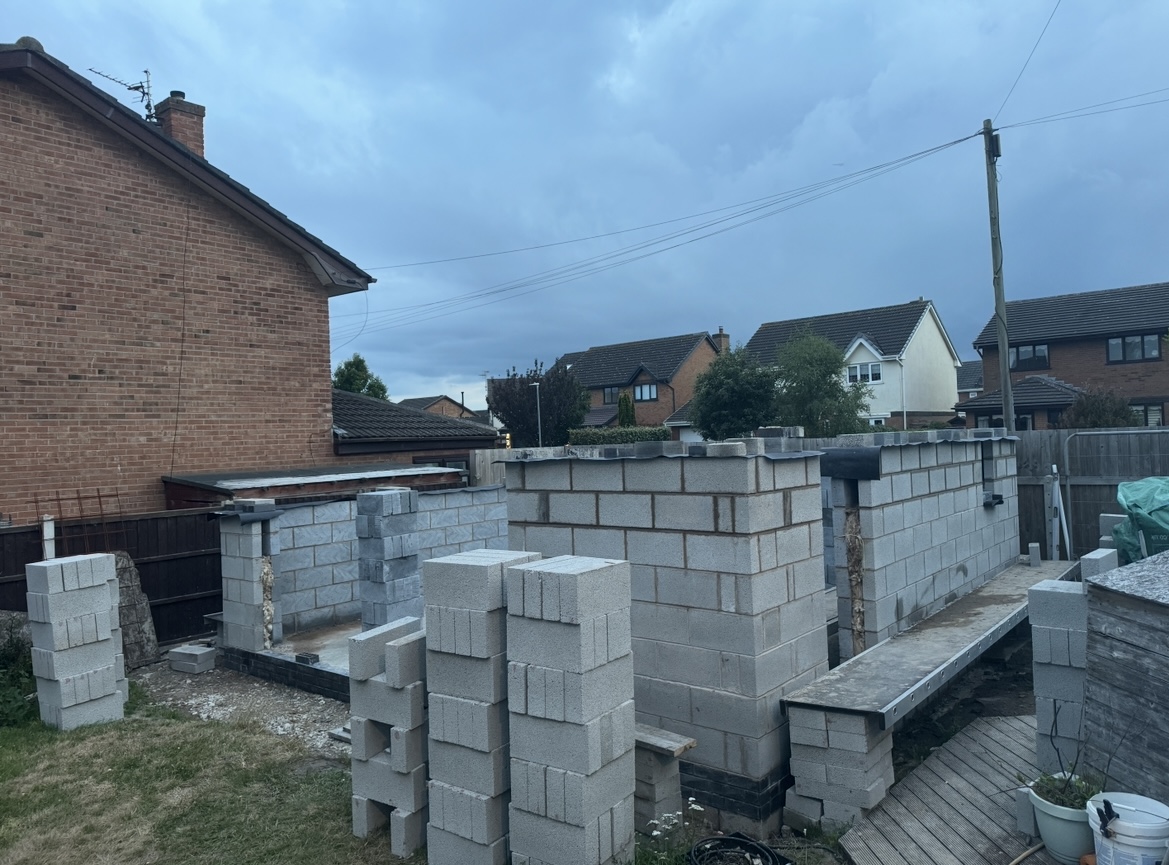

Wow, the time seems to be flying by again! 6 weeks on and time for another update. Summer has been busy with holidays, friends visiting and other social things so to be honest I've not made a huge amount of progress...but to be honest (again) after the extension build which ate up a lot of my time, I'm happy this time around with the work/life/DIY balance.
I got the walls built up to the top of the gable and installed padstones wherever there was going to be a steel. Had a little helper come join me on my scaffold who got up there with some mission impossible style skills.

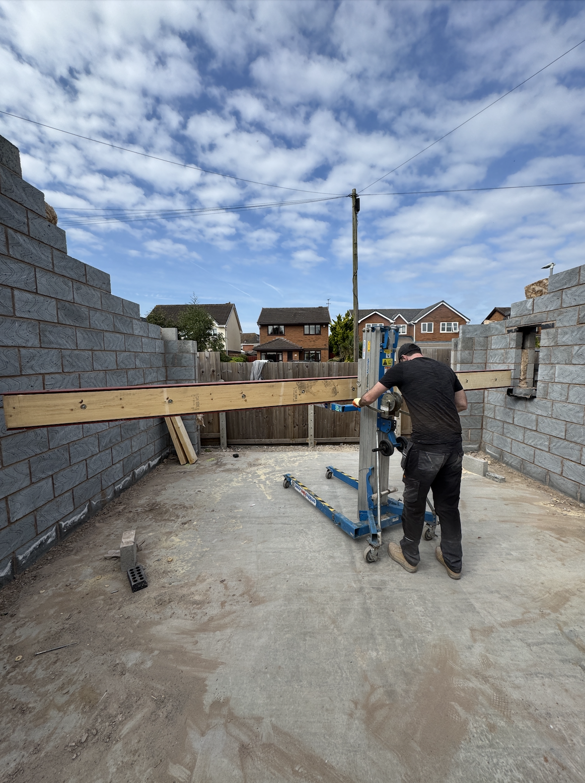

I hired a genie lift and roped in a mate (thanks Wayne) to get the steels into place. Not sure which was the heaviest steel. The front and rear ones have a steel plate to hold brickwork, which the centre beam has 9 x 3s in the web on either side which adds to the weight.
There's always a bit of jiggery-pokery when fitting steels to get them all level and centred, especially the ridge beam which is longer than the room its going into (and very high up) so pivoting the steel while up high is nerve-wracking but we got there in the end with all three beams in place.

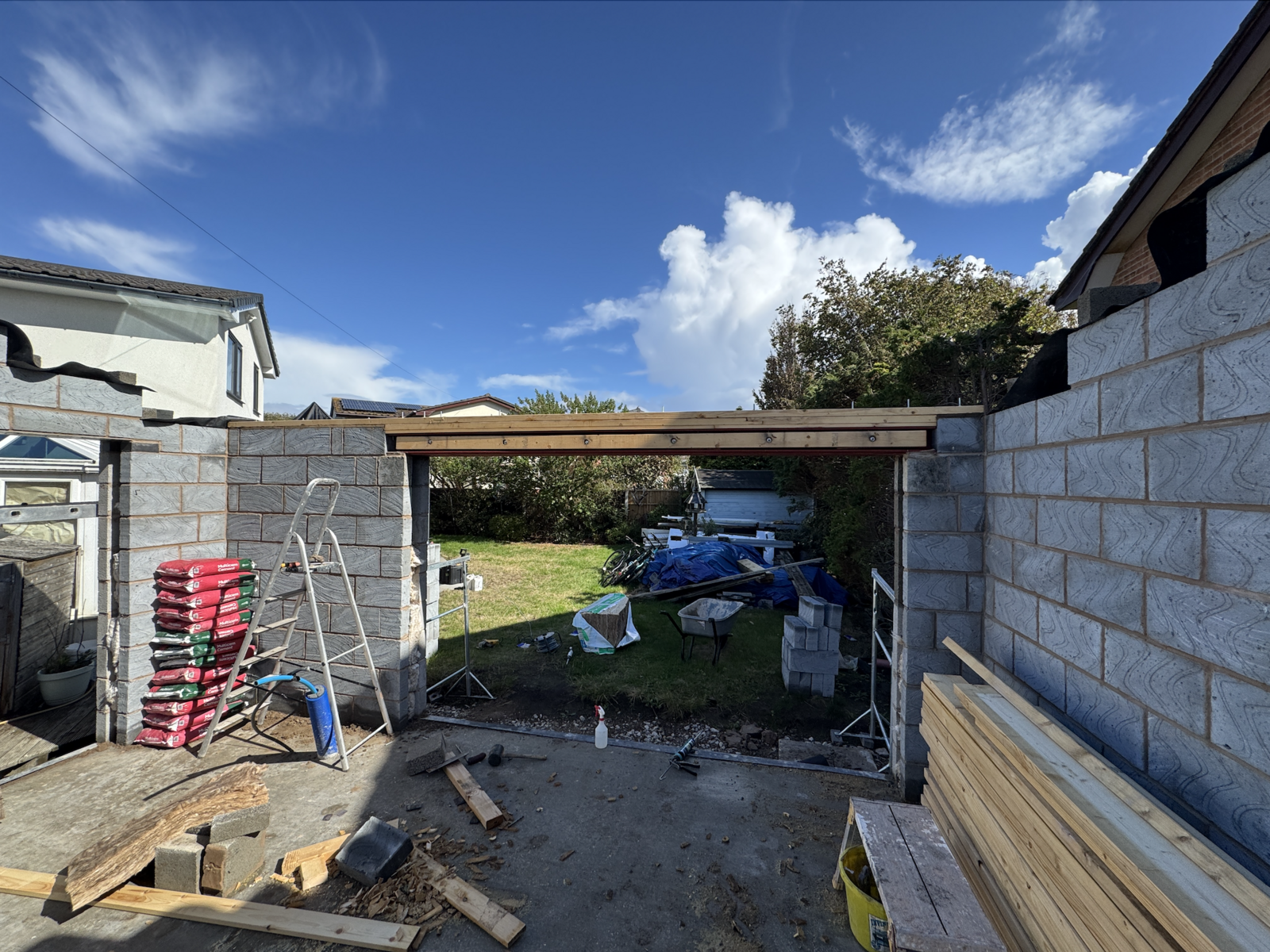

You can see in the above, the gable walls aren't yet fully built. That's on purpose as you have to put noggins through the roof rafters to the outside to support the roof elements that stick out beyond the wall - think there's called gable ladders. As I will be making my roof (rather than buying trusses), I didn't know where those would sit exactly. Therefore it's better to keep the walls lowish, and then fill in the block work later ones the gable ladders are in place.
I then had to install wall plates on either opening. Not sure if I've done this right as I needed to pack up to get to the block hight from the beam so I've used a couple of bits of wood here as I couldn't find any 4 x 3 timber which would have been the perfect height (so 4x2 and 4x1 it was). Will see if BC say anything when they come round.

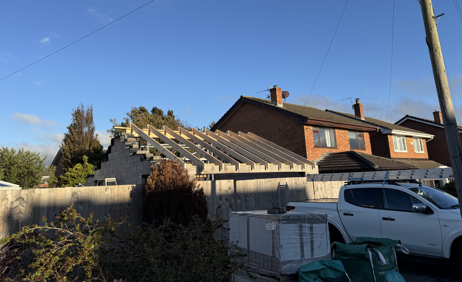

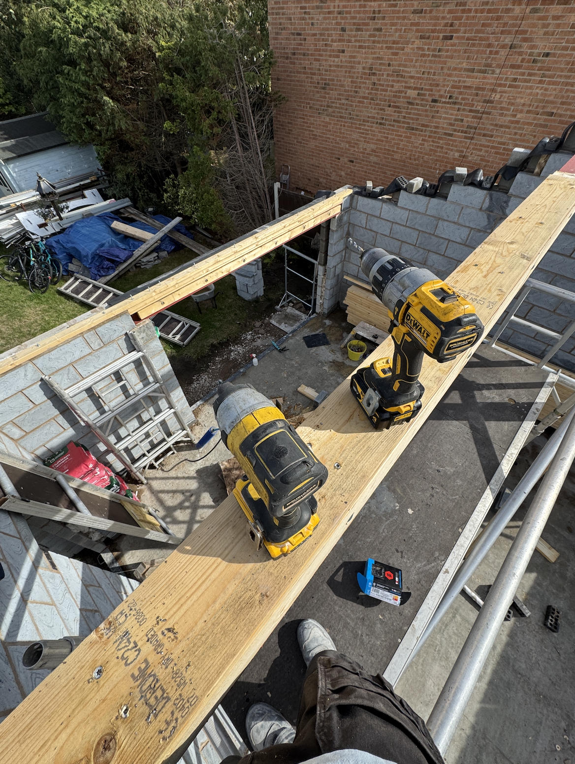

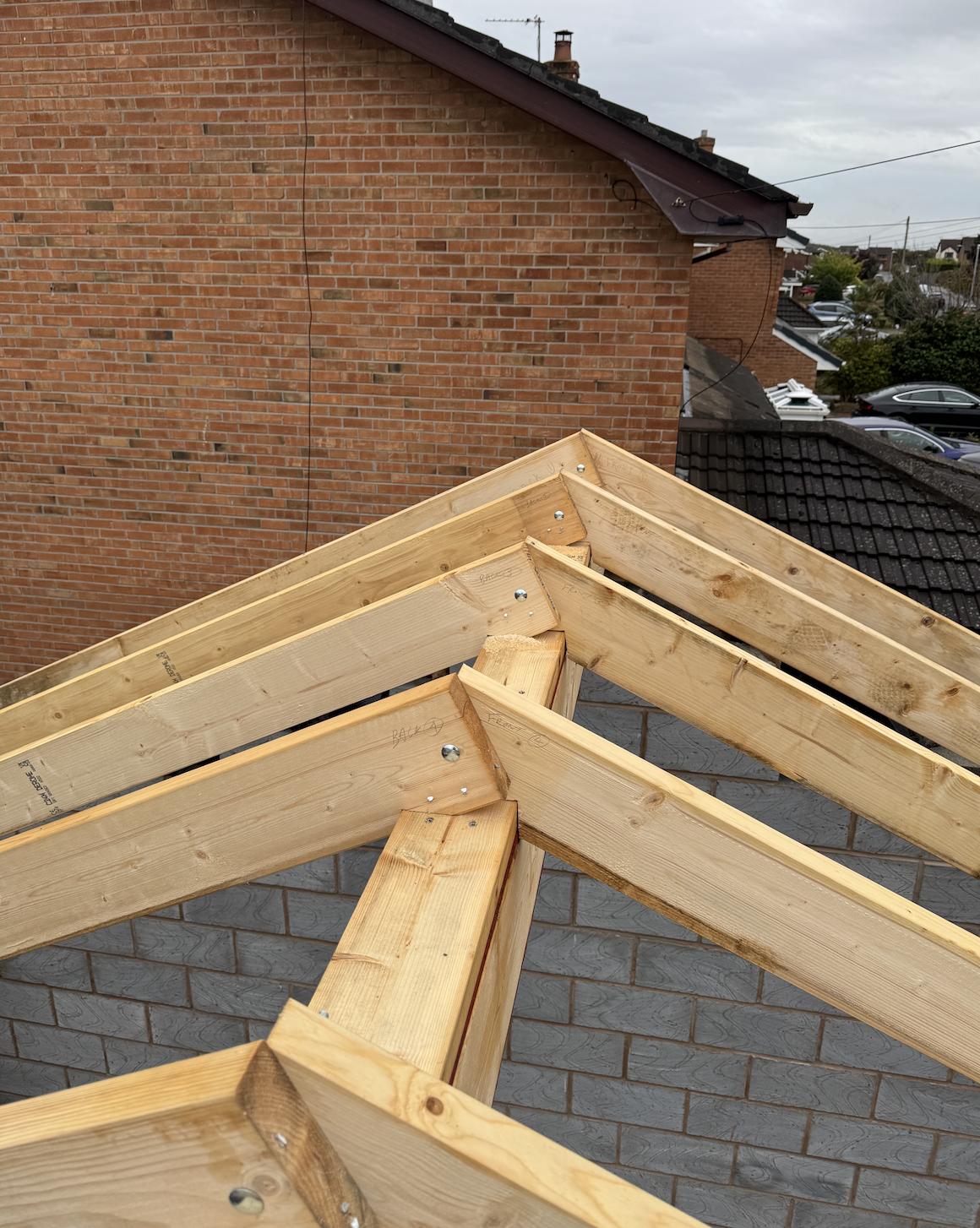

I was dreading doing the rafters as I've never done all the cuts for the birdmouths, etc before so I bought an extra 6 lengths of timber as templates/ones to ruin if it came to it. I went with 7x2 C24 for the rafters, which at 4.2m long we're particularly cheap so I wanted to be careful.
I spent about 4 hours getting the first template for both sides sorted to a point I was happy with it, and used 4 of my 6 spares :) The cuts were a bit complicated (by me) having put full sized blocks on the outer skin so there was extra notching to do to accomodate those.
As my building isn't 100% square/level I would use each timer as the template for the next, then fit the earlier timber and then adjust the next timber if the angles/notches were getting out of step. Bit of a long winded process, but necessary because of my lack of building precision. However once I got into a rhythm it wasn't too bad.

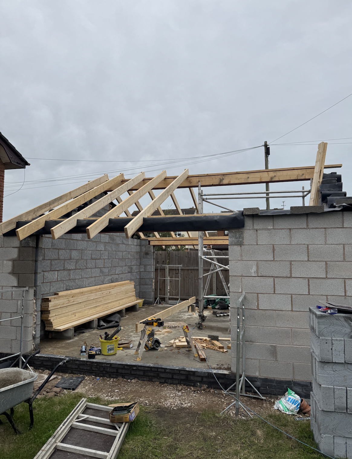

Bolted together at the top as per the plans. I've also nailed the rafters down, but will look to find a suitable joist/rafter bracket for extra hold.
I ended up getting all the central rafters up in a day, and cut the overhangs off to facia width. However, I was then defeated by the wind and rain. After that it'll be the gable ladders and then filling in the brickwork.

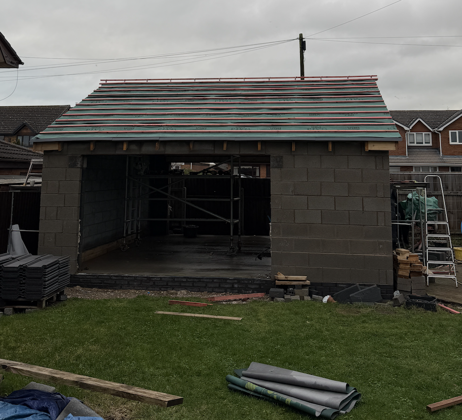

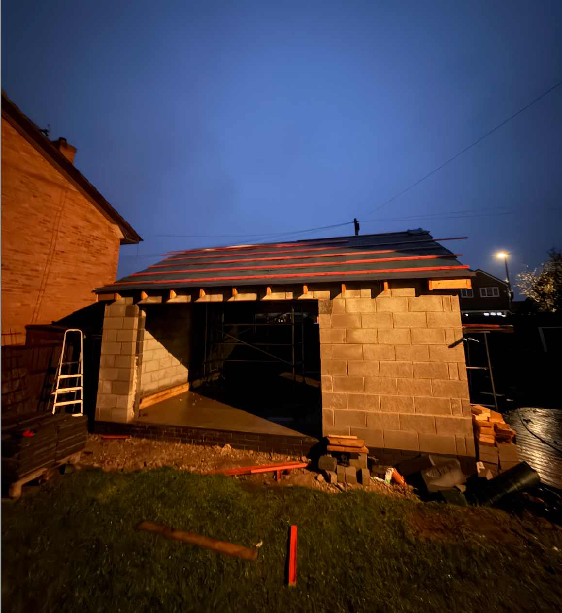

Then came the part I was looking forward to - actually getting the building to be covered (not water-tight as I didn't have doors etc), but getting the timber work and the cavities covered was long overdue.
Gotta love a hiab truck and a skilled driver who can plonk your stuff exactly where you need it :)
I faffed for most of an afternoon getting the soffit strips fitted correctly (I was adjusting so I could lay whole tiles across the roof - with no cuts). Then I was getting the eaves trays on. One that was done I thought was plenty of time to get the membrane on the roof before dark with some temporary battening.

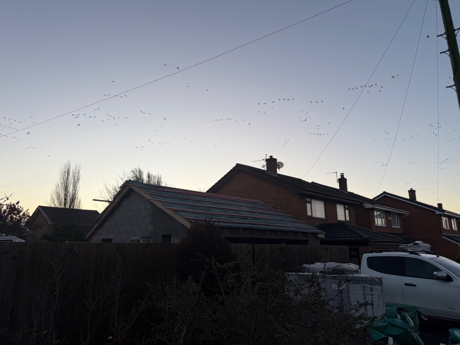

The from side was done first - managed to get this arty picture with the geese that always stop over in Hightown on their migration route... light already going!

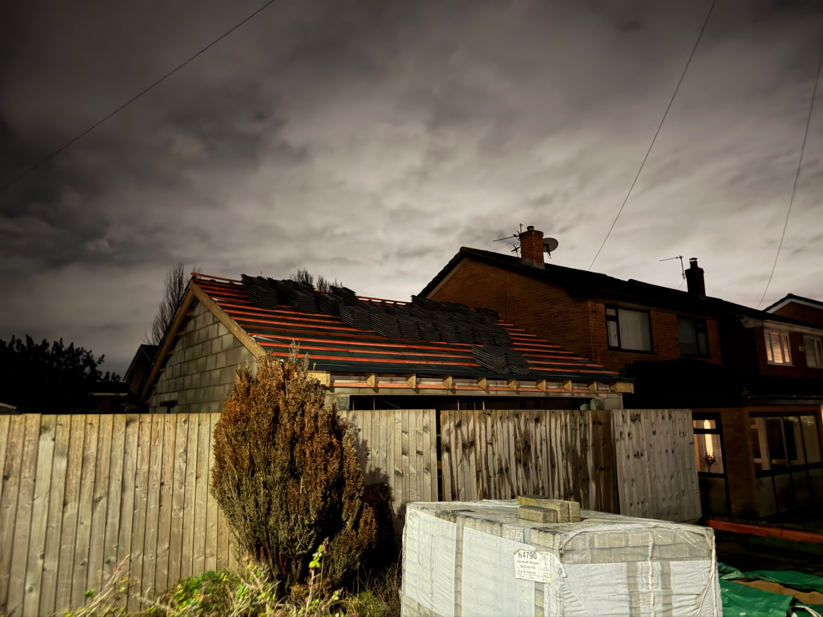

I guess you can see that I underestimated the time it would take to do the membranes as it was nighttime I'd finished the rear side! You can also see how wet some of the walls had been getting without having a proper covering for a couple of months.
Fast-forward to the following weekend and storm Bram had blown a lot of the above back of the roof (great timing), so I started again and this time battened it properly - ready to accept the tiles later.

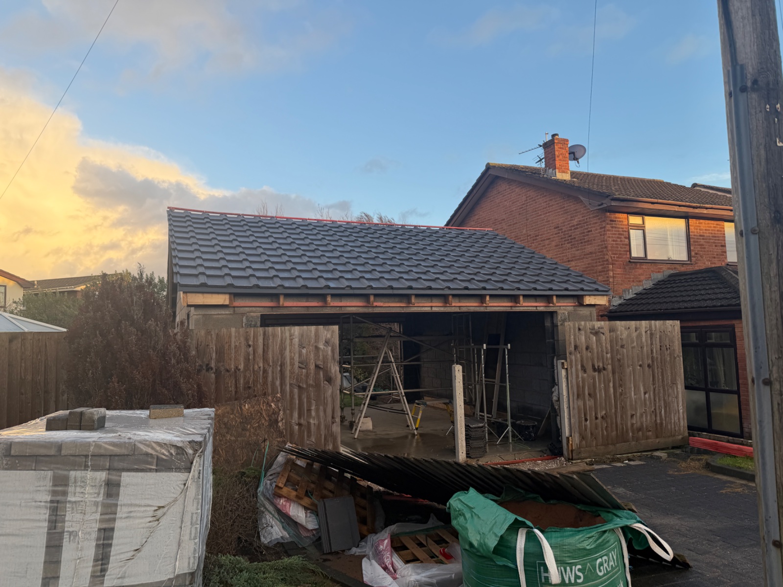

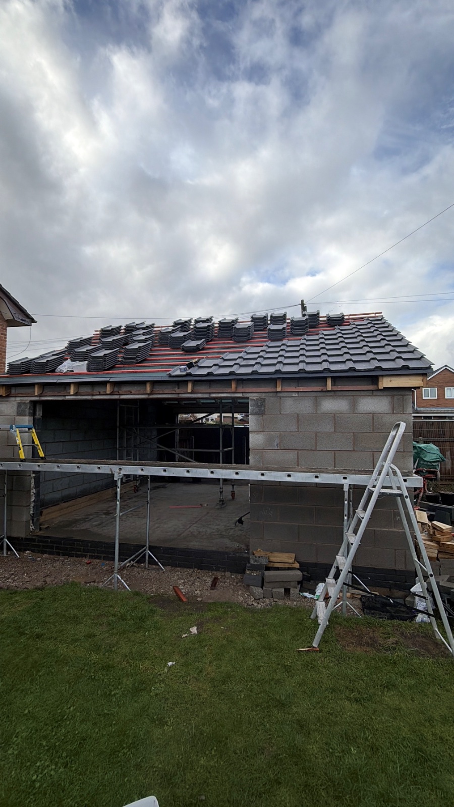

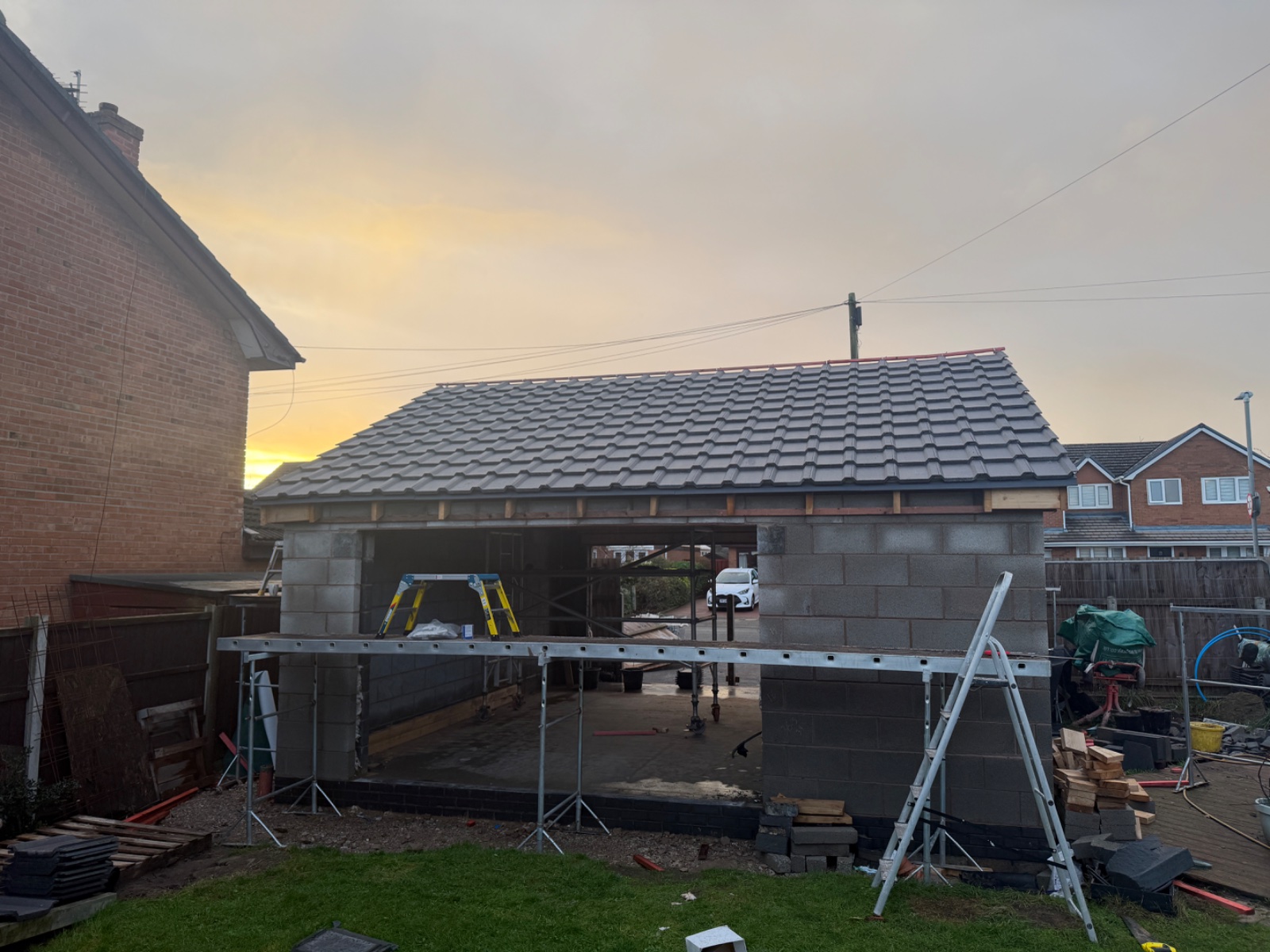

The following week the fun job was loading out the roof - no conveyor belt to do it this time. Each side needed 220 tiles, so it was a matter of getting them onto the staging board. Then piling them on top of the bottom of the roof. Then getting them up to the top corner of the roof (but out to the ways so to not interfere the the laying)... that bit didn't work well with the restricted space so I move some of the tile more than once!
Each of the eaves row tiles on these Marley Wessex tiles has a special clip that holds the tile and blocks insects, etc getting into the roof through the tile ridge, and then every other tile has a 'solo' clip which is hammered into the batten below to hold the tile in place...which adds to the laying time. However, making progress....
Rear side I managed to get done in a day:
As you can see from the above, the weather was quite kind for a Saturday in mid-November, and I knew the next day's weather was not good so by head torch I did most the load out onto the front that night too. 400+ tiles lifted that day and 220 fitted... my back was killing by the end of it :D
The next day was frigging horrible weather wise, raining constantly and gusts of wind sufficient to make you wobble on the roof. Of course, by the time I stopped to take a picture it was all blue skies and chirping birds!!
Need to wait for a dry day for the ridge as it requires a membrane to be stuck to the tiles before the ridge is fitted. After that soffits, facias and gutters to be fitted. Hope to do those before Xmas as the doors, etc arrive soon after that. Hopefully a more substantial update to follow soonish!

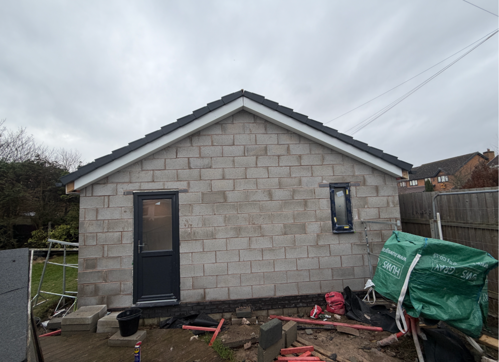

Firstly I got the side window and door fitted. I ordered a new window as I decided to go off-piste with the plans and wished to have a larger wall space as I may put another shed/room against this wall in the future. I order a mis-measured door from eBay which roughly fitted my dimensions, but as you can see from the picture below, it'll need a beading strip at the top to cover the little gap.
Yes, I know I've still got the ridge tiles to do and a bit of facia work, but will do that soon!

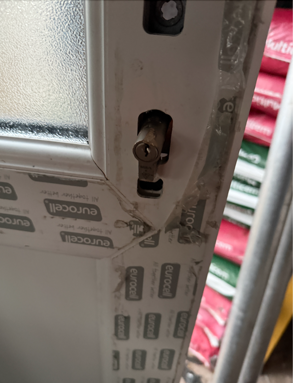

Annoyingly with the door, it came supplied with a lock fitted, but no key. Separately they'd provided a lock (with key) along with the handle. Somebody had had a go at removing the old lock and succeeded in rounding of the bolt that holds the barrel lock in place. Unfortunately I didn't notice any of this at the time I took delivery, and it was a few months ago. So in the end I had to go about snapping the lock to get it out, which is not as easy as the YouTube videos make out! Finally got there in the end and that also allowed me to turn the rounded bolt enough to get a pair of pliers on it to finally remove it!

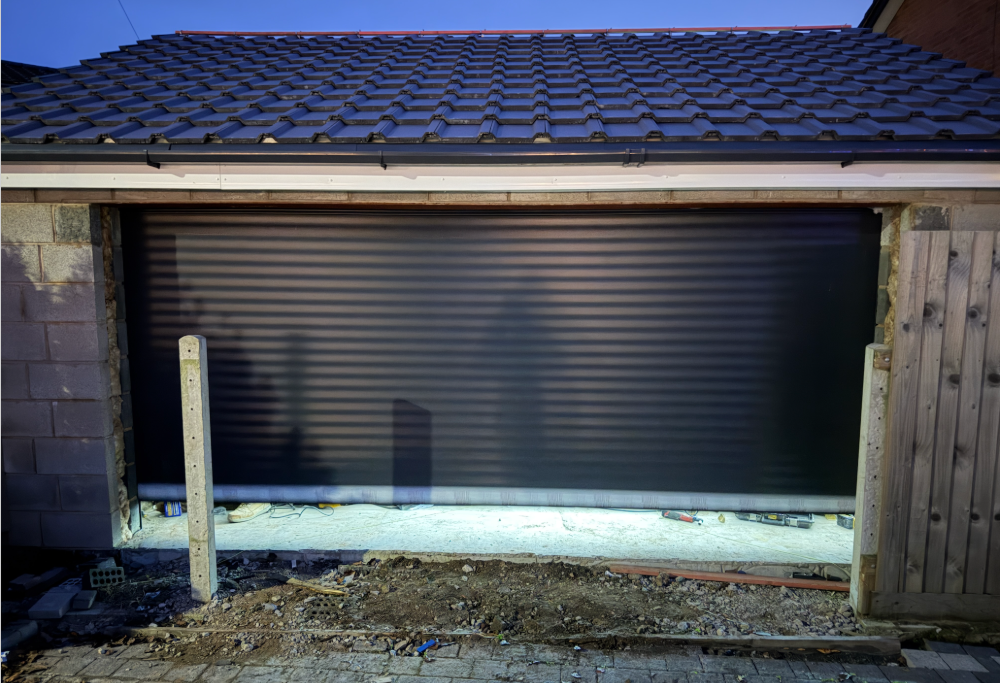

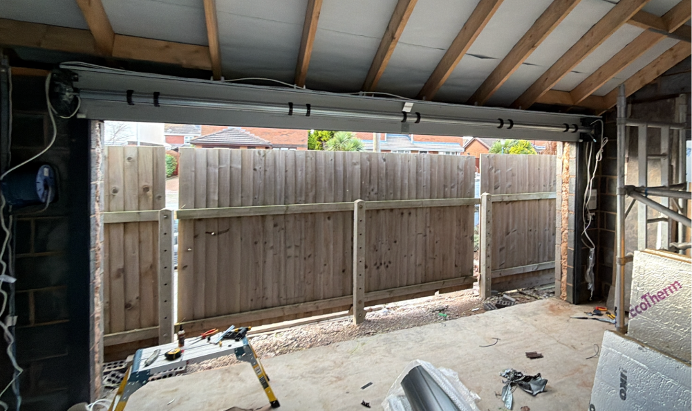

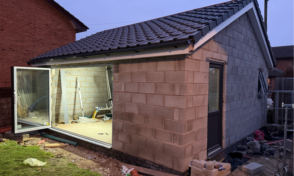

On boxing day I started putting my garage door in. I opted for an insulated Rollerdor with an upgraded Somfy motor and some remotes. It turned up completely disassembled (whereas most of the videos I found online had the roller/motor assembled in the housing box). I spend quite a long time having to drill and rivet mine together, before then cutting the runners and getting it on the wall. A couple of clamps to hold the runners to the wall as a god-send here to allow me to fix the thing to the wall. I also rigged up some temporary electrics so I could get the thing running. End of day 1:
I roped in my mate Wayne again who came to help me put the garage door on as it's pretty heavy and has to be held up while you connect the straps to the spindle. After a bit of cursing and scratching our heads about the control box (to set the min and max roller heights), we finally had a working door...which finally ment the fence I've been putting up and down every time I work on the house could be removed forever :)
The motion on the garage door is very quick and smooth, so I'm very happy with that. I will get some plastic utility boards to cover up the cavity.

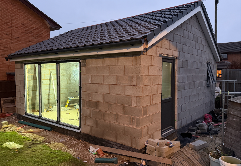

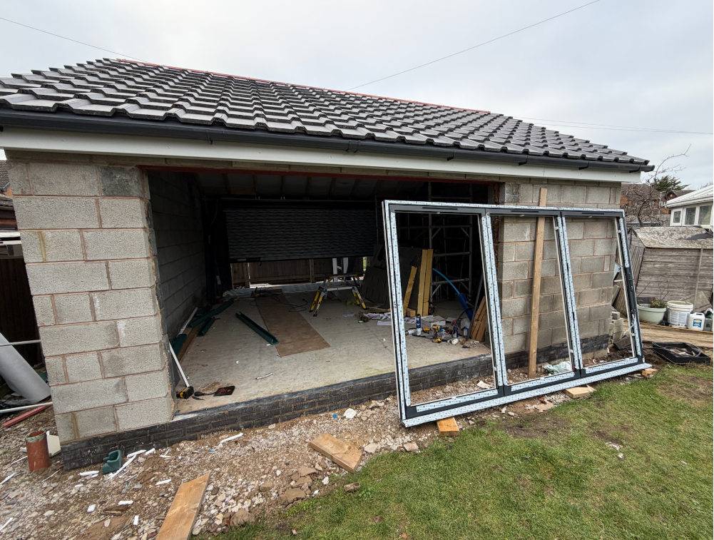

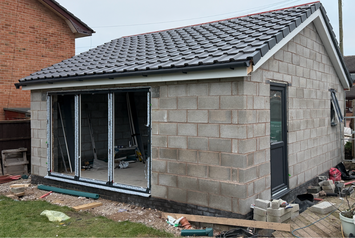

And in a 2 for 1, I also roped Wayne into helping me fit the bifold doors. We got them outside the opening and did a trial fit, only to find they were very tight fitting - even though I'd knocked 10mm off the measurements as you're supposed to. Although I'd fitted cavity closers, these had to come off to give us a bit of space. But with a little encouragement the doors went in, but we weren't left with much room for adjustment. However, we seem to strike it lucky as the doors opened smoothly and we were able to get the doors plumb/level.
On the left of the above picture you can see a little pile of wood/blocks. We used that when the doors were open to keep them (and therefore also the frame) plumb. In addition to the side fixings, the top and bottom must be filled at 600mm intervals - did the bottom with concrete screws and the top with TechFast self tapering screws as they had to go into the RSJ.
Glass went in ok, although there was a bit of head scratching on how to get the beading to fit back in, as you don't just bash it in (as you do with UPVC), you need to angle it a bit to get the aluminium into a groove and then push/tap it into place.
With the doors open. They move smoothly enough and close/lock fine, so thankfully the tight fit didn't hurt too much.
Yeah, Alu doesn't flex as much so the process tends to be to fit it in at an angle with the beading near the glass, then pull it away from the glass to lock it in, and press the rubber seal in afterwards, which keeps it in place.
There also tends to be an order because they're butt jointed in the corners rather than mitred so you have to put eg the sides in before in before top etc
