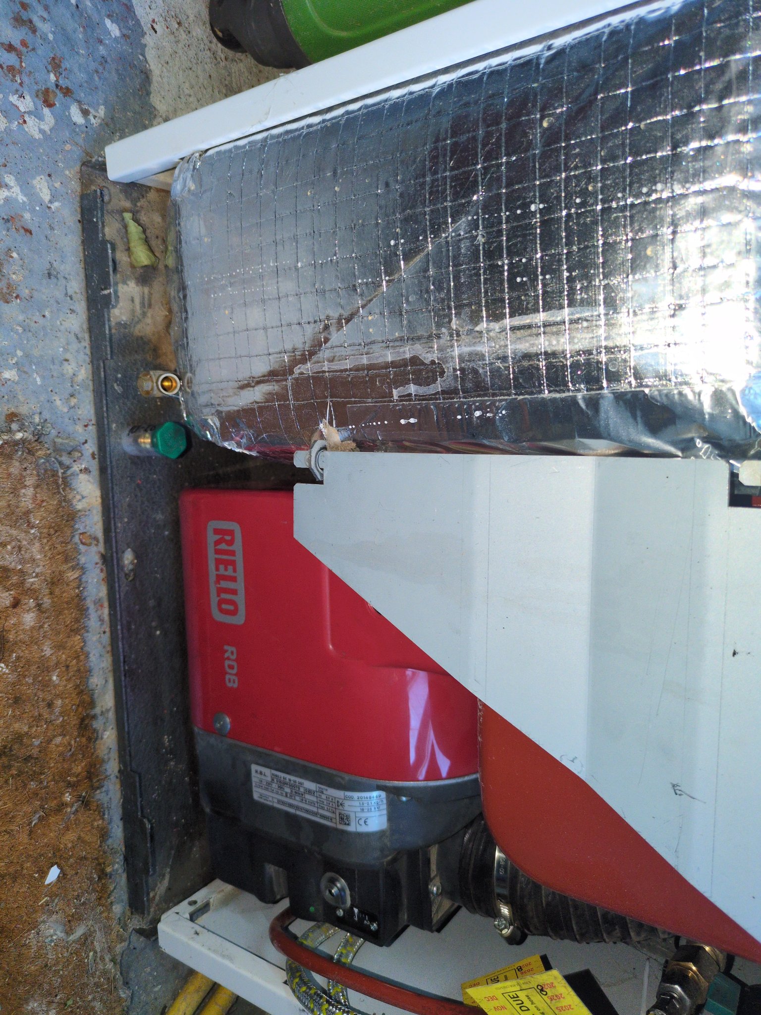

Boiler heating loop isolation test carried out from 2100 11/10/26 to 0900 12/10/26. On 11/10 I increased pressure to 1.5 bar in heating loop then isolated Flow/Return (2m from boiler) 2100 turned boiler off. Inspected 0900 12/10/26 pressure had dropped to just below 1 bar (boiler turned off all night, temp about 20/30 degrees). When turned boiler back on the temperature crept up from about 20/30 degrees C to 70 degrees C with the final pressure about 1.6 bar.
So the pressure swings from 1 bar (boiler turned off) to 1.5/1.6 bar (boiler fired on).
No leaks (so far) on the radiator side

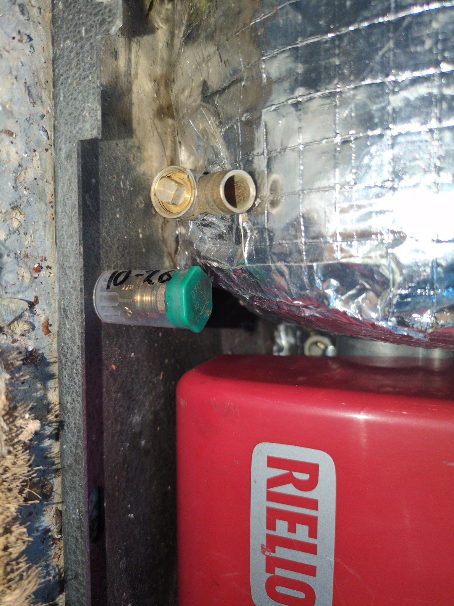

I looked in the PRV discharge line and there was no water/fluid in the bag taped over the end
If you increased the boiler pressure to 1.5barwhile cold and it then fell to 1.0bar then you will have lost a substantial 2.4L. IF "So the pressure swings from 1 bar (boiler turned off) to 1.5/1.6 bar (boiler fired on)." and if that means that the cold pressure is 1.0bar and the hot pressure is 1.6bar with the system up to temperature and then returns to 1.0bar when cold then that suggests that the charging/filling pressures are the same (at 1.0bar) so this would be normal under these conditions.. You should ensure no pressure at the EV water (boiler) end, then get a tyre pressure gauge and check the EV air end pressure at the schrader valve, ensure its (air) pressurized to 1.0bar, fill/pressurize the water end to 1.5bar and monitor it again, the pressure should rise to ~ 2.6bar when hot and reduce to 1.5bar when fully cold, if it eventually reduces again to 1.0bar then you have a leak somewhere as there is nothing coming from the pressure relief valve. The leak might be from the boiler combustion chamber, you might then see a leak into the condensate trap.
Have a really good look round base of boiler .
The Worcester oil combi's are know for leaking. Check carefully round heat store.
We have pulled out a number at 5 to 6 years old.
Also expansion vessels fail with horrible regularity.
