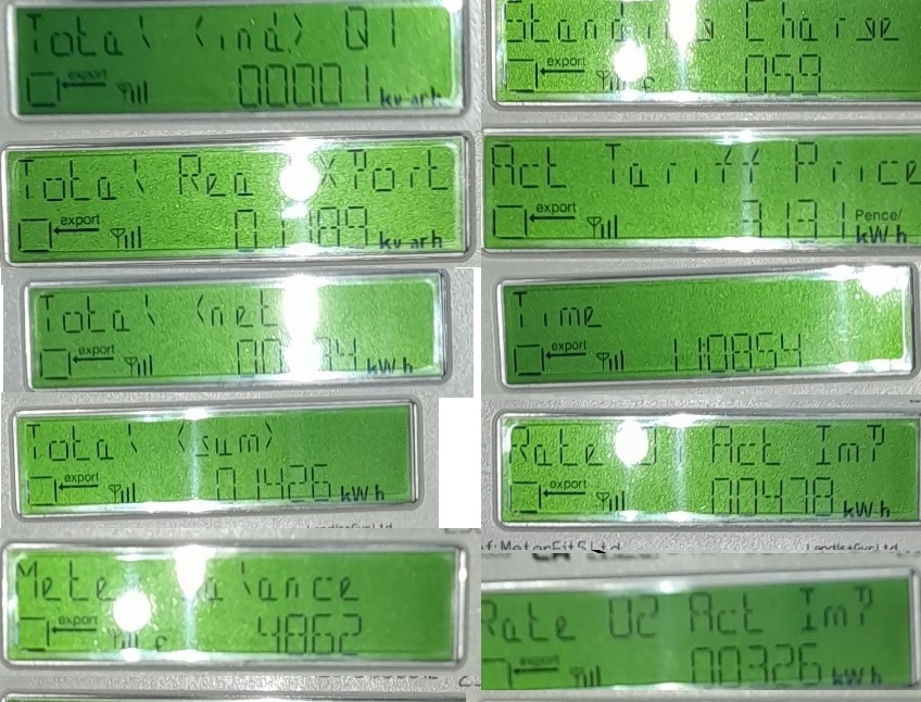

I have tried to read my smart meter and failed, there are so many displays, Smart meter reading 4.jpg and no instructions as to what they all mean, I know I should have three readings, one peak and one off-peak, and one export, but I have failed to work out which of the reading are which, I rely on the app to tell me, so if my signal stopped working they would need to send a meter reader I could not provide them with readings, as there are so many.
I had to have a smart meter to be paid for export, but all I see on the IHD is zero, or export, so the display to me is useless, what would help is a state of charge display for battery, that I could see at a glance, I have to use phone or PC to see if spare energy I can use to do washing etc.
