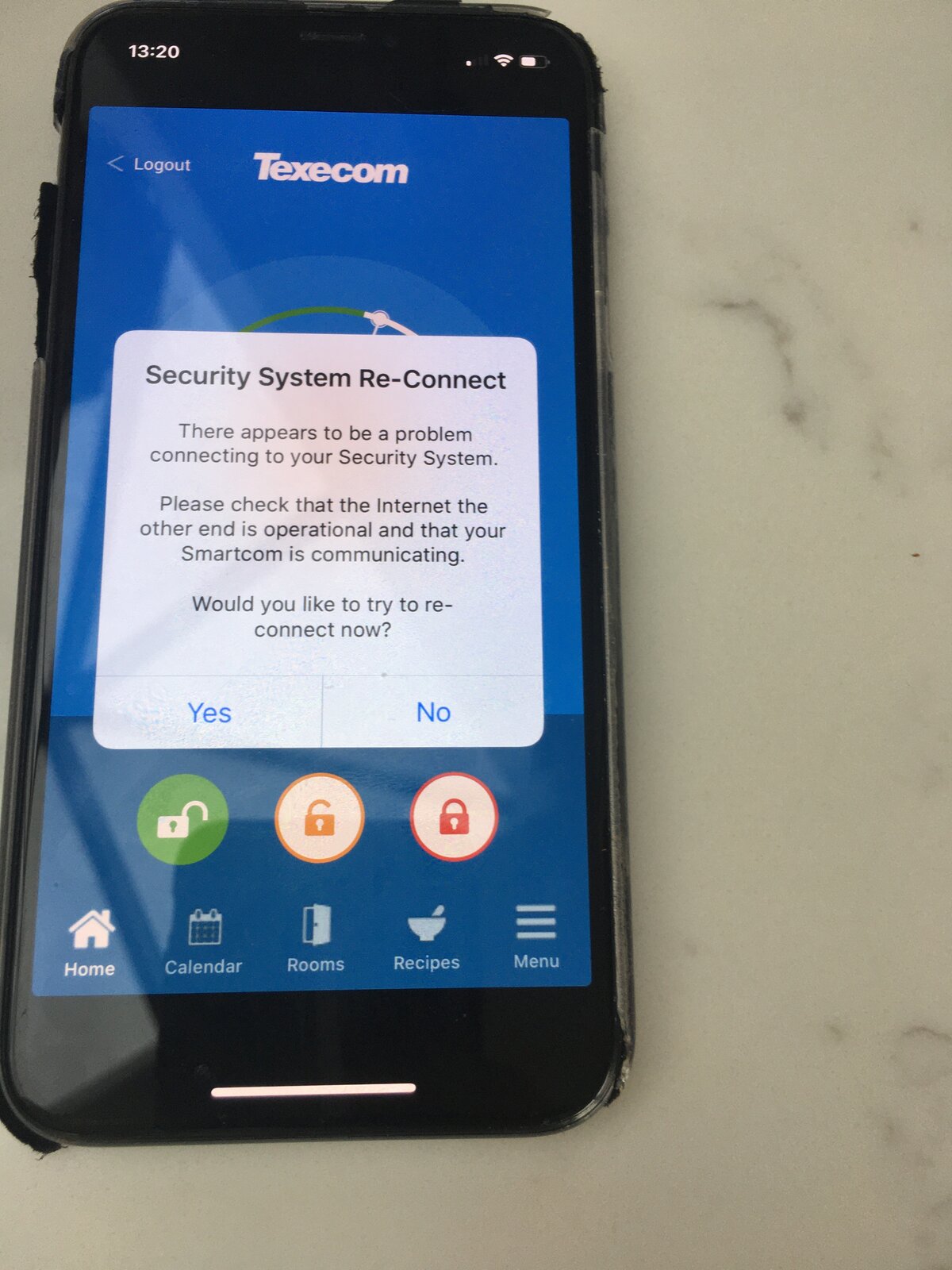

Hi,
Any ideas what can cause a Smartcom to lose connection to the Texe Cloud server.
The App was working, then stopped due to cloud connection, left led flashing.
This was fixed by the person who installed it, not sure what was done.
It's now dropped the connection again.
It's connected to a BT router via a cable, internet is fine.
I have a similar Texe system that is connected to BT router via wifi which works fine.
I don't currently have SW versions but it was installed within the last year so should be current.
Attached is the error seen on the App
Dave

check which smart functions are turned on for the router and look at the logs to see when it dropped off.
There are articles covering this on the texecom forum.

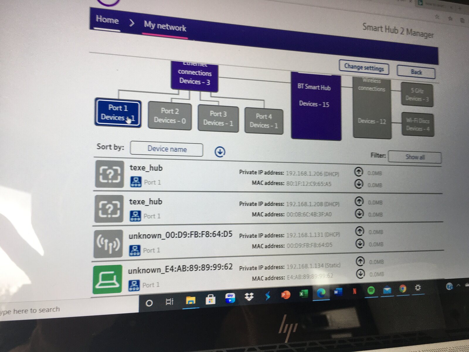

Hi,
Further to the smart com issues above, losing the connection to the Texe server.
The installer has reconnected the smart com twice, works for around a day the loses the connection again.
Its a wired connection to a BT smart hub. I have a smartcom connected to the same model hub but via wifi and all is fine, even with Smart setup on.
In the admin menu on the hub it shows 2 appearances of the smart com, both disconnected, see pic. Both with different IPs and Mac addresses, so the smartcom unit has been changed but still drops out.
I have turned off the Smart setup on the Hub.
Any suggestions please on what to do next.
Maybe change from wired to wifi (as mine is fine on wifi).
Should I just pull the lead from the smartcom and just go through setup again.
Any other thoughts greatly appreciated.
The panel is a Premier Elite 8XP.
Dave

8XP is an expander not a panel.
hmm I would go through the process with the smart com and choose hard wired to be fair.
I would reboot the router first.
If I pull the lead from the Smartcom will I have to go through the full setup on the panel or will it reconnect on re powering up.
Dave
pulling the cable to smart com just removes power and coms between the panel it has little or nothing to do with setup to be honest.

Without looking cant be certain.
check your DNS servers in the router and change them to the google 8.8.8.8 and 8.8.4.4 if they aren't set.

However I have found a setting that is different to mine (mine works fine on default router settings).
The 'always use this ip' setting is set to No, on mine its YES. So guess when the lease runs out the IP is changing, am I correct to assume the IP changing will cause the issue.
Have tried changing the setting to YES but keeps defaulting to NO, going to try another router when I can find one.
Dave
If you know the version of your BT router you should be able to find the instructions for the dns servers and what they are set to.
In theory and from practical observation the ip address of the comip module changing hasn't been an issue as the smart com is using the cloud so port forwarding doesn't apply, as long as the router shows the device as connected.
