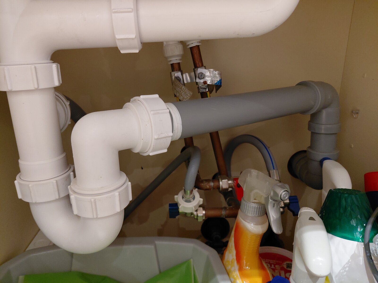

We've recently moved house and upon fitting the washing machine, I've noticed an eggy small coming from the drains when the washing machine does it's pre- wash drain.
After messing about with the pipework, I think I've narrowed it down to the fact that it's fitted to the horizontal spigot (the one at the back of the pipework). When the drainage hose is not connected and the tap is run, water will pour through the Spigot, so I suspect that the waste water is collecting in the pipe and when the drain kicks in, it releases all of the water that's been sat there for days getting smelly.
I could connect it to the other spigot (capped off with brown tape), but then that leaves me with the problem of an open spigot which pours water out every time I run the tap.
I've tried looking for something to cap it off should I remove the Spigot, but I can't seem to find anything. I have seen little cap for the spigot itself, but wasn't sure if this would be suitable given it's going to always have water coming up against it.
Is anyone aware of anything that would do this job, or am I better off getting rid of it altogether and fitting something like this instead - https://www.screwfix.com/p/mcalpine-adjustable-inlet-tubular-p-trap-white-40mm/46577 ?
Side question, why would one these horizontal spigots be needed if they're always going to expel waste water? Genuinely curious.
Thanks in advance!

I'm not an expert here but some thoughts:
- Is there a blockage/restriction in your waste pipe (large grey pipe), that is making water back up? Would using some drain cleaner be worthwhile?
- What currently happens if you take the brown tape off the top spigot and run the tap? Does water come out? If the drainage was working correctly, I don't think that water should be able to escape from here.
You mean the one that is barely visible in your photo?
I have the impression that the washing machine outlet hose is coming up from the bottom of the cupboard to connect to it. Is that right? Please post a better picture where we can actually see that pipe.
The hose really needs to rise to just below the work top level, and then go back down to connect to the pipework. If it doesn’t, the washing machine will fill with sink waste water.
Unfortunately, whoever plumbed that in didn't do it correctly. That spigot adapter should not be in that position on that design of the sink waste/trap run, it is actually in the section that forms part of the trap seal, that should just be a straight piece of pipe.
That all needs re-jigged, that spigot adapter removed and then use the spigot that's higher up.
As suggested too, the drain hose should be up and over and not run under the units, that's a typical kitchen fitter's mistake.
As above, if replacing the Tee section is a problem, then you should be able to remove the spigot from the Tee, and fit a 40mm cap in there instead to seal that off.
Drain hose then needs rerouting so it rises from the machine, as high as possible underneath the Worktop then drops to the discharge point. This prevents dirty water from the sink draining back into the machine, which is the likely cause of your issue.

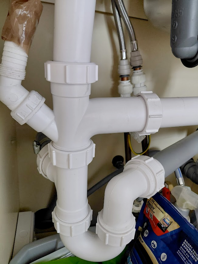

Actually, looking at it again, that is an appliance trap that McAlpine supply, with the appliance spigot at that level but it doesn't come as part of a sink kit setup, I think that's been added. The main problem though could be with the level of that horizontal section of grey waste heading out to the right, ideally the waste pipe would be heading downwards and out or at least downwards. I know the camera angle can be deceiving sometimes but is that section of pipe level or even uphill?
Taking that section out though and replacing with an adjustable P trap may do the trick but again I'd be wary about how good a fall there is on that grey waste pipe

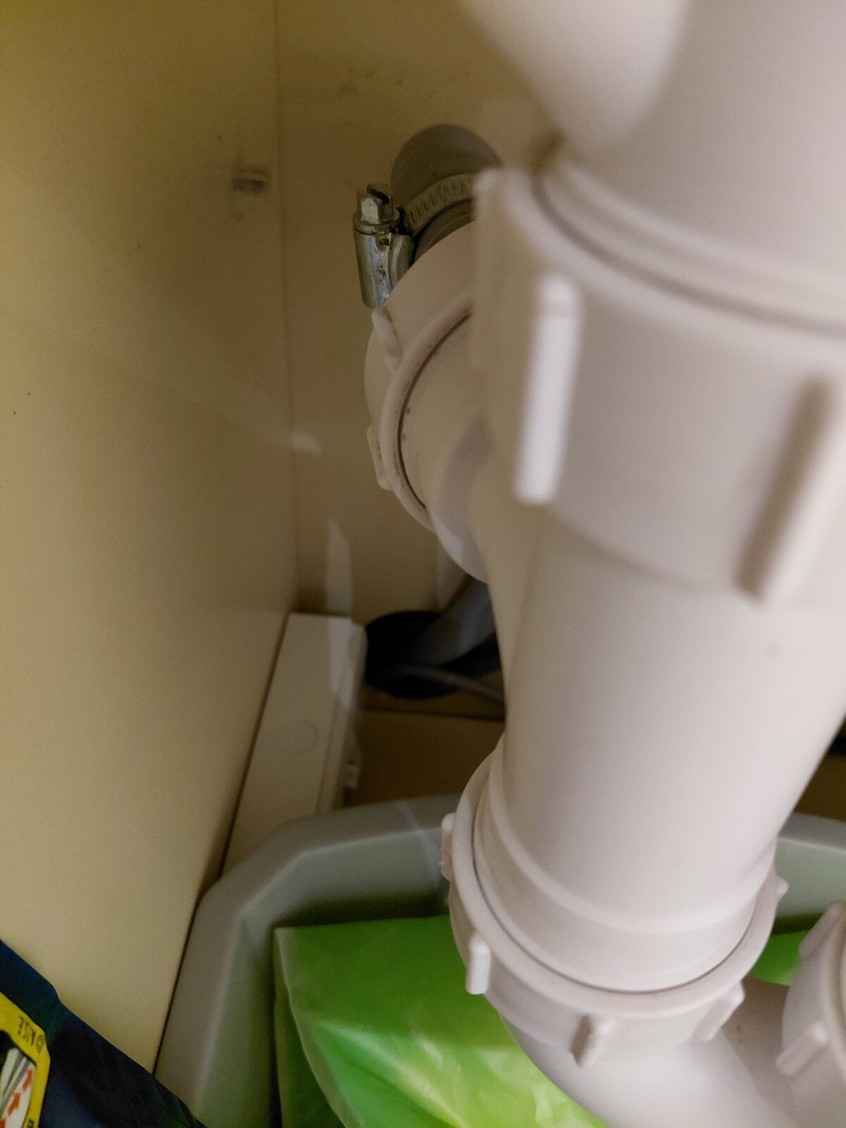

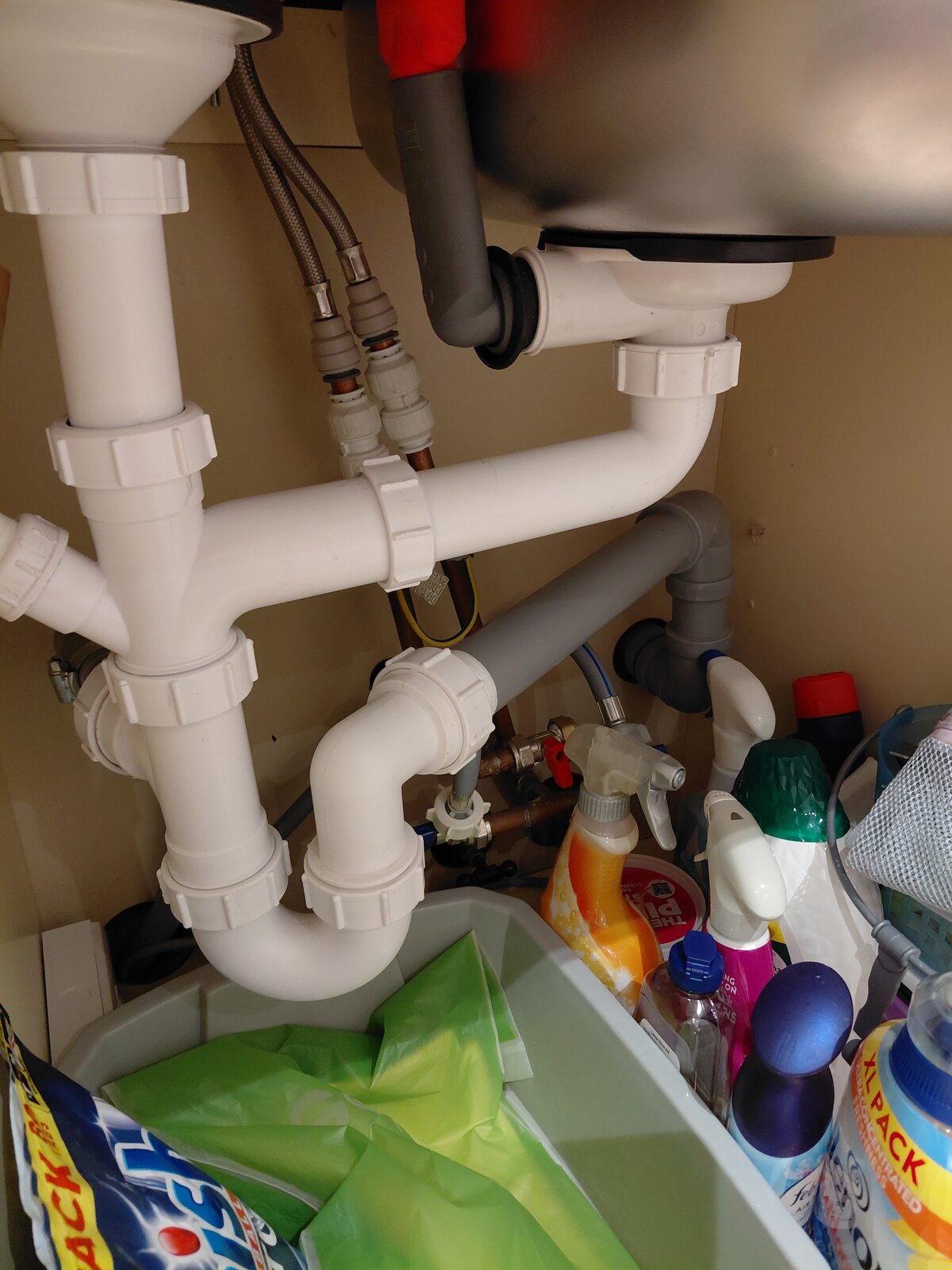

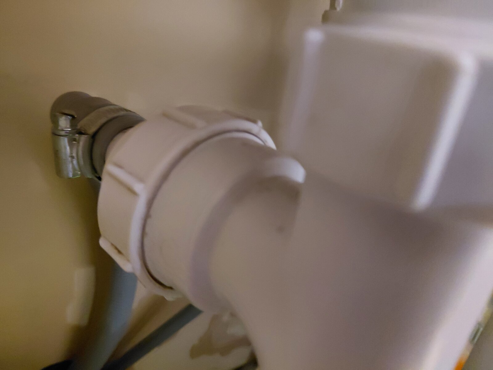

Hopefully these should be a bit clearer?
Having had a look at it, it definitely seems like the grey pipe is at best straight, rather than angling away.
Hopefully getting rid of the extra section, putting an adjustable P trap on it and using that to lift it up a bit should sort it?

Yes - you just want it angled down slightly so the water will always want to flow out, it'll help with drainage and help to keep the pipework cleaner.
No, the most important thing is to have the washing machine outlet host rise up as far as possible, ideally to immediately below the worktop, and then back down to the trap. Currently it rises from floor level and into the trap. Half pf your sink waste water will be draining into your washing machine.
While the grey pipe might not be ideal, this is surely a secondary prpblem.
