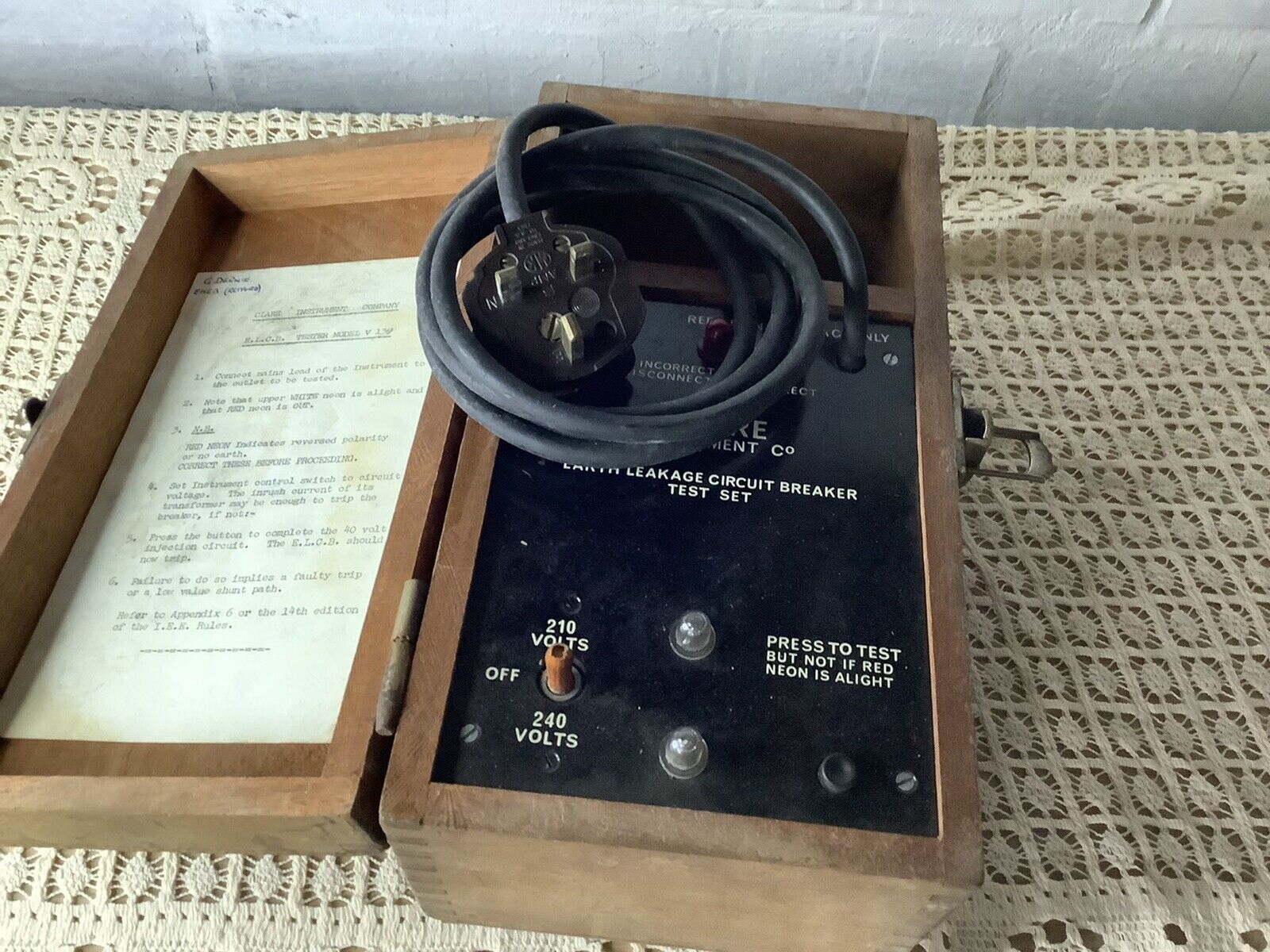

I am told you used one of these Clare ELCB tester3.jpg to test them. When I started as an electrician I did not see any, not a clue why, but think the water main to most homes resulted in a rather good earth? It was only when we went to plastic water mains, and relied on the earth rod, that the ELCB-v came in, first time I found one was around 1989 at a caravan site used for workers building Sizewell 'B', think the site left over from building 'A' station, and my fitting of earth wires rendered the units inoperative, and they were all changed to RCCB's as then called, was ELCB-c and became the RCD.
It was the problem with stay earths which resulted in the ELCB-v being phased out, I was told they were banned, but not sure on that.
Sorry I mentioned the ELCB-v now, @zaarin_2003 must be totally confused. @davidarthor146 post has resulted in the thread running off on a tangent.
I remember it was also Sizewell when I first came across the heavy use of RCD's, many values from 1 amp to 30 mA, with delays which should have ensured correct one tripped, but the problem was switches tend to only switch the line, and neutral was left connected, so finding earth to neutral faults was hard.

The VO was designed to operate when the voltage difference ( delta V ) between Ground potential ( from a Ground Rod to Terminal E ) and the potential on the internal Earth ( connected to Terminal F ) was greater than 50 volts ( other voltages were available ).
Simple concept that prevented the safety Earth ( CPC ) inside the building from becoming Live. Worked fine provided there were no alternative paths from CPC to Ground, even then it did prevent the delta V becoming dangerously high should some one be in contact with the CPC and Ground at the same time.
Metallic water mains that were bonded to the CPC were the most common alternative path, In a fault situation several Amps ( if not tens of Amps ) could flow through the alternative path without raising delta V to a voltage high enough to trip the VO ELCB Significant, possibly dangerously high, earth leakage but the ELCB would not be tripped.

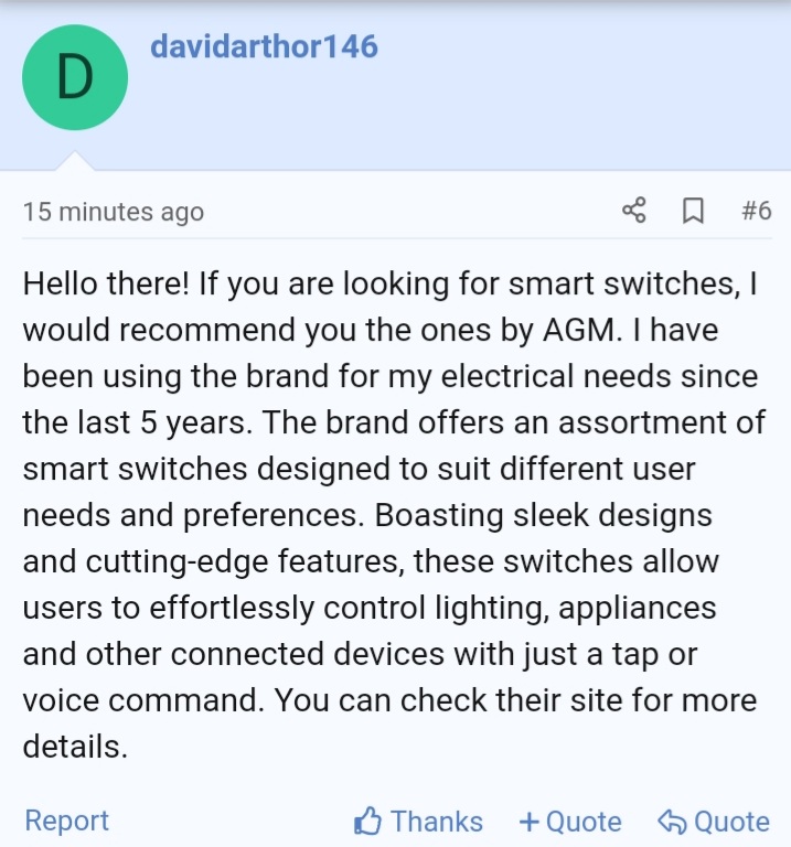

...I'm not saying that this is the case with this post... But, this seems a fairly common modus operandi.
A new poster may resurrect an old thread, their post could make little sense, be irrelevant to the original post, or repeat the previous posts in the thread, in order to appear legitimate.
Their second post will include the spam links! :rolleyes:
And here's the second post! :)
