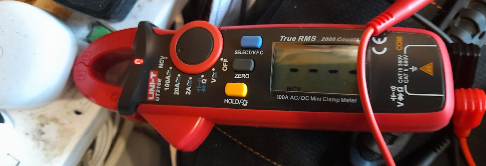

I tend to use first sight, then if can see nothing wrong then non contact meter Testing for live.jpg and if that does not find the fault then I plug in the leads and hunt further, everyone hopes they will find an obvious fault, but it you can't then you need to test.

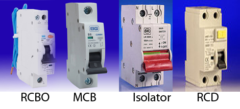

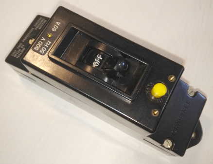

To find the fault you need to know what your working with, I would think you have some of these, PartID_CU.jpg helps if we know what you have, may even be one of these 1684374395415.jpeg but I hope not, the ELCB-v has not been used for years, but for anyone to help we need to know more, and using non British names does not help.
Pictures are good, also what have you got to test with? And the question must be does anything work in that socket? Some thing with low load like a table light for example.
