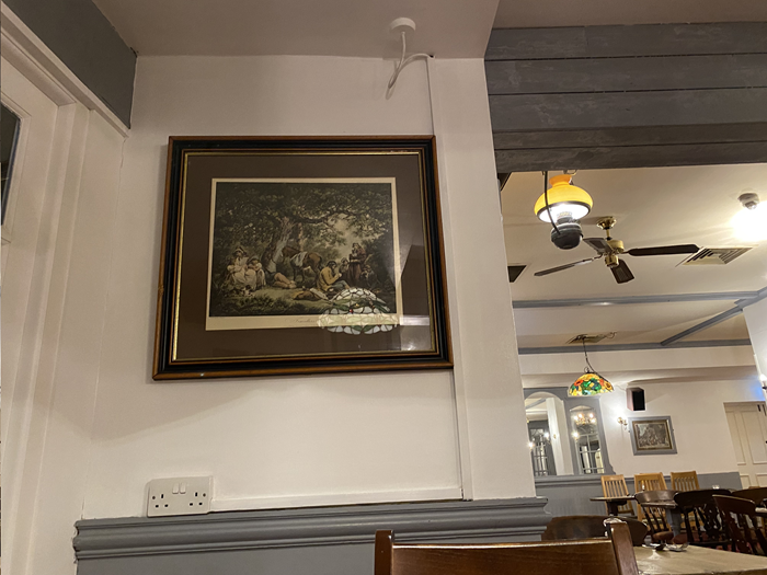

Hi folks. I realise the the person who would probably have most interest in this does not appear to be any longer with us, but ....
.. I recently stayed in a hotel which started life as an 18th century coaching inn. Whilst sitting at my table in the restaurant, I found myself just adjacent to what is shown in photo below. I suppose it may not be 'as it seems', and the cable in surface trunking may be related to the fact that the building is listed, but the (double) socket is certainly in a location which (in contrast to the situation in a loft) is probably quite likely to be used by a cleaner to plug in his/her vacuum cleaner.
Any comments? :)
Kind Regards, John
Its the reverse, the socket circuit is supplying the light, which was subsequently d3commissioned and now acts as a jb. You can see the black cable supplying the fan just behind.

Of course it could turn out that the socket isn't fed by the flex from the rose and that cable goes elsewhere......
Well, there's absolutely no doubt that the trunking (which the cable enters at the top) goes to the socket (with no branches to anywhere else), so I'm not sure what other ;elsewhere' you might have in mind.
Was there another socket lower down the wall by any chance?
No evidence of that. There is wood panelling from the position of the socket right down to skirting level and,judging by the general state of 'maintenance of decor' in the place, if there had, for whatever reason, been a socket lower down, it's very likely that evidence of that would still exist :-)
Perhaps there used to be a serving table in front of the socket with a lamp on it?
No space. It's in a tiny 'bay'/alcove', just the width of the double doors (which serve as an emergency exist) and only (just about!) big enough for one small round 2-pwerson table + chairs. I'm well known at the place, and it is,when I'm there, known as "my table" :-)
Whatever, I don't think that there is any getting away from the fact that (even if it's not 'feeding the socket') there is a a length of flex which goes from a socket and which enters the 'outlet' of a ceiling rose - which surely is an 'unusual' situation, to say the least, isn't it?
Kind Regards, John
Its the reverse, the socket circuit is supplying the light, ....
I don't really get that. How could one 'supply a light' through a cable entering the 'outlet hole' of a ceiling rose?
Particularly given that (as you can see) the style of the lights in the room is to have large/wide shades/whatever, not to mention 'where it is', it would seem extremely unlikley that there was ever a light in the position of that rose, only about six inches from the adjacent wall.
.... which was subsequently d3commissioned and now acts as a jb.
It has always been my greatest suspicion that it was being used as a JB, albeit not in the manner you describe.
As I keep saying, I think people are overlooking the ('for weekend amusement') reason I started this thread. I obviously can but guess/speculate, but I suspect the most likely situation is that the socket IS being supplied from a 'lighting circuit', via that rose. However, my point (remembering the views of 'you-know-who) is that not only would that, in itself, be fully compliant with BSy7671 but that, if (as could ell be the case in a hotel) it is a 16A (or even 10A) lighting circuit, then no problems would be likely to arise even if someone plugged a vacuum cleaner into the socket. The only possible compliance issue would then be that eric would probably point out that a ceiling rose would probably not be 'rated' for the current it might carry in that situation.

Bit late on the topic, don't pretend to have read every word, but I can't really see any difference here to the stuff people here have always suggested to other people when faced with no convenient socket point to connect into.
We recommend it as a last resort, yet some seem horrified when they see it in real life.
If this really is connected to a lighting circuit, there is a chance the circuit is protected at 10 amp, the rose rated at 10 amp, and the cable rated at 10 amp or more.
You're assuming that a cable does not go through the wall into or out of the trunking.
I agree. What electrician wires in flex? If majority did then
Next, people will be saying it's ok to use bell wire for fire alarms and it's ok to use multi core flex to carry 240v circuits alongside ELV circuits just because it's easier than running two seperate and segregated circuits.
Are those two examples you quote compliant?
Wiring with flex is.
Exactly. My main point in posting this was to indicate that this may well be (although may not be) an example of even a commercial installation having a (compliant with BS7671) socket installed on a 'lighting circuit', even though (if that were the case) this use of a ceiling rose is rather 'interesting', unusual and perhaps 'quaint', no matter what you-know-who would be saying about the arrangement, it if he could :-)
It's obviously not how one would normally plan to do things from scratch, but there's nothing fundamentally wrong with it
Indeed - but, as I said, it could even be a 16A lighting circuit - even better for vacuum cleaners but, in that case, it would be unlikely ('impossible'?) that the ceiling rose would be rated at 16A, so eric could still 'complain'!
