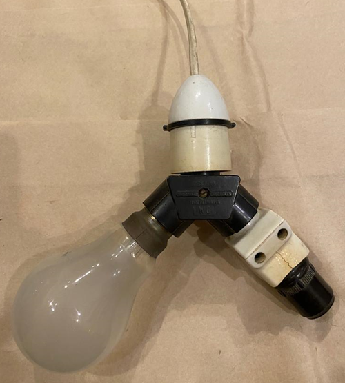

They still sell ones with two output sockets and a bulb holder in home depot.
From my cellar .... one light bulb (no argument about the word back in those days :-) ) PLUS 3 x 2-pin outlets (one hidden behind, and one a B22 'plug' fed from a single B22 lampholder
... and I've seen worse 'Christmas Trees' than that, hanging from lamp holders, in my time :-)
Kind Regards, John

I'm not sure what you are referring to - if the photo I recently posted (of what my grandparents used to use, 60+ years ago), then that doesn't surprise me, but in a few decades' time, people in the UK will probably regard it in the same way as those in the UK do today!
