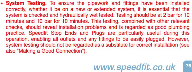

Push fit systems are reliable provided they are installed properly, and the system is pressure tested before being put into service.
This from the JG technical information:
If this is not done, there is a good chance that one or more fittings will not grip the pipe correctly, resulting in failure.
