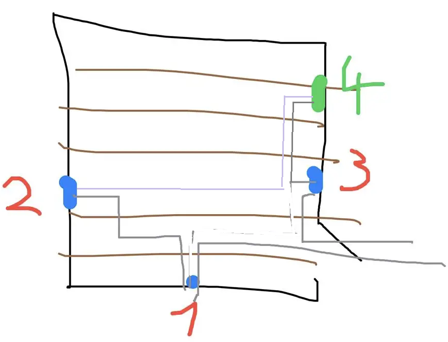

I am getting new flooring put down in my bedroom and as such I will need to strip the existing carpet down to the original floorboards. Whilst I have access, I want to wire a new socket onto the existing ring final and potentially cleanup a few things given that these areas will be inaccessible for a long time.
I've attached a quick sketch on the setup. Entrance door is on the bottom right and wires enter into the room under floor from the landing. I've also indicated how joists are running. Socket 1,2 and 3 are existing ones. 1 and 3 are on the ring main and socket 2 is spurred off socket 1. All sockets are currently in the skirting boards, but I will move them into the wall at the same time. The additional socket is planned for location four (to have a socket on each side of the bed). This is a three part question:
1. Should I spur off 3 to connect socket 4? Easy wiring and just one extra cable w/out any JBs. Or should I extend the ring to 4, which means I need to add a JB to extend one leg to go straight to socket 4. This then of course is difficult to reach once the new floor is down. JB for me would be wago221 with matching box, closed with zip ties...

If you want to have connections under the floor then you need Maintenance Free connections
The better solution would be to remove the cable from 1 to 3, add a cable from 2 to 4 and another from 4 to 3 - and properly test it before the floor goes down. That way you avoid the issue with joints under the floor and have all the connections at the sockets only
Ah that is indeed the much better solution, doing away with JBs completely. Thanks for that.

(y) I did the sketch before preparing dinner and forgot to post it, oh well better late than never.

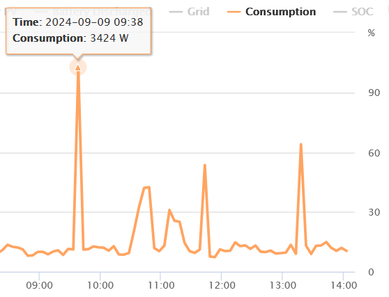

In real terms my ring finals are never loaded anywhere near their maximum, my whole use today 1725887145788.png is 3.4 kW well under the rating for the ring, I suspect most homes are the same, to get over 20 amp is rare, however you have to cater for those rare times, your outside with leaf blower, the washing machines are on, and then wife also turn on a kettle, it happens.

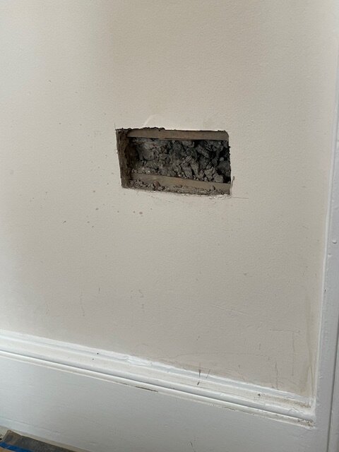

After spending a weekend ripping out the old flooring and dismantling 3 large wardrobes, I finally got to work on this. Hit a roadblock though… whilst moving socket 3 out of the skirting board and over to the right closer to the door, I found that the void between the studs is completely filled with plaster leftovers…I’ve only seen it fill up a few centimeters but this one appears to load up at least 45cm but probably much more… it will be impossible to get two wires through there…
Any ideas what todo? I dont want to move the socket too far in, as it will end up behind the backboard of my bed. If i move it just slightly over and then use a metal backbox going straight onto the stud, then i could possibly see if the void on the left is more manageable and have the wired enter the backbox from the left side? Plaster+laths is about 30mm deep, so tight fit but theoretically possible. Any issues with fixing a backbox onto a stud?
That kinda looks like breeze/cinder block to me, are you sure it's loosefill?

Yup, I can poke around with a screwdriver and move stuff.
I cut out the middle lath hoping it was just a thick layer and it will all fall off inside the void.. but no chance unfortunately. I've already finished the new socket 4 the same way and it worked perfectly fine.
What would you think is the best way to close this hole again? I have drywall screws and can fix some support laths behind, but I do not have any dry wall to close and decorate.

Have you tried poking downwards to see if you can force a cable route.
If the plaster lumps really are loose I'd have a play with the vacuum cleaner with the metal curved pipe and keep jabbing it into the plaster to try to break into smaller lumps and clear a path out, or try a long masonary bit.
A bit.. seems quite dense and I don't want to break the edges around the cutout, so my leverage is limited. I don't really know how high it piles up, so even if I start removing bits with the VAC, more pieces might just fall down further. Long masonry drill bit might be an option, but I just have no good angle/leverage to get down there without causing much more damage to the already brittle lath and plaster.
Will try again on the weekend. Mounting to the stud seems easiest, but also just realised my socket has USB ports, so it's a really tight fit. It just about fits inside a 25mm metal backbox without any wiring. I supposed it is not advisable to carve out another 5mm of the stud so the box has a bit more space?
