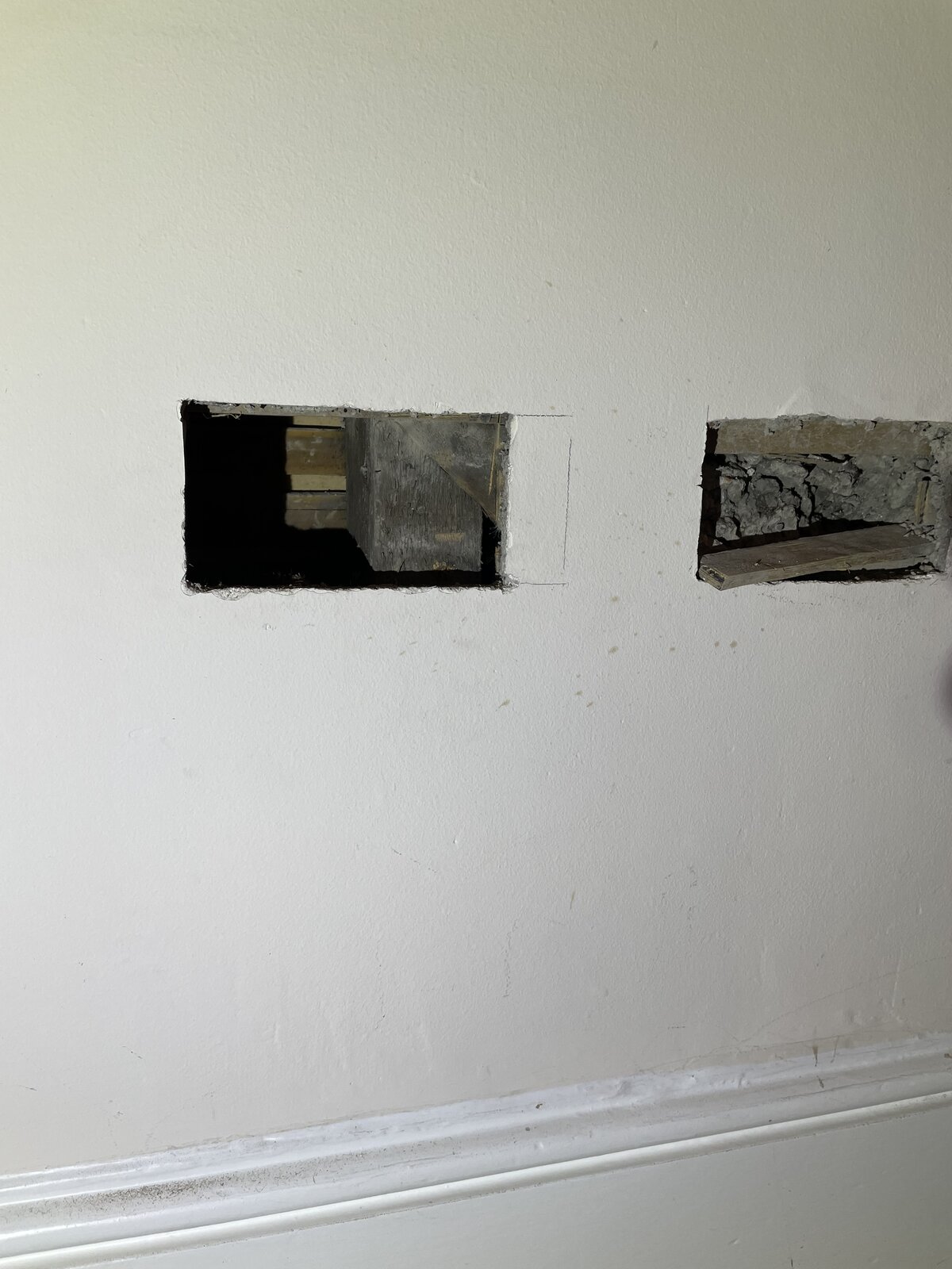

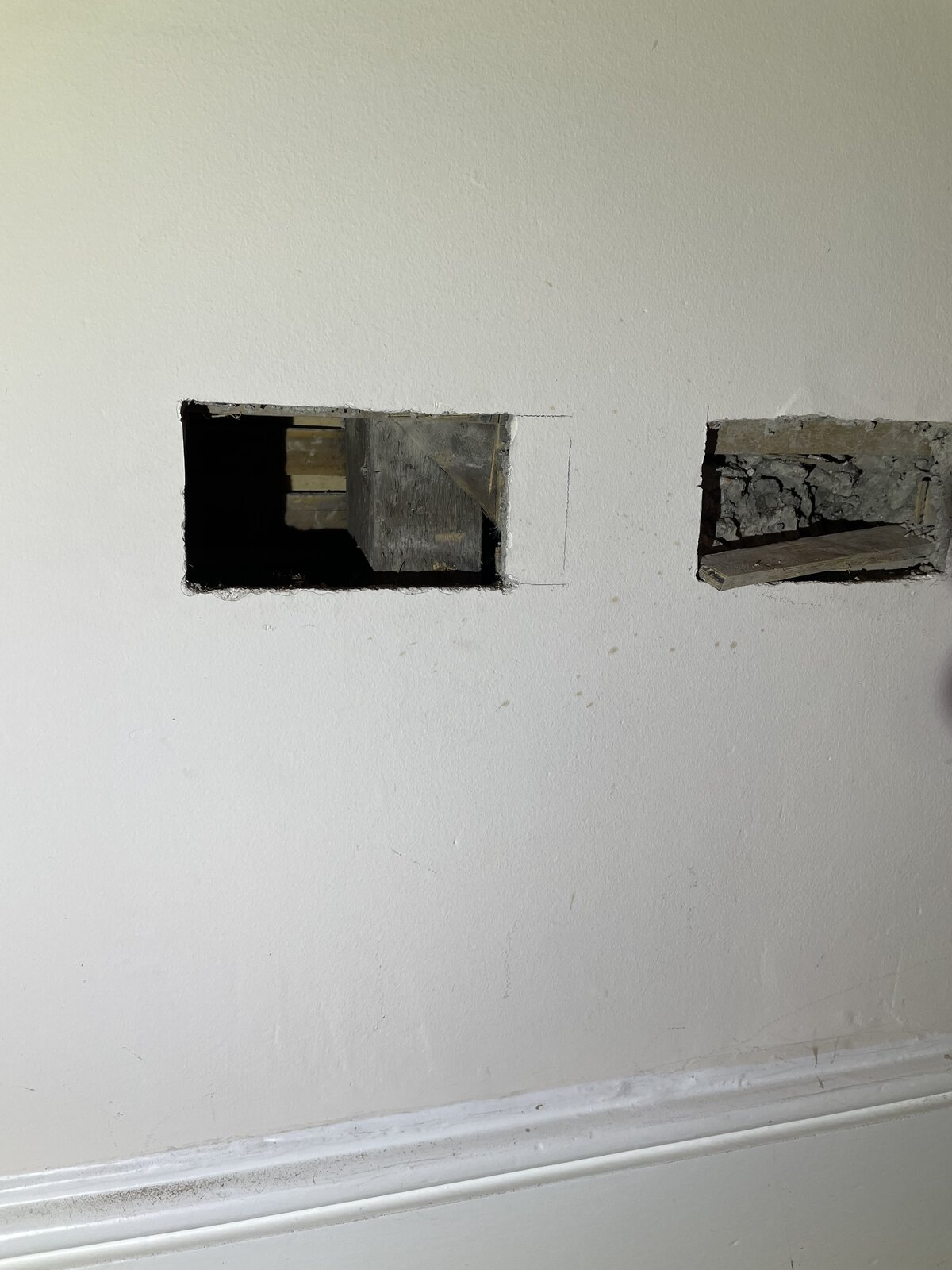

Left one is free… there is a diagonal support beam going off the stud… so probably the reason it looks like its filled but just resting on the extra beam.

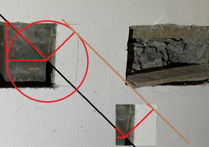

My attempt at predicting the position of the diagonal may not be perfect but assuming it's the same size timber as the vertical I don't think the brown line should be too far out.
If you had tried drilling down wards you should have reached that diagonal quite quickly, especially to the left.
At this point I'd still say it's worth trying if that is your preferred position for a socket, after all you have to refill one hole and it really doesn't matter which.
It's just occurred to me; how do you get to the void at floor level? Is it open to the floor void?
Yep. This hole thing started as by-project of us getting new flooring in the room. Flooring is only due in a couple of weeks so whilst I have access I wanted to so these things. Once done the whole room needs painting and fixing of some skirting board. I will probably get a decorator in for that though…
