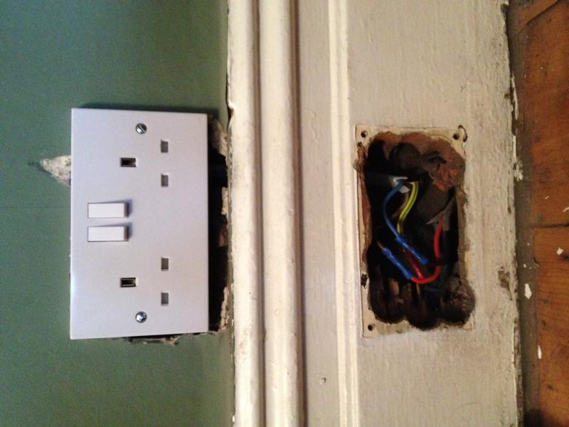

Hello,
I've just had some electric work down in a new house we've moved into. Plug sockets have been moved - from skirting to wall or just higher up the wall. One plug socket wasn't wanted so I asked the electrician to remove that one.
The work has been done but i'm unsure how to fill to hole because of the wiring. Could anybody advise on what would be the best way to go about this?
Rooms will be plastered/skimmed in the future so is this something a plasterer could sort? That would still leave me the holes in the skirting though.
I have included three images which show the various holes.

The first thing you need to do before you start filling holes is to get the electrician back and get him to sort out the non-compliant mess he's made of your wiring.
That was my first thought, but if the wires are going down into the floor, I'm not sure it is non-compliant - or what have I missed?
EDIT: Oh yes, the socket which has been removed, but the wiring left.

What about the sheath of the jointed cable in skirting?

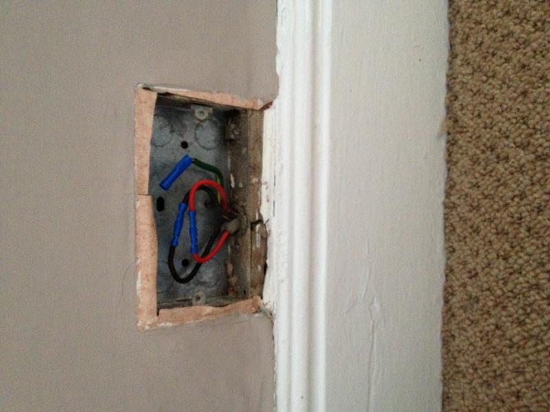

Also second pic, cables seem to heading outside safe zones.
It's a firkin mess!

Socket one. None sheathed cables out side of an enclosure.
Socket two. Not sure, but cables look to head out of a safe zone.

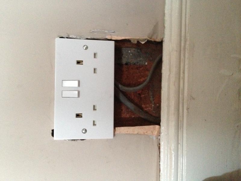

Socket three. Two wires into the same side of a crimp. Crimp wrong size for 1.0mm² / 1.5mm² wires. Exposed conductive part (back box) not earthed.
Do the wires go down into the floor directly underneath the sockets? If so they're OK.
The other one you should fit a blanking socket, or have the cables moved under the floor.

Cannot fill the third pictured socket, the cable should have been completely removed, unless this cable is dead and there is no possible way that it can be made live again, if not a double gang blank plate is required.
Oh yeah. See what you mean about the non-sheathed. It's a bit weird though because it actually is inside an enclosure.
Is that not a metal back box which held the original socket? If not - what was it?

The old in the skirting doesn't contain a metal back box.
The hole in the skirting could be covered by carefully sinking in a piece of thin wood, sanding it, and repainting.
IMO, there is inaccessible and inaccessible. Having to lift floor coverings and floorboards to get at crimped joints is (IMO) bad enough but if the repair to the skirting you suggest was executed experly enough, it would be completely invisible and would leave future observers with no reason even to suspect that there were crimped joints hidden behind that. As most people here know, I'm nervous enough about inaccessible crimped joints at the best of times - but, given the standard of work exhibited by whoever was responsible for the work pictured, I would put no money at all on how competently the crimped joints had been made!
