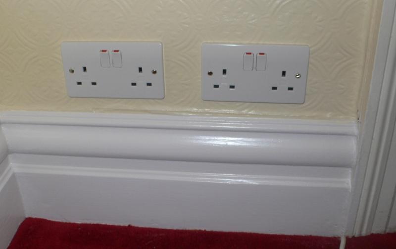

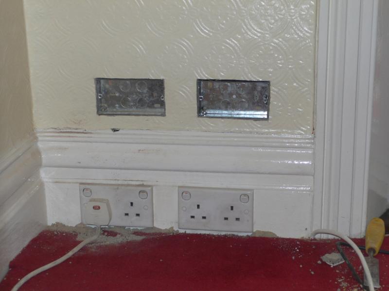

sockets moved - how to fill holes

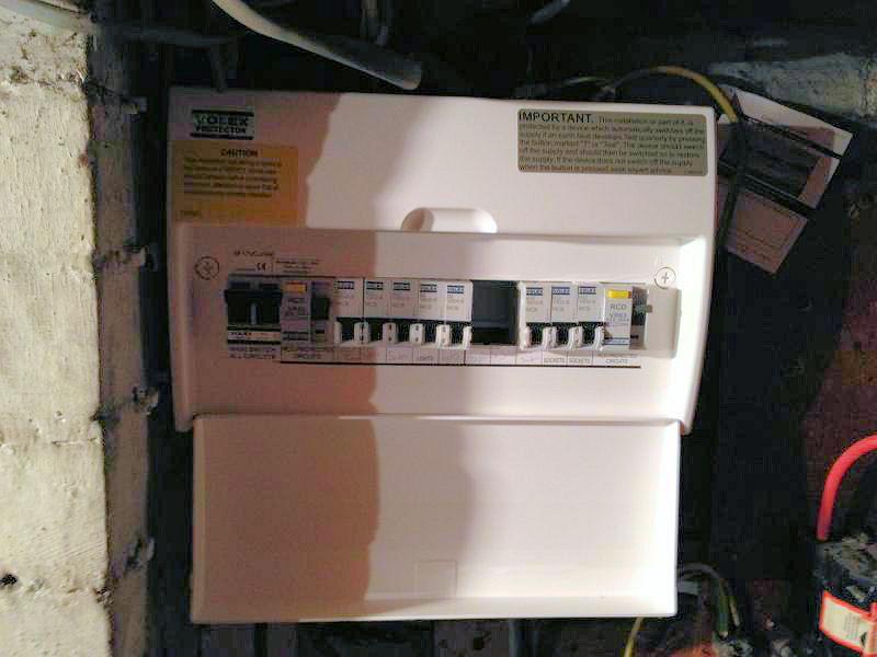

Picture with CU visor down showing MCBs, are the spares blanked or exposed?
Sorry you lost me there. How would I be able to tell?

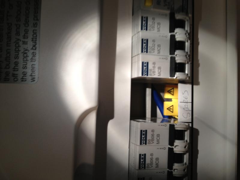

You have RCD on left with yellow test button, then three MCBs going to the right of this, then two spares with no MCBs in, these should have blank plates over normally supplied white, the picture is either shadowing there existence or they are not there. You should not be able to but your fingers in to this area.
Any better?

There is a hole there, here's an image showing what I can see inside...
It's a dual RCD but the blanks are missing so you can poke you fingers straight onto the live busbar :eek:
Also there are two henley blocks between the meter and CU.
Oh and the tails are anbomination, and the inner insulation of the live tail is exposed where it meets the henley under the CU.

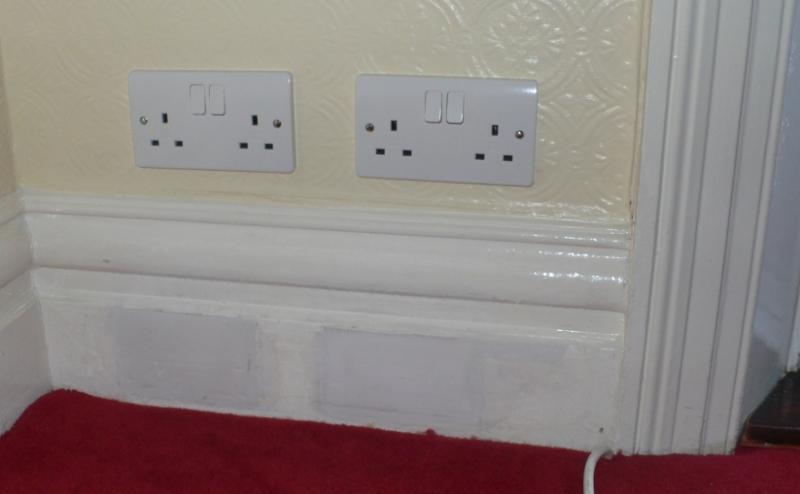

Once it's all been sorted wiring wise...
Then make wood in fills and butter the edges with no nails, set the wood in the cavity and let it dry.
If you put a screw in the middle of the wood plug it allows you to set the wood near square.
After the glue has dried then skim with a wood filler, dry, rub down, paint.
