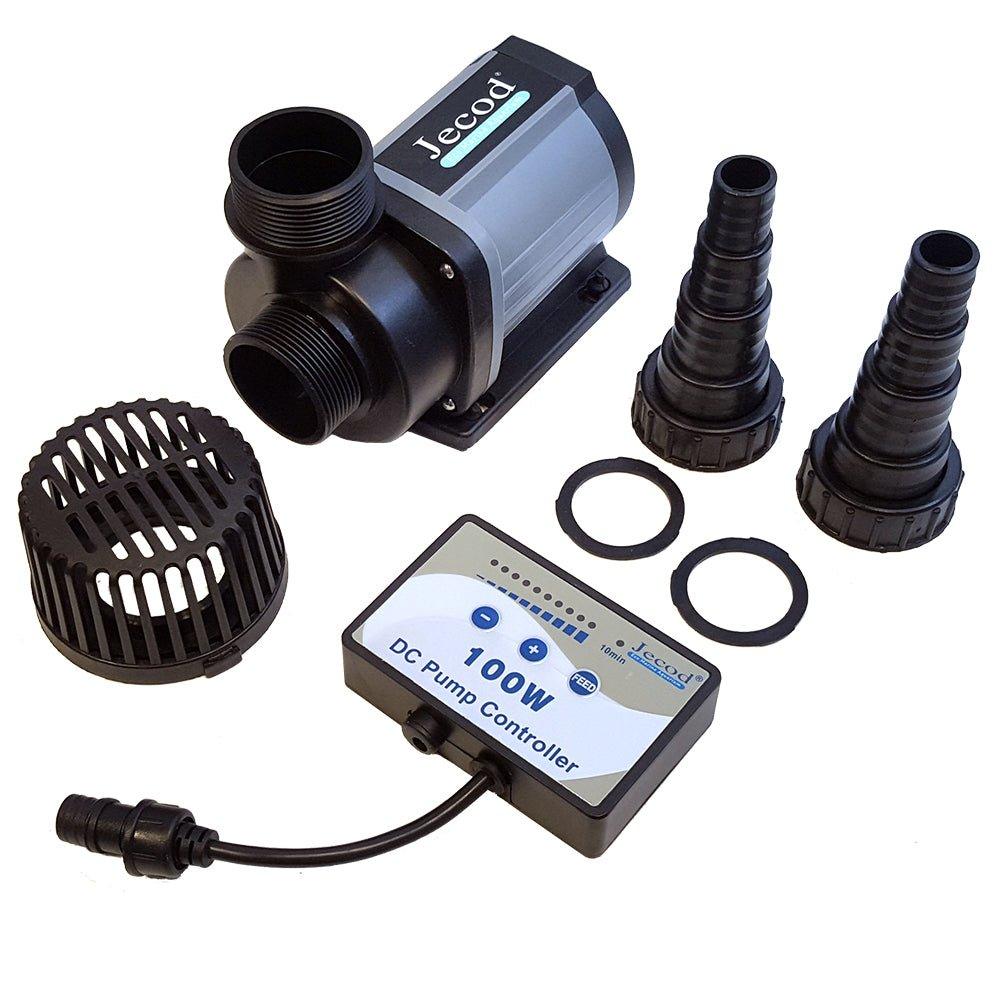

Hi guys n dolls , john here N.E. uk , I'm fitting a 9000ltr /hr pond pump to my water feature 240 volt 68 amps , any ideas on how to solar power it 24/7 until frost n ice comes around again. Get plenty of sun all yr round . any views welcomed warm regards J

hi Stephen thks for swift return. plz bear in mind I'm not a sparky. Yes 24/7 cos I'm thing of adding fish . . really unsure it said on pump twas 68 amps . i could look at instructions tomorrow and get back .

You all got me looking.
This 9000 l/hr pump
Is 65W at 24V dc
And this
Is 85W at (I presume 240V ac)

So I would look for at least 200W of solar panels and batteries (as it is dark half the time).
Quick Google suggests budget starting at £500 (not saying this is correct fit, just a quick internet search)
EDIT...... These come with only a 50Ah battery. Increase that budget as you need enough battery to last the night. Say 65W from a 12v battery over 12 hr is about 65Ahr battery. But need bigger as cannot discharge that battery to zero without damaging it.

so sorry John D 240 volt 68 w pump , I've had a hard week and me mind is on the long bank hol wknd sssooorrryyy . j

Much appreciate SFK all the effort and swift return , as u can see I'm newbie to DIYnot, hee hee ,oh and my pump is 240 volt 68 w .

Indeed. Quite a bit bigger. Regular lead acid cells should be kept above 80%, leisure batteries might reasonably do 50%.
130ah leisure battery replaced every year perhaps..
Doesn't seem worth it to me

Thks for honest feed back , might just use 240 electricity supply on a energy monitor ? polite regards john
68 watts on continuously is about 600 kWh per year, or about £200 per year if paying 34p per kWh.
Thks flameport , well after those calcs , if i end up forking out 4 to £500 quid on a solar system , i would get my money back in 2 or 3 yr of running pump yeah. mmmm kinda swaying back to a solar system ... hee hee, true regards thks for your time j
Except that you only get worthwhile solar power in the six summer months, and not every day of those, so you will save less than half your electricity.
