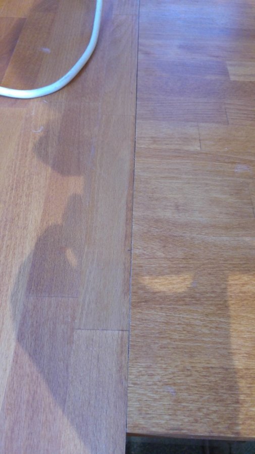

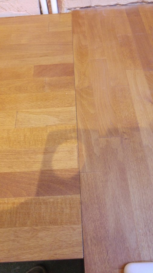

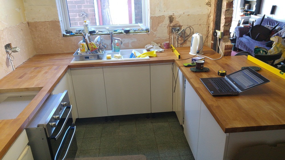

We have a 40mm solid wood beech worktop fitted in our U-shaped kitchen. Two lengths and a third breakfast bar.
The kitchen and wooden worktops were bought and delivered a year ago. Due to various reasons (including my own slow DIY skills) we have only now got to the point of fitting the worktops.
The worktops were stored in the garage originally but only for around a month before they were bought inside. On unpacking they was varying bowing / twisting / cupping on all three. Not overly severe but enough to mean the butt joints would not be exactly level in place.
Due to not having the right tools (and also not having fitted solid worktops before) we employed someone to cut and fit the worktops. He has cut all the worktops to length and also the cut-outs for the sink and hob. He initially did this a week ago and agreed he would come back yesterday to tighten up the butt joints after the worktops had had chance to settle and to see if the bowing / cupping would settle. I also weighted down the high points of the worktops over the last week to see if this would allow the wood to relax back to being level.

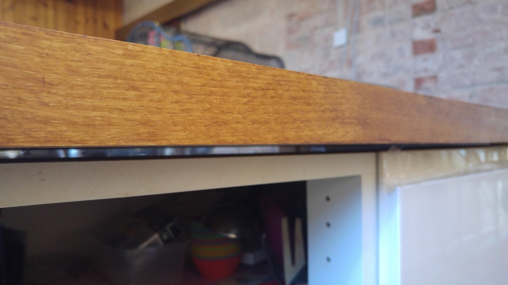

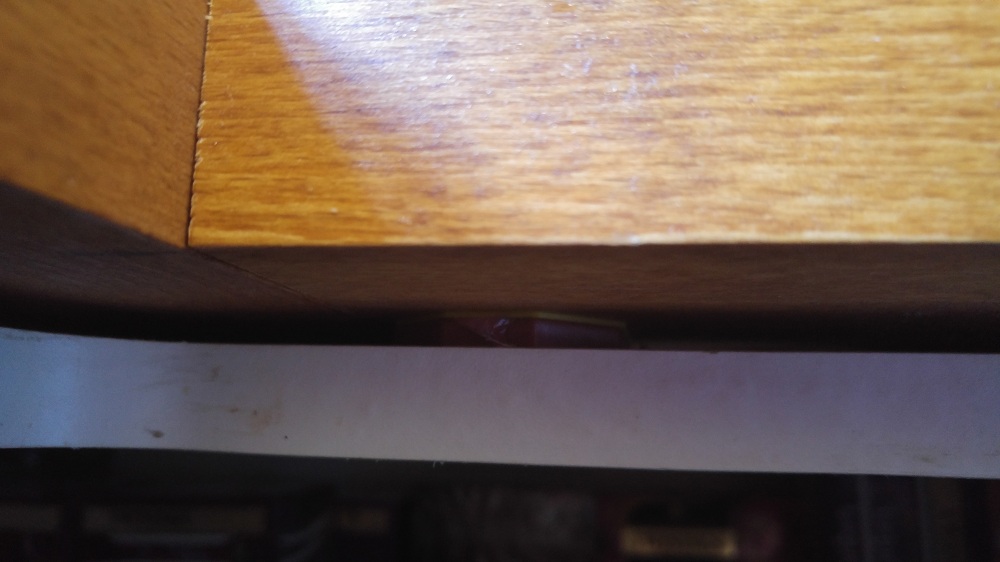

After a week it is now evident that the worktops have improved and are not as bowed as they were initially. Yesterday our fitter came back and has siliconed the butt joints and bolted them together (should they have been PVA'd?). As there is still some twisting and bowing he used some packers under some cupboards to allow the butt joints to be bolted together. He has not screwed down any of the worktops to the cabinets as I can do that (I have the right brackets with the slots running perpendicular to the grain). Though when I do this I will be either having to put more packers in so the brackets meet the worktop or screwing in and pulling the worktop further away from where it should be.
The butt joints are sort of OK but not as tight as they could be and are slightly raised in places. The fitter suggested they could be lightly sanded to bring them level.
Whilst I sort of understood the reasoning at the time I am now not convinced that this was the best course of action. In one of the worst areas near a butt joint there is a 4mm packer. For one, the worktops are now no longer level as they are packed out differently across the level worktops. Two, surely over time the worktop will potentially move more but because the packers are in place it will mean the worktop moves further away from true not closer.
I would have thought that it would have been better to try and get the worktops back to being level again. So no packers, release the butt joints, weight down the areas that are bowing upwards and potentially where the worktops are cupping upwards screw them down at the back and then clamp the front and slowly tighten them over a few weeks to bring them true.
Is this a good course of action and if so how easy will it be to separate the already siliconed butt joints? Or has the fitter taken the best course of action with the packers and we have the best outcome we are going to get?
I have included a few photos.
I appreciate any advice! Thanks in advance!!

Wood will shrink and swell with changes in moisture. It will only develop stresses if the drying is too fast, or if movement is restrained. Otherwise if it is dried back the original manufactuered moisture content where it was flat, it will recover. Basically the tops should have been re-conditioned before fitting, as otherwise you get what you have.
So whatever you do going forward, you want to make sure the tops have reached equilibrium so that whatever you do is final, don't bother mucking about until then.
What you suggest is reasonable and silicon won't act as any kind of bond.
If you do have to clamp them flat, fixing must still allow for in-service movement or the tops will split.
If you sand the joint flat, you must make sure they are now fully re-conditioned, or they will 'unbow' and you will have dips where you sanded away.

looking at the pics, If there is fresh plastering around the walls adjacent to the units this will give out alot of moisture into the underneath of the tops potentially causing them to expand on that reverse face thus making them curl up on the top.
