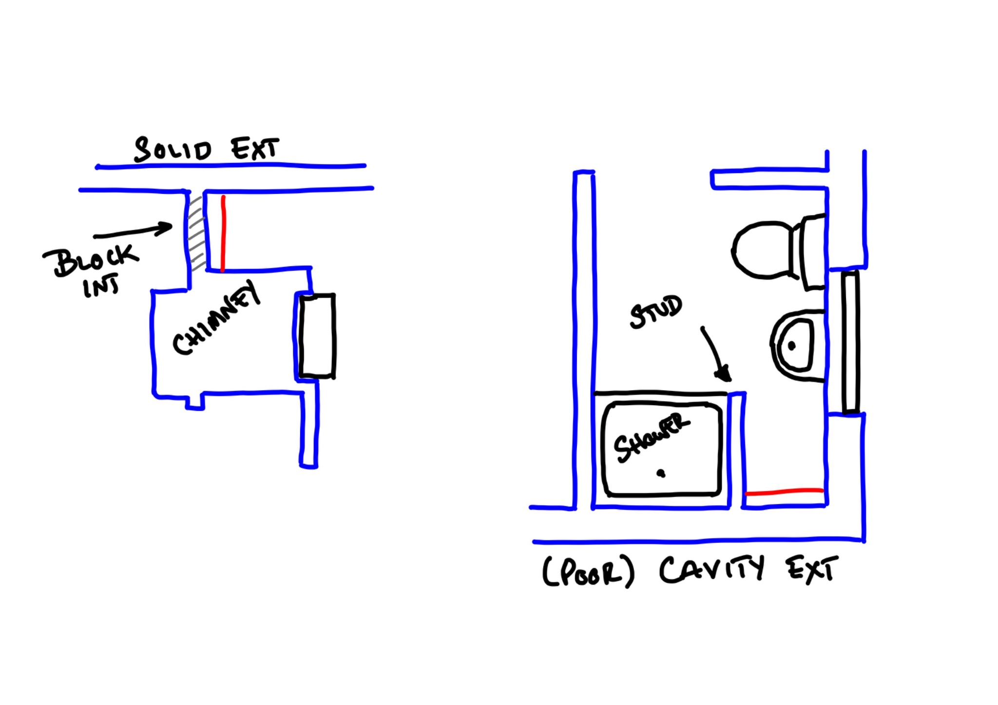

A poorly drawn sketch may help…..
The alcove by the chimney (correct @foxhole) is also adjacent to a solid external wall.
I’ve had the chimney and the alcove wall injected / re plastered with the High-Lime.
And it’s in this area I’ve avoided vinyl paints etc for breathability.
I recall (from the damp work) that the alcove wall is a single course of cinder block.
The alcove in bathroom is probably more straightforward.
It faces onto an external cavity (Northerly).
The cavity is small; maybe 50mm at most.
I can see no evidence of damp problems in this area.
The stud wall forming the shower appears plywood faced.
It’s not too noticeable as it only faces into the alcove.
The dry lining I’m thinking about is shown by the red lines in each alcove.
In both cases, this is to allow power sockets and in the bathroom; an illuminated cabinet.
Any advice much appreciated.
Thanks D

If the chimney is damp no amount of damp treatment will cure it. Needs ventilation .
I would postpone until you are 100% sure there are no further damp issues.
That’s a fair point - I’m not in a desperate hurry so wouldn’t be a problem. The damp work on the chimney was a god effort so I hope it works out to be effective. The old shot plaster was hacked off, it was injected, rendered with a good depth of high lime, skim plastered and painted with supermatt. One of the back to back fireplaces was removed and bricked up - leaving a vent. In the other one, a log burner is now installed to get some heat into the chimney structure during colder months.
As you suggest - I’ll wait and see how that all works out.
In the bathroom alcove (no history of damp) where I’d be working on an external north facing wall with minimal cavity; would I be better with batons and breathable insulation ?

Sorry for bumping this - but my plans have kinda stalled.
As advised, I’m going to park the alcove (near the chimney) and monitor effectiveness of damp work.
That leaves me the bathroom alcove (picture above) where there is no damp that I’m aware of.
I’d like to fit a (zone2) shaver point / lights etc and get the cables in behind plasterboard.
I’d be working on an external north facing wall with minimal cavity.
I could make this a plasterboard box that comes down from ceiling only to height of wall cabinet.
Full length or short box - would I be better with batons and breathable insulation ?
Thanks in advance D
