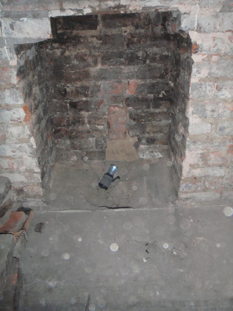

I'm now renovating my semi and on the joining wall which has two chimney breasts (4 alcoves). I am looking to:
Fill any holes with cement
Build a Stud wall joined at floor and ceiling.
Use Acoustic Mastic to seal.
Then (not too sure what to go next)
Some deadening rubber or wool
And Acoustic Plasterboard.
What do you think, sound or back to school?
The only thing that works is stopping the vibrations getting into the structure in the first instance - once in - you've lost the battle.
You can't realistically stop all sound transfer in existing buildings but you can reduce it. Seal any gaps with acoustic sealant. Gaps are the easiest route for sound. There's a rule of thumb that 10% gaps will allow 90% of sound to pass. All frequencies will pass through gaps. Secondly you need to realise that different frequencies travel more or less easily though different densities of materials. Just employing heavy dense materials will only be effective against lower frequencies. Higher frequences will still travel quite easily. (think prisoners tapping out messages on steel water pipes) Good sound systems will employ both high and low density materials and also at least one cavity.
If you look closely at this photo of the chimney breast, you can see a single span brick wall, loose bricks and yes that's the neighbours plasterboard......
Not exactly sure what has happened when the removed their chimney breast.
Going to have to tackle that somehow.
Probably rebuild the wall/hole.
Then cement up the back of the fireplace as putting in a log stove.....
The wonders you find during renovation
