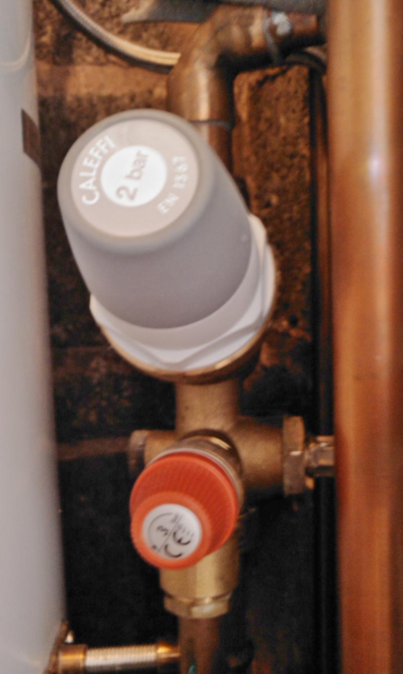

This is a photo that I took of the actual part.

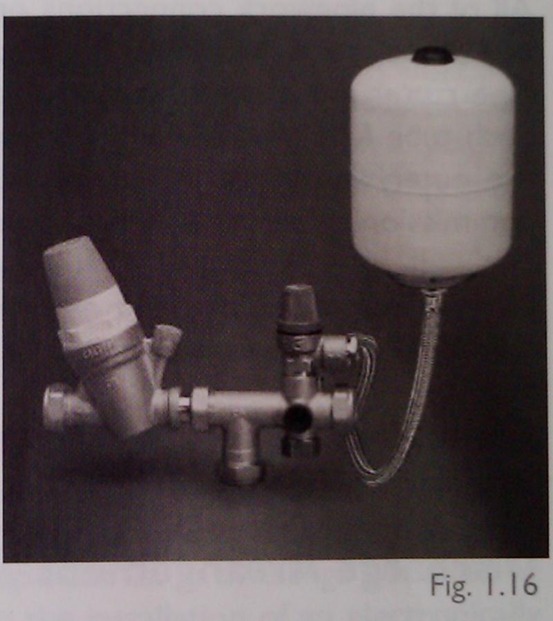

And this is taken from the instruction book.
I'm now suspecting that it is a pre-plumbed unit and the company "Kingspan" are not willing to share their controls with any other!

Is there no part number in the manual? What's the cylinder?
Mathew
No part number, just a phone number (which usually means your going to get ripped off big time).
Non the less I'll give them a call tomorrow.
The cylinder is a "Range Tribune HE".
I'm beginning to think that they want the customer to take out a service contract with them and are unwilling to supply independents with spares.
