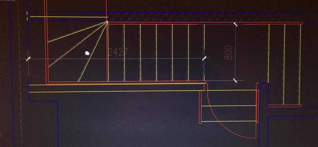

Space saving stairs
I've got a designer drawing it up

Sorry - wasn't meaning to be dismissive, but really your 'designer' is clueless and it's frustrating seeing cock-eyed advice being peddled.
In a nutshell; 44° is OK; you can have 4 winders; you can narrow the stairs if it helps, etc etc. you/your 'designer' just need to be a bit more creative. And no, you don't want to gain a bedroom on top only to loose one below - some companies will just do the easiest and tell you this or that 'can't be done' or is 'against regulations'.

I wouldn't consider going into the other room, by the time you have compartmentalised the stairs there won't be much left. can you put a winder box at both the bottom and top, what's your floor to floor height and the total going you have to play with and pitch of your existing staircase in the house. As Tony says BC would probably look more favourably on a steeper full staircase over a space saver. Also you will probably find a space saver a pain for anything other than occasional use.
Really high ceiling so 3m rise but the room where the stairs are going will have to have a small step down from a mini-landing ( I don't fall out with this because the rest of the house is a but up and down levels so its will feel original from a design perspective .....
The higher the stairs the better as there is going to be a recessed area under the stairs big enough for a single bed.... like a cabin style.
Will try and post a sketch but this might give you a general idea.

Actually .... that view is old ... there only two risers at the base not 3 ... total 14 risers
Existing stairs 43 degrees
BTW your loft stair only needs to be 600 wide not 800 so that's 200 saved going by your dodgy drawing already.
Where you've got the winders, they wouldn't in practice come to a point like that - they would converge on the newel post. This means that the run will be longer by the thickness of the newel - usually around 100mm.

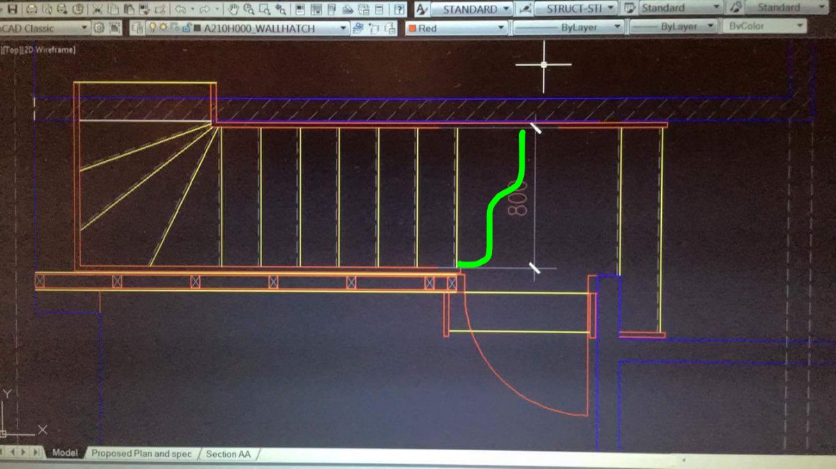

When I said earlier about a first tread is this feasible ? If we nudge the stairs back a bit can I have a leading shaped step on the first tread so it's clear of the door way but also buys another rise ?
