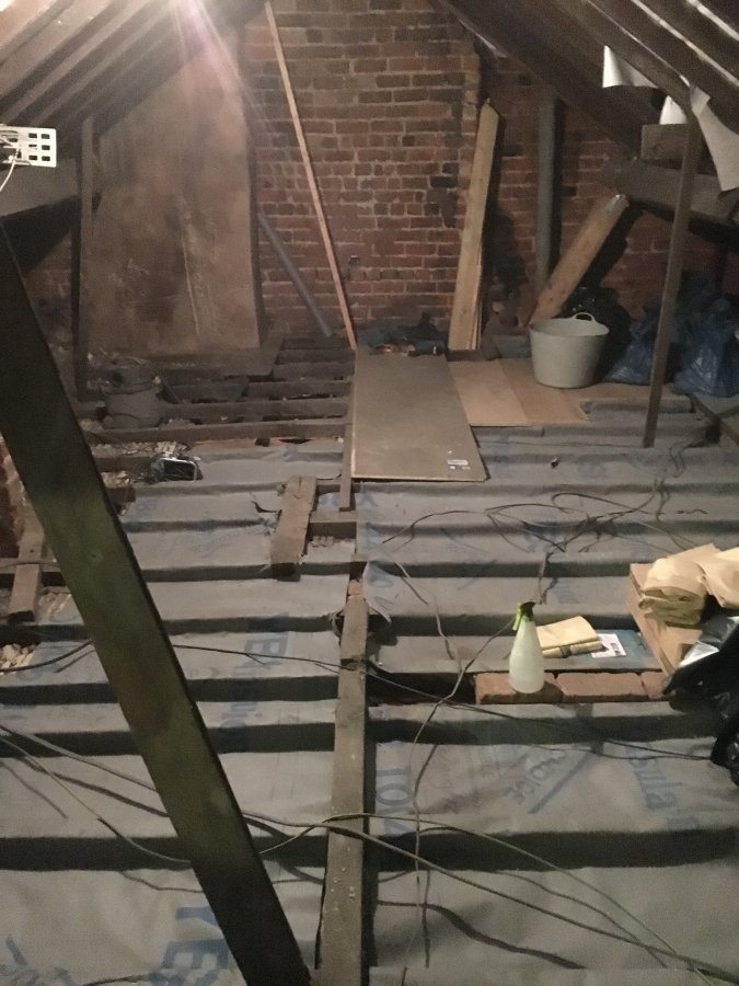

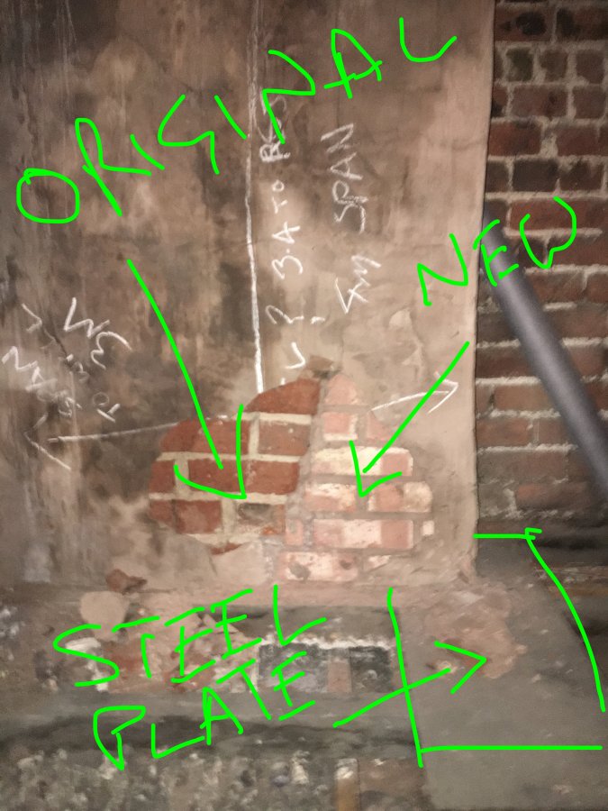

A floor plan with dimensions, including changes of levels would be useful, it's hard to understand exactly what is going on with the steps at the end of the stairs and the ones by the door. You could oblique the tread you have shown oblique. If that plate is just sat on the joists then no it's probably not supporting much, get shot of it if it gives you more space, as said before that bit of new brickwork isn't really doing much especially if the plate is sat on the ceiling joists

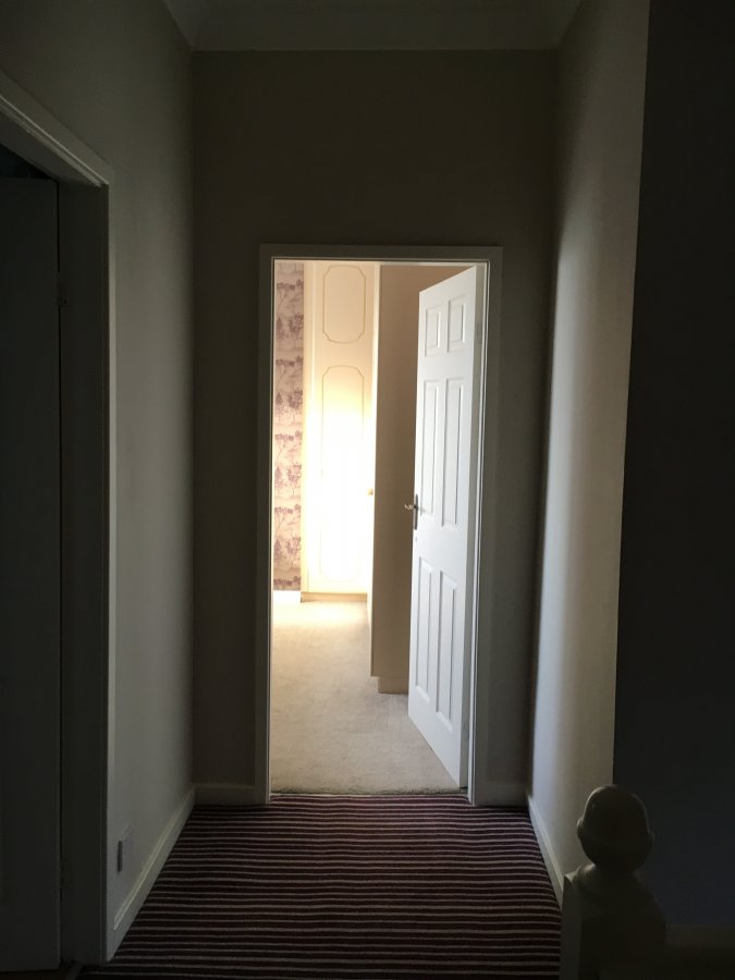

This is outside the room looking in currently ... The stairs are going where the wardrobes are and a partition wall to divide the room ( with a the right angle door into this room on the left )
The extra two steps and little landing are required because I haven't got the run to get up to the high ceilings. They will be outside this door and this door will be knocked into an archway to match another Victorian arch in another part of the house.

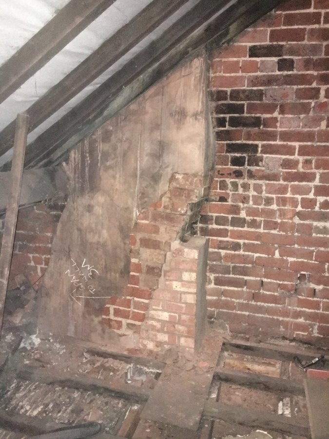

Update .... the SE has been round and said to take out a few coarses and look what's going on .... It seems the corballed brickwork has been repaired and this metal plate some kind of bodge job support :(

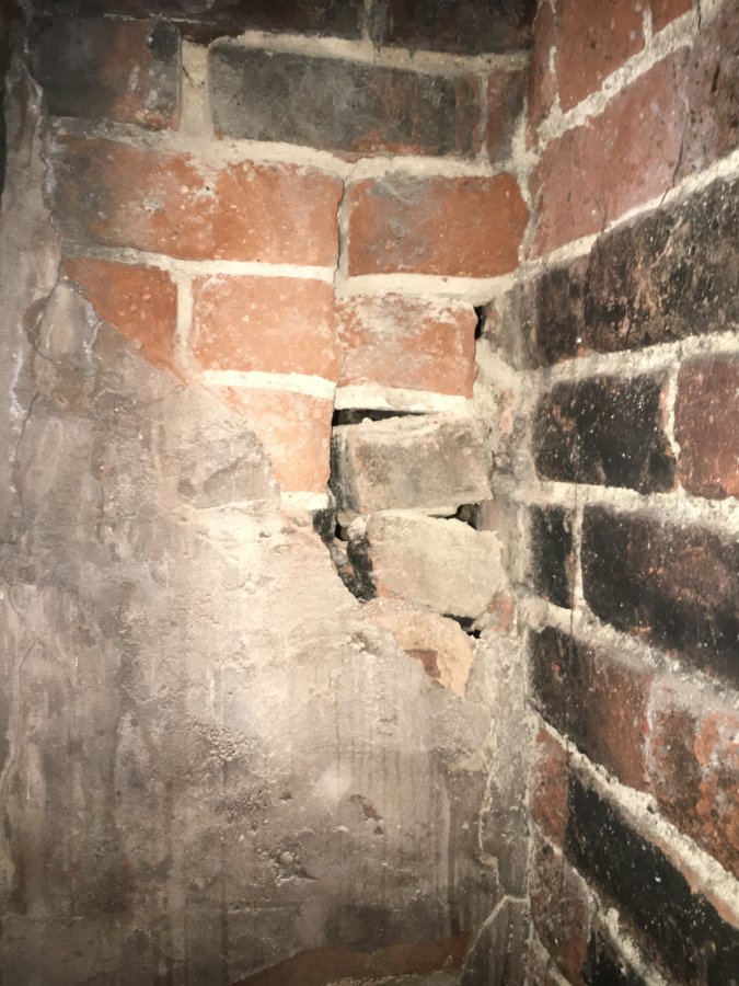

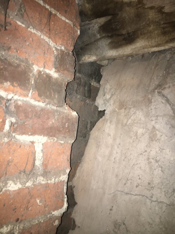

Knocking the plaster off I see there's a dirty great hole in the chimney, nothing is keyed in to the wall and the mortar is crumbling !!!
The SE is away for Easter .... What you dudes reckon should be the plan ?

If all the problems with the proposed staircase is due to this steel plate resting on the ceiling joists (which in itself seems highly dubious) then surely the best option is to get rid of the steel plate? It appears from the later photos that there is minimal tying in between the chimney breast and the party wall (not that uncommon) so maybe installing some stainless steel ties, something like the helifix ties, would stabilise the chimney breast enough to remove the steel plate. Alternatively to provide some additional support to the corbelled brickwork maybe a gallows bracket? In a nutshell, address the issues with the chimney breast rather than trying to bodge the stairs.
Thank you... That's very much the plan but that remedial brickwork needs to come out to fit the stairs in ....
It's clearly not a professional job so maybe it was just built to support the corbal while it set ? I've no idea but it's dodgy to say the least.
the problem with helifix is that the side walls of the chimney don't structurally exist ... There's nothing on the one side and huge holes and loose brickwork in the other I have the gable side and the front is questionable
I was thinking maybe a two gallows brackets either side and a steel plate to sit the brickwork on ?

Options.......You could repair/rebuild the chimney breast/stack; remove it completely; insert additional support in the form of gallows brackets or steel beam etc.

Option 2, prop the stack and rebuild the dodgy corbelled section, tying it into the gable wall at the same time.
It looks like the previous repair is a complete bodge and probably someone over reacting when they noticed the differential cracking and loose brickwork in the chimney breast in the loft. I am usually very cautious and there is nothing I can see in the photos that would cause undue concern.
