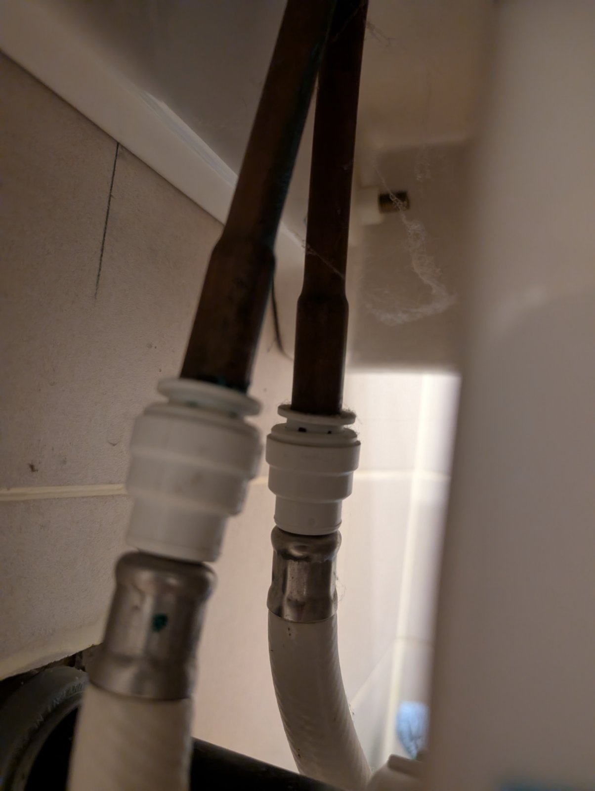

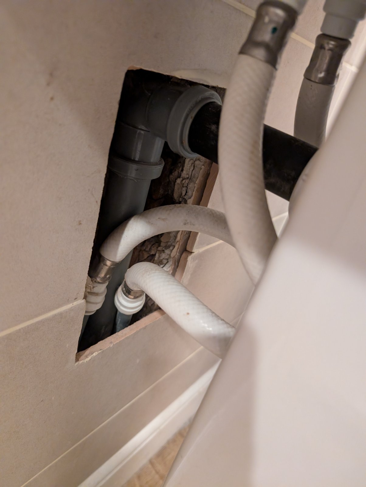

I need to fit a new basin tap onto the pipes in the photos, and I'd like to split the cold feed so it also serves a washing machine, as well as include isolation valves (none present currently).
I'm completely new to Speedfit so would like some advice on the best way to do this and what valves/tee I need.

You need to sort out what tap(s) you are going to fit first. They way they connect to the pipes will determine what you need. Most, but not all, taps these days come with flexible connectors.
Already got the tap (should have said that!) and it's got flexi hose connectors (3/8 inch so I know I'll need an adapter to connect to 15mm, just not sure what else I need)
Oh dear, well the first issue is the flexi pipes that are already there. Ideally they would be replaced. The run rigid pipe out from the plastic in the wall and clip it properly if you are looking to add an appliance tee. You really want to secure/support the cold feed that the tee will be on as a fill hose can put a bit of strain on the valve and pipework due to its weight and length to the appliance.
