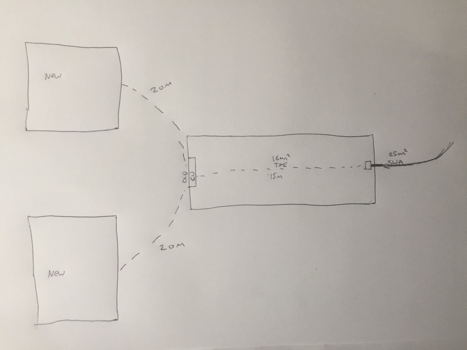

I have a 16mm2 t&e feed going to an outbuilding which feeds an old MEM fuse cartridge CU. This is being ripped out as the building it covers is being tossed. Two new outbuildings are being built adjacent so I was planning to fit a new CU in each building splitting the 16mm2 supply to each CU.
What’s the best/tidiest way to split this 16mm2 supply, have it safe and ready to feed the other two buildings? Must be IP rated. Supply is protected by 100mA RCD so I was planning to fit 30mA RCD in both new CU.

Is the cable long enough to reach into the first new CU? If so, connect at the Main Switch and Earth bar.

No. It doesn’t reach. I prefer it on the existing wall away from the two new buildings. The two new buildings are either side of this one.

No t&e is outside. SWA underground and enters the building at the rear via the roof space. The swa is glanded into a metal box and joined in it with this run of 16mm2 t&e. The route to the old cu is a nightmare hence why they used t&e.
Just an awkward layout. Maybe in the future I’d knock this one down with the digger and have a straight run to the CU.
Seriously, how far is the SWA joint from the two new sub board sites?
I might be tempted to run two new SWA feeds from this point. How big is the SWA and what is it protected by other than a 100mA RCD?

Darkness...can you take some pics or draw a diagram to explain proximity, positions etc...?
I didn’t get the cover of the metal box but first looks, it could be 25mm, but 16mm if not.
Just wondering would I be better to just stick a new weatherproof CU in and fit a 100a Isolator. Then just branch from a 32a mcb etc to each new building?
At the end of the day, this CU will give me the option to add a light in this building and maybe a socket. Could make this a split board.

Is the swa being fed from the CU in the house, and if so, what is the protection for it? (32A mcb, 20A etc)
If not fed from the house where is it getting it's power from?
