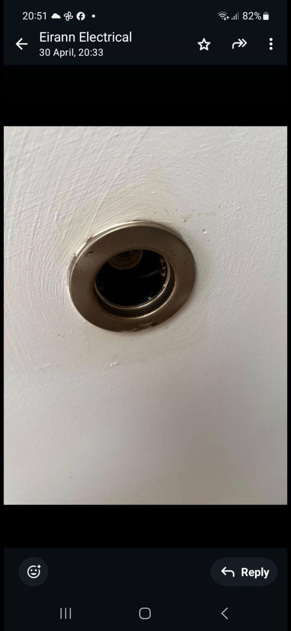

If there is spot light in kitchen with bedroom above do these need to be fire rated.
I have attached pic amd can appreciate the spot has no bulb.
If the answer is yes they do need to be fire rated to pass a EICR then can I get pladtic spots as I am reading of sone other topics there is no earth on some old spots like this. So would getting plastic spots get around this problem if once the spot is removed it is the case of there no esrth connected ?

I had an EICR carried out on a rental property and it was marked unsatisfactory. The report gives C2s under broad checklist headings only, rather than clear written descriptions. It records 5.18 “condition of accessories” as C2 and 5.19 “suitability of accessories for external influences” as C2. The electrician later said the actual required remedials included a landing socket not securely fixed and kitchen downlights not IP or fire rated. The loose landing socket seems straightforward, but I am unclear about the kitchen downlights because the EICR itself does not specifically state “kitchen downlights” or explain whether the issue is IP rating, fire rating, damage, missing lamp, or exposed parts. Also, if the kitchen downlights are being failed as non-fire-rated, the EICR has 5.13 “fire barriers, sealing arrangements and protection against thermal effects” marked as Pass, which seems inconsistent. There is a bedroom above the kitchen, so I understand fire-rated downlights may be recommended or required, but I am concerned the EICR is not specific enough for another electrician to clearly match remedial works to the C2 observations.

Assuming a 2 storey house the kitchen spotlights don't need to be fire rated.
The only place they would need to be is in an internal garage with a bedroom above. (But who has spots in a garage)

I consider fire spread has nothing to do with an EICR. As to electrics starting a fire, yes, but as to spread of fire, it is hard to say missing metallic cable retention or holes in walls or ceilings needing fire stop etc, is required.
I at first considered an escape route to be stairs, hall etc, but an official escape route will have no carpet, or any other flammable items in the route except for lighting. So to work out when and where flameproof fittings are required, is beyond my remit as an electrician.
To advise not to drill a ceiling or to fit special lights is hard, as today many MR16 replacement bulbs are made of plastic, not glass, so any fire spread would need covers over the fitting to stop spread. So only integral lamps could have a fire rating, as only then are you sure glass can't be replaced with plastic.
