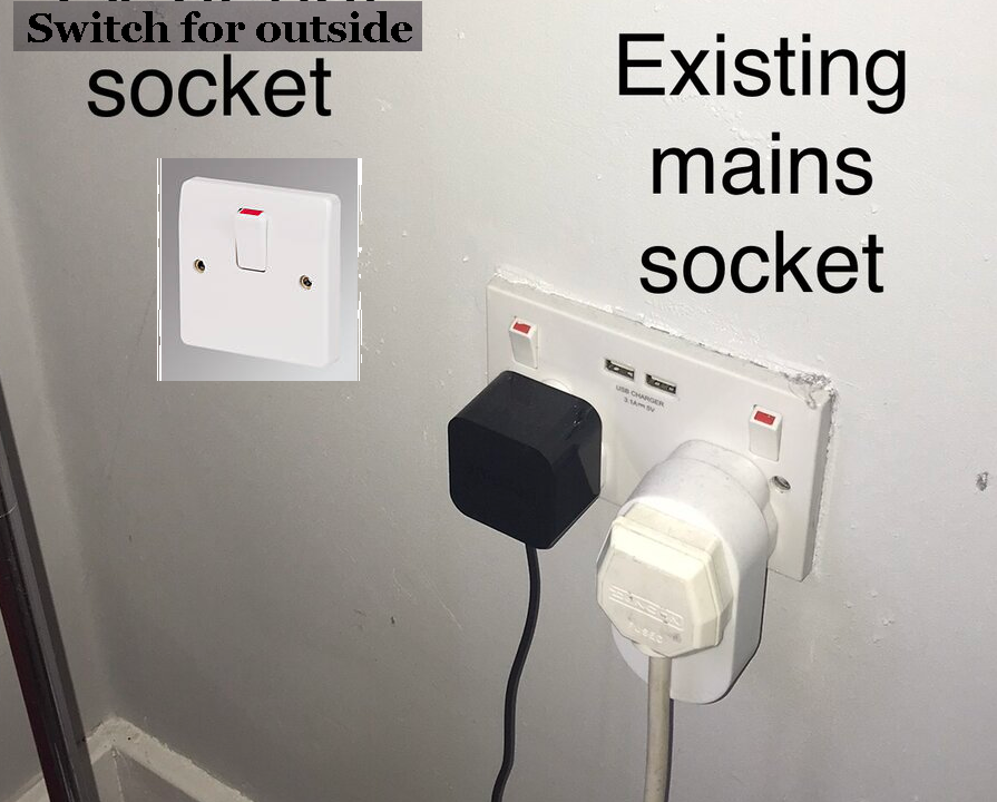

    825EFF7F-486D-48E4-BBF0-2A8CA186BBDB.jpeg Hi.
    I would like add an additional double socket in my lounge as a spur off of my current one.
    I have an unused coaxial tv socket next to it which would be an ideal location as this will never be used in the future.
    I would be getting an electrician to do this, but what do I get him to do with the coaxial wire that will be left in the dry wall ? Does it need to be capped off or does it just sit inside the wall not causing a problem ? Or do I get a connector put on it as if it were going into a tv, just sitting in the wall, rather than the bare wire ?
    One of the new sockets will be to feed an outside socket for a string of fairy lights around fence and for pressure washer etc.
    Do I need to do this from a rcd inside socket or not needed as I have rcds on the consumer unit ?
    And with regard to max power on the spur, does the new and spur share 13amp max or is it 13amp for each.
    Sorry for all the questions but only a lay person, hence why I will get it installed by a professional.

    For a start it that is a dry wall it is probably just as easy to include the new socket on the ring rather than make it a spur.

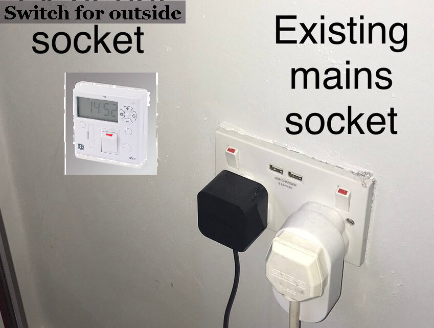

    Secondly is there a reason you wish to plug the outside socket in? It's generally better to permanently wire in, If you are only doing this for the outside socket and you wish to switch it on/off from indoors I'd personally install a switch or FCU:

    Or with time switch:
