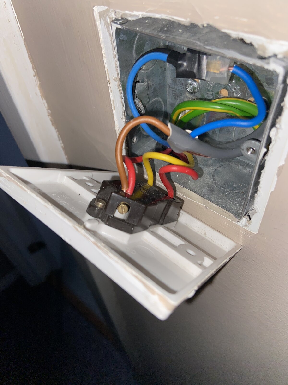

This is the set up at the top of the stairs

Fraid you can't pick a permanent live due to the arrangement of the switch. You'll have to take it from another switch or from a light fitting.

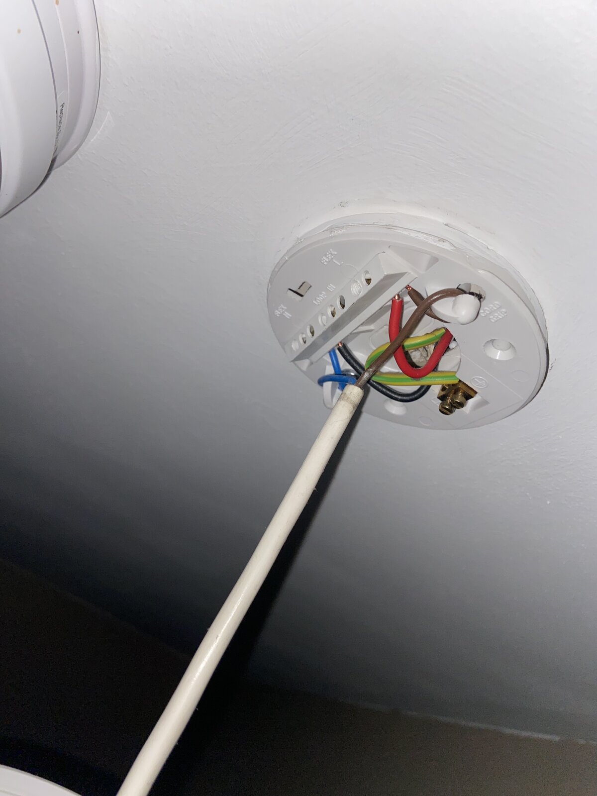

That’s the light fitting

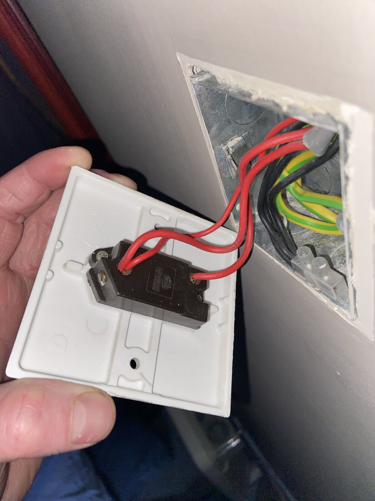

That’s the bedroom switch

Yes, you can connect the new switch from there. New switch live from the common terminal and neutral connected with the black wires in the terminal block. Don't forget the earth wires too.
