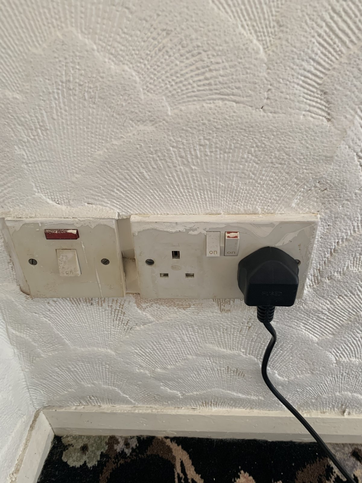

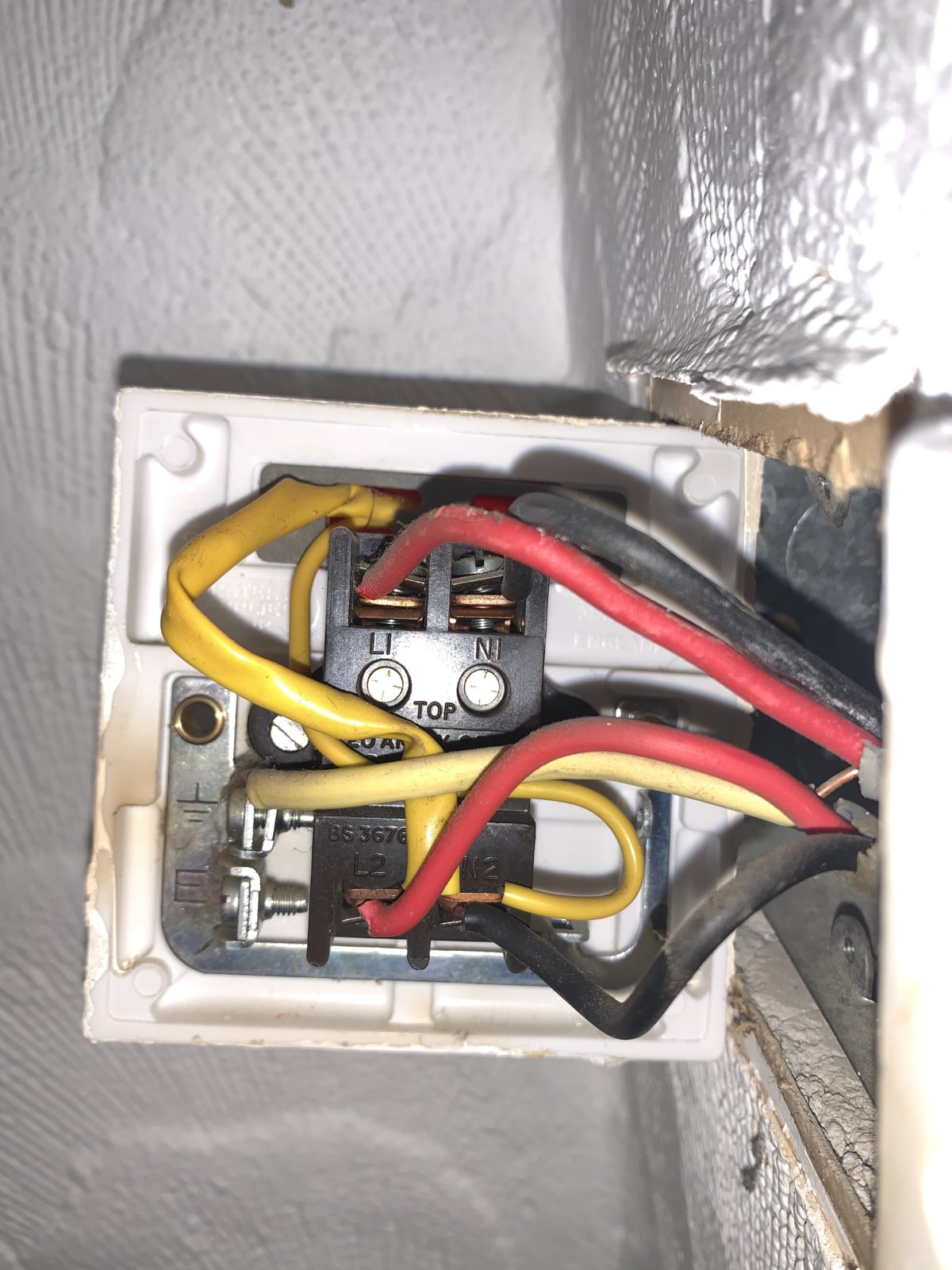

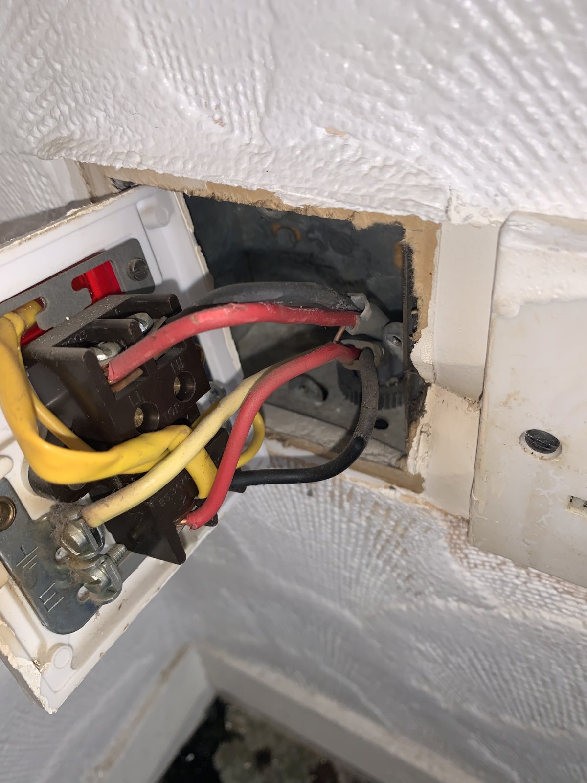

Here is a pic of whats there just now. The socket on the left is for an old electric fire that used to be in the house before I moved in. It is in the fuse box in the kitchen marked up as “fire point” and is 15A. Im assuming that it has one cable coming in from the mains, and the other is going out to what was the old fire? Not sure where it goes as theres now a gas fire there so I assume its been terminated at the other end when gas fire was installed? Although it still lights up when I switch the switch on. Could this be something I could incorporate for my situation, as in could I run cable from that up to my new sockets?
