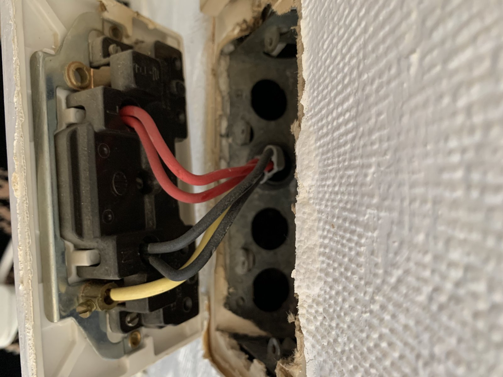

Was just wondering if its fine to run an extension lead under my floorboards? Only reason I ask is Im half way through building a false chimney breast, but cant get a sparky in because of obvious reasons and would really like to get it finished. Plan would be plug it into socket, run straight down through floor board, then along and up behind false wall so I have plugs behind the TV. Im in a bungalow so getting under floors is easy.

Here is a picture of the sockets that are either side of where the new wall will be...
Hmm. Only testing with a test meter can confirm what is going on here. It may be that the first socket is a spur and the second is a spur off the first (not correct).
it may be that the second socket us a spur from somewhere else and the first is just a socket on a ring final.
if could be that the whole thing is a radial circuit. Lots if maybes.
you need an electrician to be sure if you are thinking of permanently extending any of that wiring.
In the meantime, go with your first thought, extension lead run under floorboards. At least then the current is limited and you can unplug it if something goes wrong.

What size breaker powers the socket circuit? 20A 32A ?
What have you got to test with, even a bell and battery is better than nothing, the main thing is work on the mm² rating not the current stated for flex, as flex used as flex is always in free air, but under floor boards etc it may not be free air so current rating can change, but 2.5 mm² flex and twin and earth can both take same current, we used twin and earth because it is cheaper.
But @AndyPRK asks size of protective device, and @Taylortwocities also asks about testing, so until we have some answers hard to advise, the problem is 2.5 mm² is often rated 20 amp but a ring final is often protected to 32 amp so it needs to share the load between two cables, so need to test to insure either a 13A fuse or MCB of 25A or less is limiting current or it has two cables.
