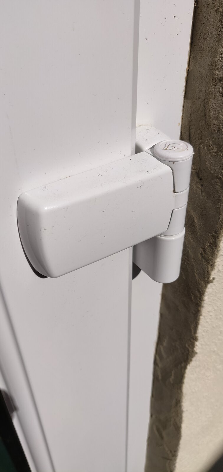

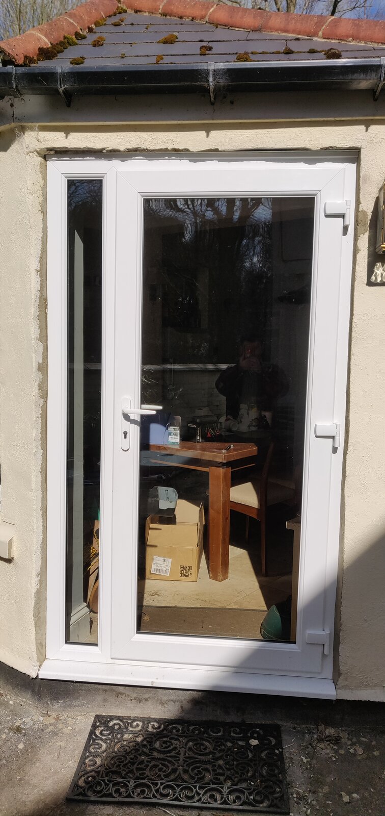

We had this door installed 6 months ago to replace an old one (click for larger image).
It's developed quite a nasty squeak, as far as I can tell on the middle hinge only.
I can see there's a little access cap on top so my first thought was simply to add a drop of light oil but this hasn't helped.
Is lubricating this sort of hinge advisable and if so what do I use and how do I access it?
Hinges are supposed to lubricated, try some silicone based grease.
Blup
I would just take the cover off to get access and see what result you get.
Blup
Hi - I have the same hinges and the same squeak. Did you manage to sort it out?
I did try to access and lubricate but with limited success... it seemed to stop doing it over time however that may simply be the cooler weather, we'll see if it comes back in the summer! So, not much help I'm afraid :(
These are patriot plus hinges, take a close look at the round top caps with the Trojan helmet design and note there is a join in the cap, remove only the top and squirt some oil in there, fill it up and then work it in by opening and closing the door
