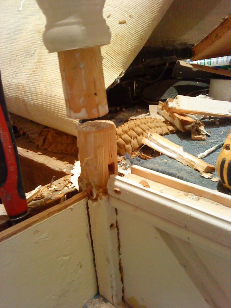

Just uploading photo from my phone guys Im beginning to think I need a new newel base and bolt it to the joists, but I have to get the old newel base out.
Will have the photo soon
Ok Here it is, I've removed the split wood and this is what Im left with
[/img]
If the dowel sticking out the floor is sound you should'nt have any major problems. Try looking for somewhere local that stocks Richard Burbage stair parts. Could be that's what you've got which would make life easier than having to drill your own hole. Take the split bits with you. It might help suppliers identify the model you've got.
Hi thanks for your replies beginning to think its not going to cost me a small fortune. The dowel out the floor is sound and originally there was timber round the dowel from the floor which allowed the newel to sit in. So the newel and dowel from the floor are fine just need to Add some glue and bigger screws. I think the part you mention is like a metal coupler? Could i make a box section around the bottom of the newel and top of the dowel which will then allow the newel to sit in again but would it have the strength?
I was also wondering - wouldn't be easy but if i had a block of wood with a hole all the way through the wood could sit on the dowel and then the newel can slot into this coupler
Yeah - thinking about it the pre-fab posts I've dealt with have a dowel on the bottom so you'd need a base with a hole in both ends to make an adapter for the peg sticking out of the floor. You could adapt on of these to do the job maybe.
Well I did it, got a piece of 69mm x 69mm timber cut a piece 160mm long and drilled a 52mm hole through the middle, had to get the hammer out to tap it on and split the dam thing.
Had another go, this time drilled a 56mm hole, the block slipped onto the dowel from the floor and I've glued it and screwed through to the dowel.
It feels sturdy apart from I can twist it ever so slightly, but the dowel appears to be twisting with it - which would mean my block of wood is doing what it needs to do?
I can't however work out how the dowel could twist, I've even added a couple of coach screws through the joists and into the dowel
