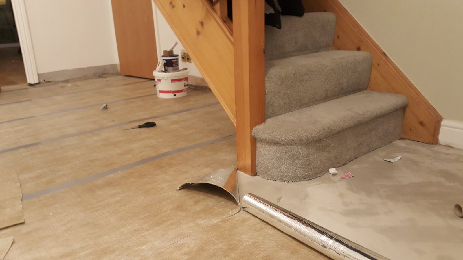

I'm laying a 18mm engineered floor and have got to the stairs and unsure how to do the detail around the bottom step.
Ideally I'd like to undercut the bottom riser and slide the floor underneath. I assume the post next to the riser / bottom step is likely to be structural but what about the riser itself?
The staircase is open underneath so I really don't want to weaken it. See photo.
Any help appreciated!!

Take the carpet off the riser first, and have a more detailed look at it, but I wouldn't be inclined to touch it as the stairs are often resting on the ground. It should be safe to cut back some of the wall string, but might be worth putting in a couple of bolts in the string underneath the stairs to play safe. Oddly enough, the post isn't that structural, as it's holding up the handrail, but it'll be fixed to the outer string, and fixed into the floor.

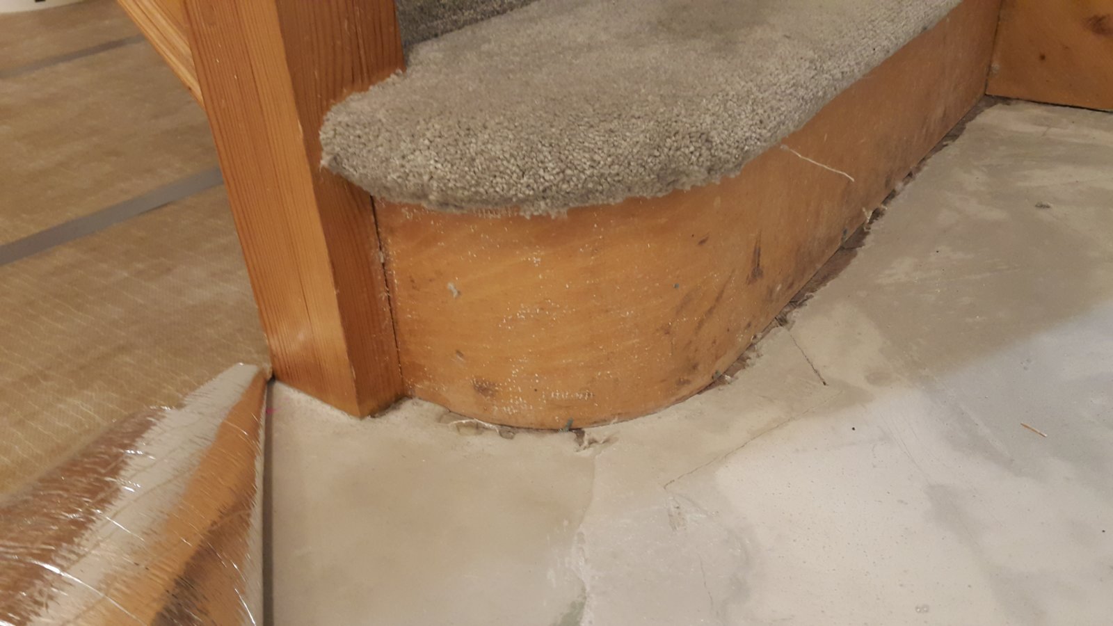

Ah good idea!! Doh why I didn't think of that I'm not sure. Carpet off and the riser just looks like thin ply bent around.. it's not sat on the floor as there is a gap and it gives when pressed.
I guess I have my answer.. should be safe to cut?

It's going to be providing a degree of support for the tread, so if you cut too much off of it, the tread will drop and creak when you step on it. Engineered wood doesn't expand and contract as much as real wood does, but you've got to allow for it. You'll need to obviously cust a little higher to get the wood underneath, and then possibly glue or fix a piece of wood behind the ply after the the floors in. Use spacers to support the tread in the meantime.

The newel and the strings are the structural parts, but the riser is providing a connection to the steps above to stop them bending and give rigidity reduce deflection at the nose. You can always glue another one behind with Pu glue and screws, then loosen the front one from the floor. But stairs generally shouldn't be messed with too much as most parts are there for a reason.

Sounds like I'm OK to undercut 23mm of the ply but beefing up the back of it with extra support wouldn't go amiss. I'm going to scotia bead around the newel rather than cut into that post. Same with the string.
Started cutting and noticed about 1mm flex when stood on the step. Lost my bottle and decided I'll live with a Scotia than run the flooring underneath!!
Don't bottle out yet, jut take it carefully, and you should be able to leave there after the floors been pushed under. You may need to notch the floor around the cable, but as long as you're careful, then you should be fine. See if you can find out where the cable goes, and see if it's redundant/not needed.
