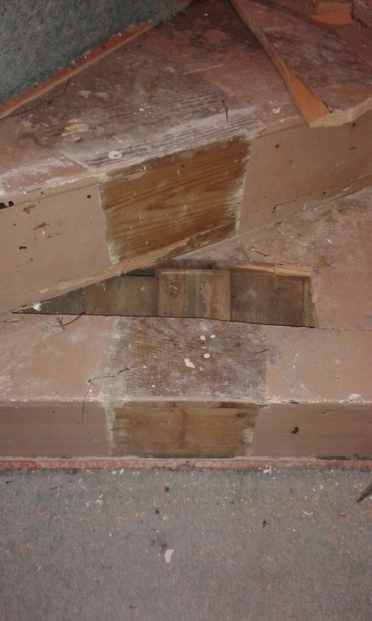

Hi
One of stairs was split so i cut out a section, now wondering how to fix it, any ideas appreciated, thanks
See photo which should explain better
Can you fix horizontal bearers under the existing tread Tony......sort of half and half if you see what I mean - so you can screw to the existing and still support the new patch? 2"x1" timber should be fine.
John :)
Yeah - I was thinking the same but didn't want to influence - the existing stuff is solid so should be OK - thanks
