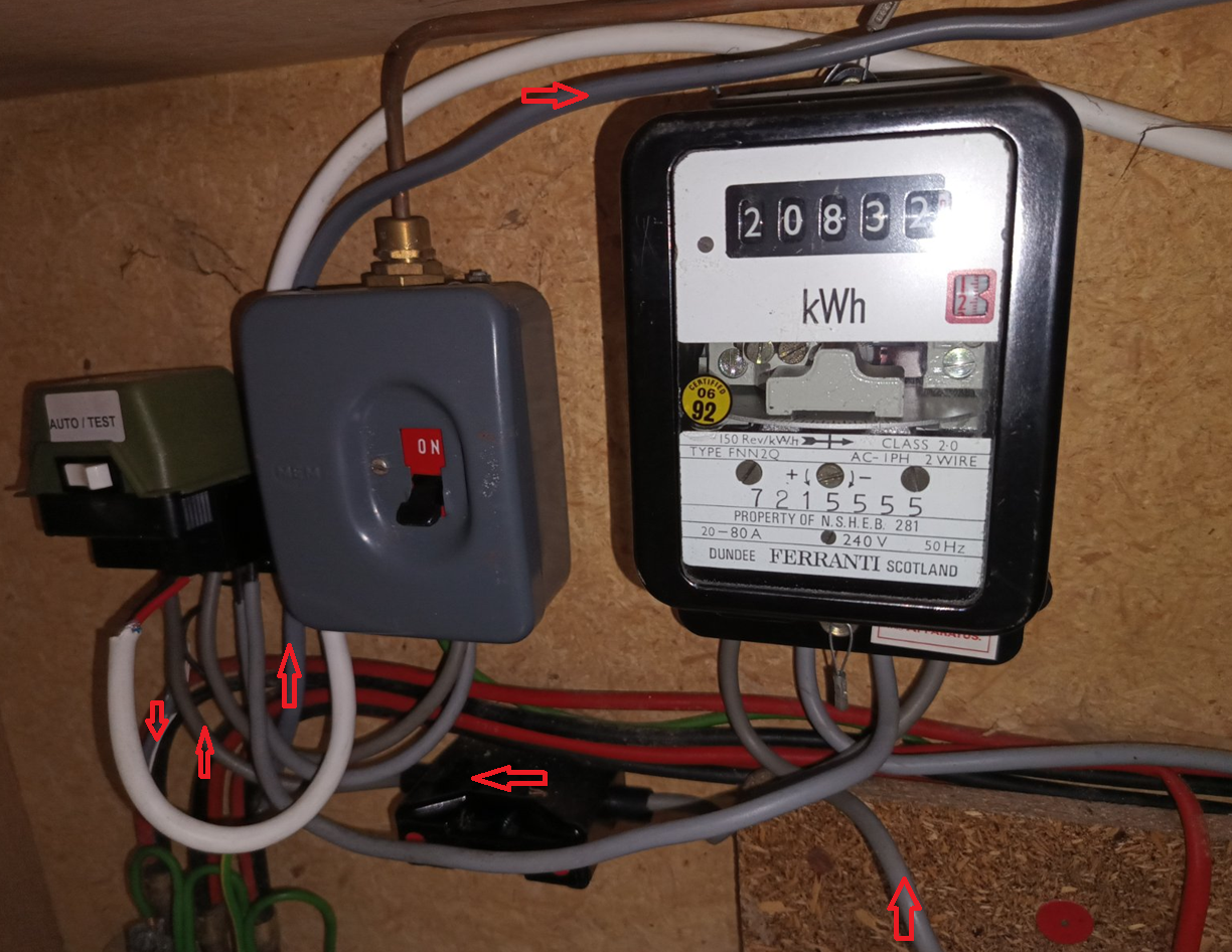

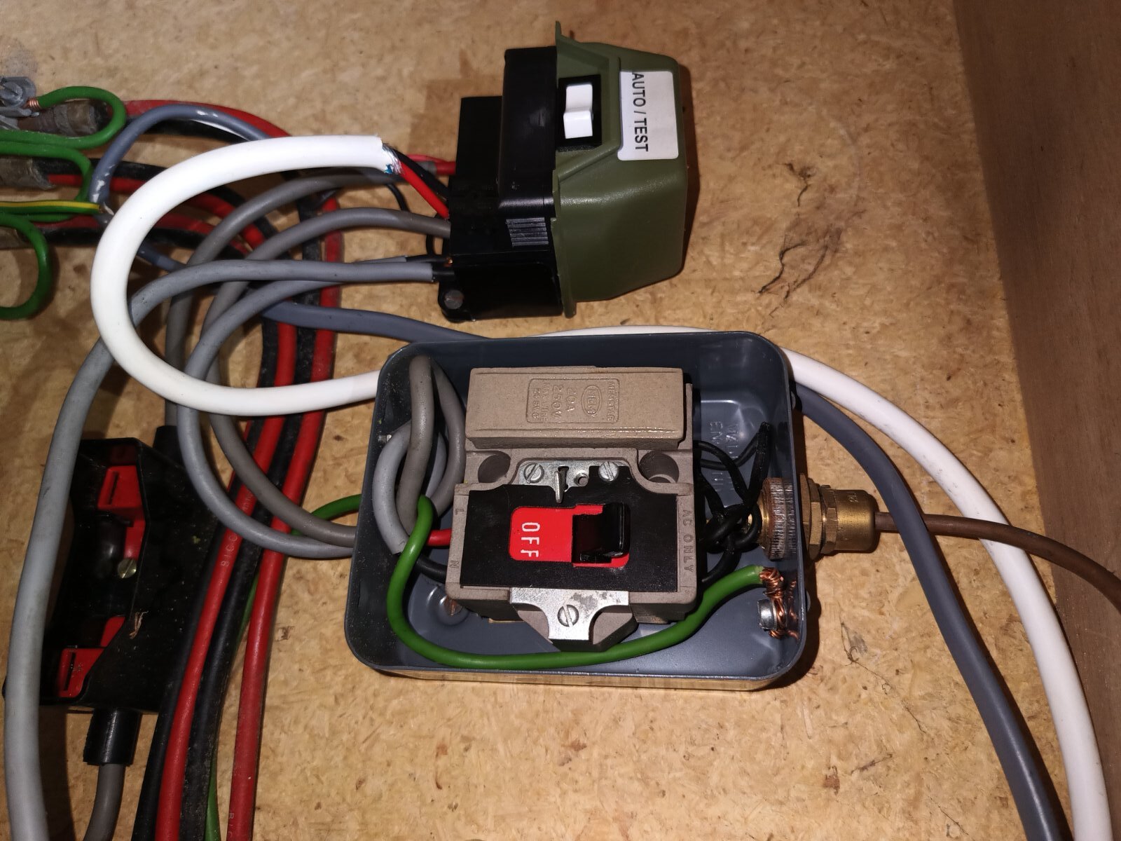

Stairwell lighting went off, needing advice
Have worked on those Royce Thompson units before.
That one looks a bit roughly installed though...
Not sure what the white cable is doing.

It seems to be a cut-out fuse, supplying the meter - I'll bet that blew as well.
That's a standard red spot BS88 fuse holder, used to be THE fuseholder used in control panels.
I think that fuse is on the load side of the meter, but I agree that it may well be popped.
The route of live is I believe:
In from cut out bottom right - meter - red spot fuse - Royce unit, teed to - T&E
So I'll assume the door entry system is on the end of that ask if it's working before checking the photo sensor?
I assume the 3 sets reds and blacks feed the three flats.

the gray cable on the top of the meter goes to intercom electronics. They work OK.
I dont see where the cables go so they can supply the lights, but I guess lights wont be supplied through the intercom electronics.
The BS88 fuse was blown. I did change it, it works now.
White cable comes from photocell outside.
Switching to test still does not turn the lights on.
I am still not sure about the copper "pipe" switch, what its' role is.

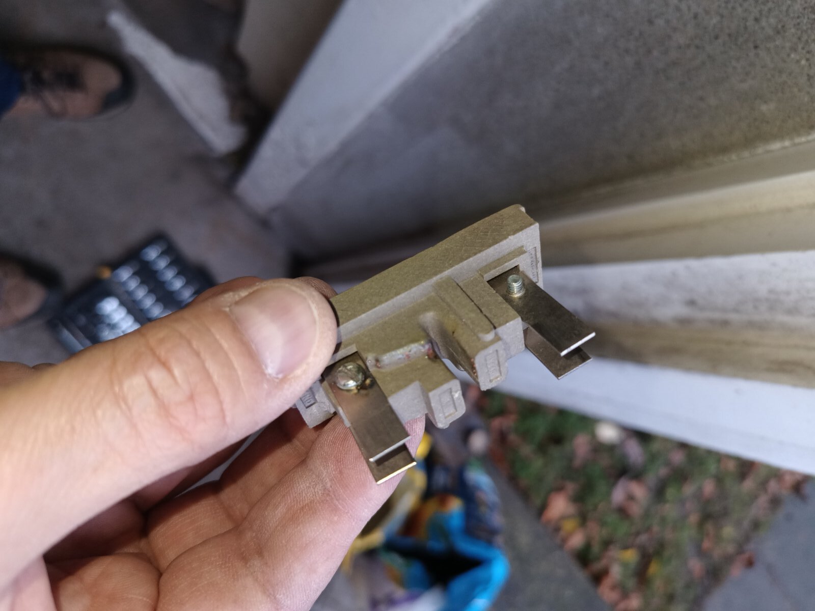

Yes, they push in, then slide up to lock into place. Strange use for such a fuse-holder - I wonder if the meter, is a privately owned meter, tapped into one of the flat supplies, then the freeholder was supposed to reimburse the cost of the used units, back to the flat owner?
I dont know if it privatelly owned, but there is a separate live cable coming from the ground to it.
So I guess it is Energy supplier's - or the council - this used to be council building.
It looks to me to be the type that just pulls out but it matters not. I would have expected to see something more like the MEM switched fuse

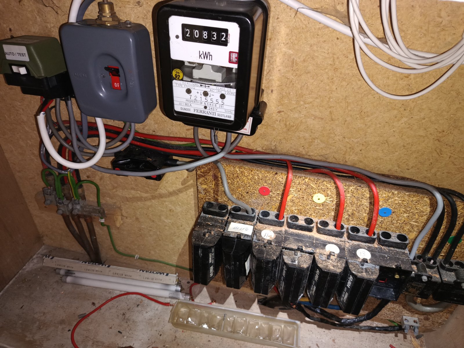

I assumed below to the right is a 3 phase company fuse feeding the 3 red cables running horizontally and then down into conduits (but this is all sopposition). It appears to be an official meter with an official coded seal so I assume its a standard energy suppliers meter with a standing charge. Another picture of that area would be likely to confirm that but it's unlikely to make any difference to the lighting fault.

So you have power
No
Yes it's a standard arrangement

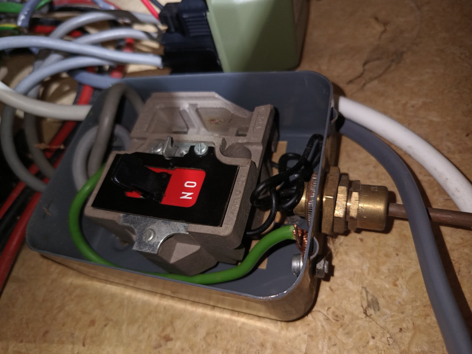

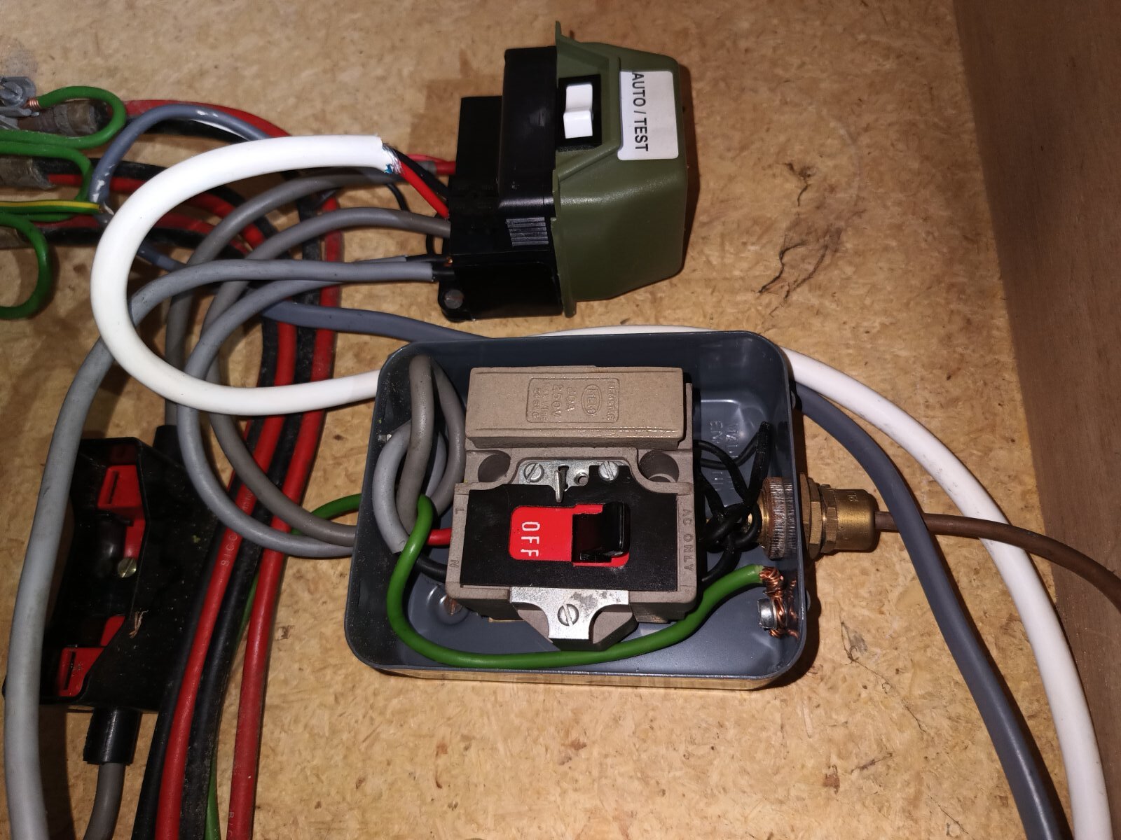

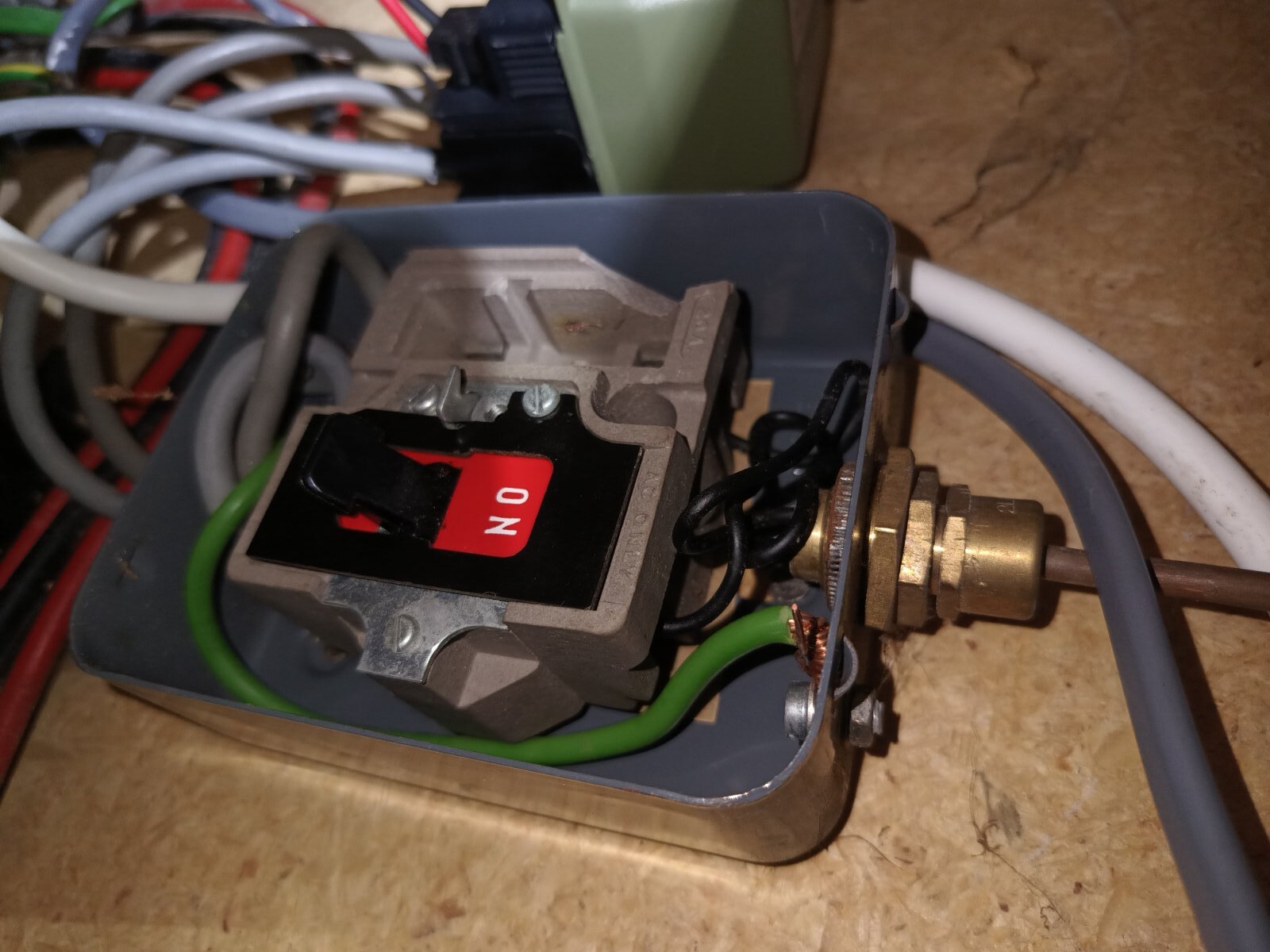

I assume the 'copper pipe' is the outgoing cable (MICC - Mineral Insulated Copper Cable) which heads out to all of the lights. As endecotp says the grey MEM box is a switched fuse, check to see if thats blown too.
This is getting even more weird.

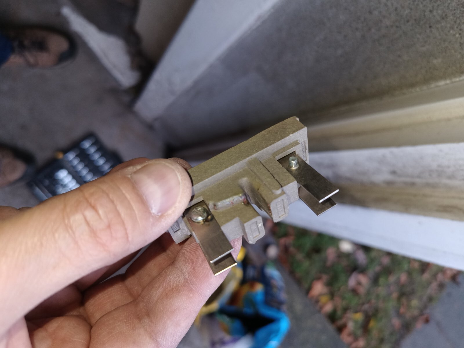

I opened the MEM switch. There is a 20A fuse in there. Also blown. Will rewire it.
In the meantime I connected the terminals of the mem switch fuse with a bridge wire and set the photocell to test. Still no lighting. I can see current to the upper terminal of the mem switch from where a black cable runs in the copper pipe to the lights.
I am at a loss here.
How can both fuses be blown, one 16A should have been blown and that is it. How the 20A got blown? And if they can both be blown, can anything else on the circuit be fried also? The cable itself?
The problem started after a very weird event. It was very cold here for a week - 0C. The stairwell is external so all the walls were at 0C. All of a sudden temperature went to 13C in a day, and it was very humid. I saw so much water condensed on the walls and ceiling that it was dripping on the floor. So my theory is that it might have gone to the light fixture connection terminals. Not sure what's going on. :mad:
How are you 'seeing the current'?
My earlier assumption was wrong about that black fuse carrier - it is preceded by a company, cut-out fuse. It goes -
cut-out, black fuse, MEM fuse, then to the lights.
