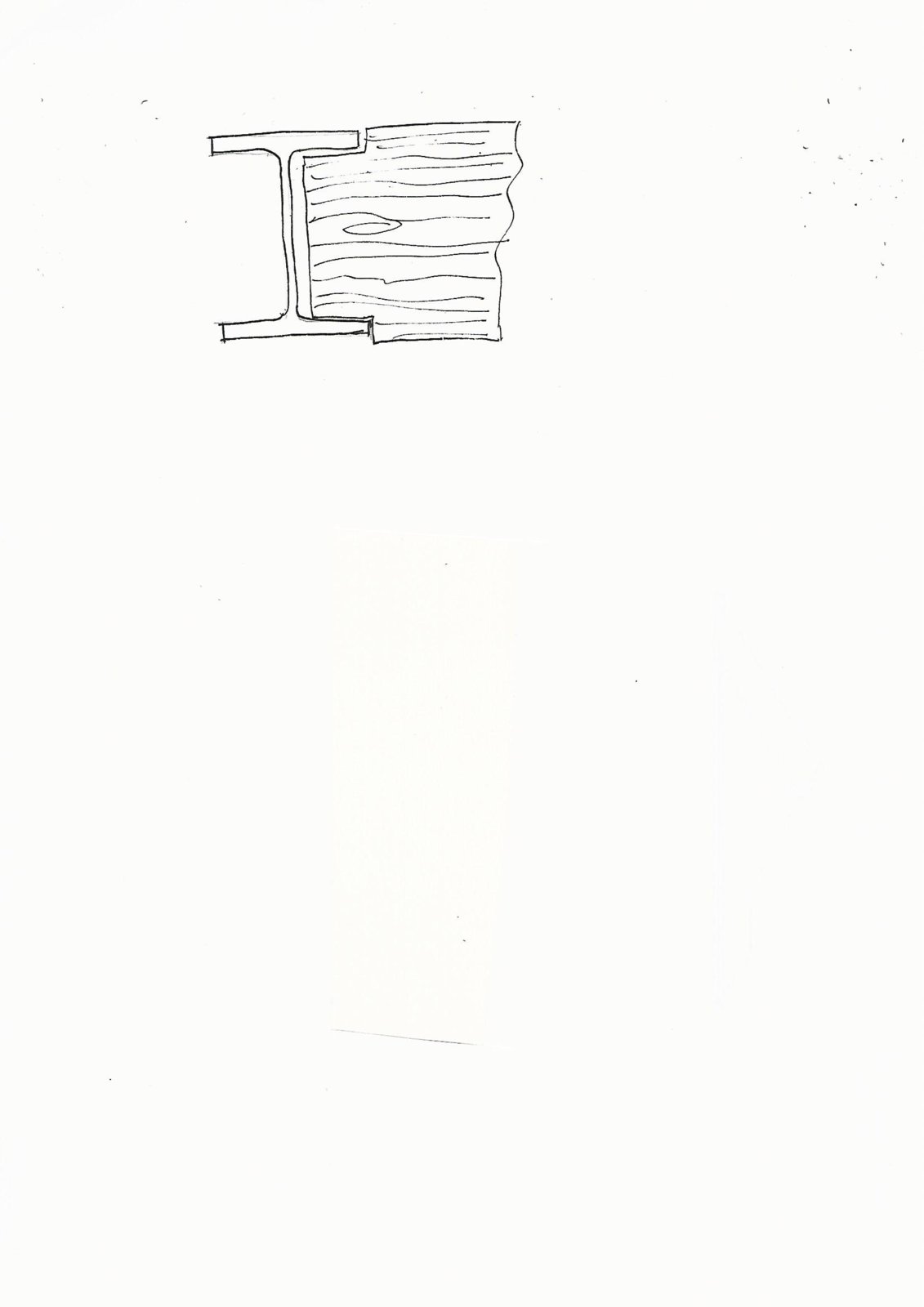

(By the way, you can notch the joists if you want to sit them direct on the bottom flange; notching a 175 deep joist into a 178 deep UB will not be a problem). Alternatively, if you want to use joist hangers, you will need to bolt a piece of timber to the web.

You can notch the underside of the joists as well.

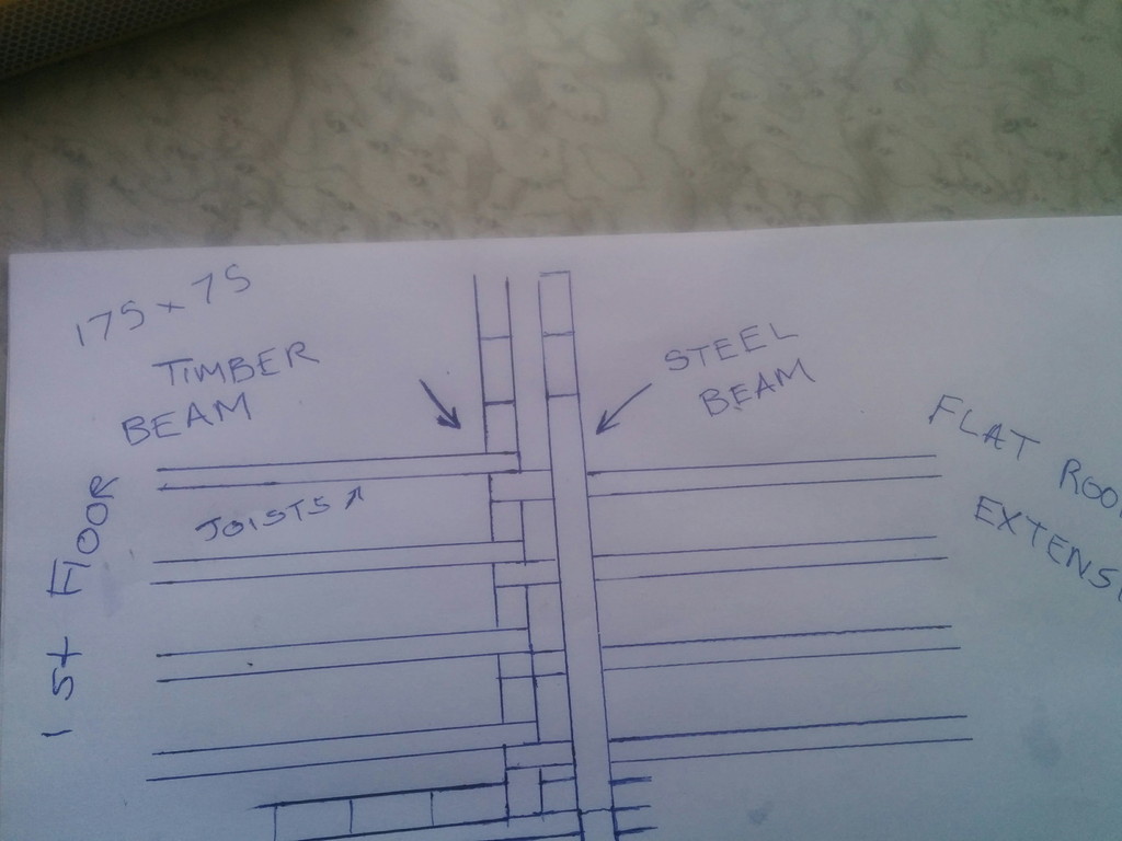

(Still can't work out what's going on - you shouldn't have the skin of a wall supported off the joists.
Are there any pics/details?).
Eeek that's not good then. I've just done a drawing which hopefully helps. The extension is part of the kitchen and leads to the garage on the side of the house. The timber beam is on the inner leaf and supports both sets of joists and the steel beam on the outer leaf is above the joists of the extension. The exterior wall does have step cracking and was flagged up in the home buyers report
When I did speak to SE about it he said it seemed OK with how it was done. It was something that builders use do but after running the calculations said it was not adequate
If you can't do it like as in my drawing then maybe the only way would be to have two beams but have them under the joists just to make sure that it doesn't cause any issues with ventilation.

I can't understand why the flat roof joists run onto the existing timber beam of the inner skin and under the steel beam?
If ventilation was to be a problem, you should just have a warm flat roof (with the insulation on top of the deck). That completely avoids the ventilation problem.
The correct way would be to have the underside of the new steel beam at the same level as the underside of the old timber beam, and run the new roof joists onto the bottom flange of the beam. That way you could achieve a flush ceiling.
You seem to be making a complex and difficult design to solve a problem (ventilation) which could be solved in a far easier way.
You bolt a timber in the web, and then fix hangers to this and over the top of the beam.
Loading the flange is how the cowboys do it.

It should not be a problem if done correctly. NHBC Standards below.
6.4 - S6
Joists shall be properly trimmed into steelwork
Joists trimmed into steelwork should be notched at both top and bottom and have 12mm/2mm projections respectively to allow for timber shrinkage.
(b) bearings onto steelwork
Strutting should be provided where solid timber joists bear on, or are notched into, steelwork to prevent rotation.
Because the web takes the load.
Yes, normally an incoming beam is bolted to the web via a welded end plate. In that way, no torsion is imposed on the
supporting beam.

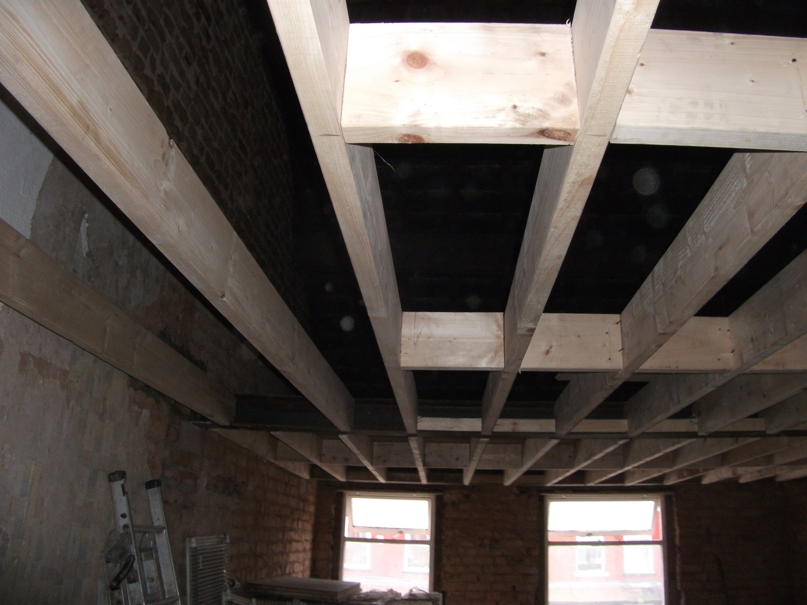

But domestic floors are relatively lightly loaded, and the eccentricity caused by loading the bottom flange is almost always inconsequential. Here's one with the floor joists notched onto the bottom flange of a 152 x 152.(not too clear unfortunately)
