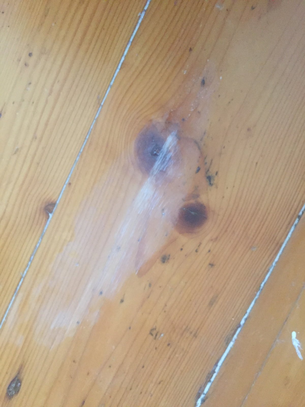

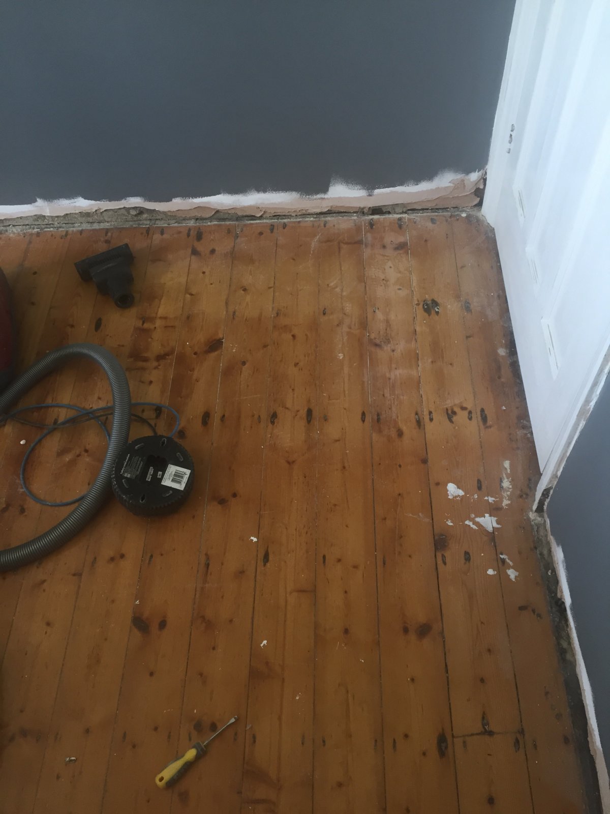

I’ve tested a small area, the thing is my flooring has already been fully sanded down previously and then lacquered so all I’m wanting to do is just get rid of some stains/scratches. I tried a really small patch with a belt sander on 80 and it just seemed to scratch it. I then used a mouse sander on 120 and it takes a bit off but would take forever. Just wondering if the belt sander might be a bit much or wether just to try it on 129?
I’ll attach some screenshots of my floor.
The close up shows the 80 grit mark.
Cheers

Try a finer belt on the belt sander, if you want to speed it up.
A random orbital sander would be quicker than the mouse sander, but if you've not got one, you'll have to use what you have.
The floor looks in pretty good condition, just don't press too hard with the belt sander.
Good luck.
