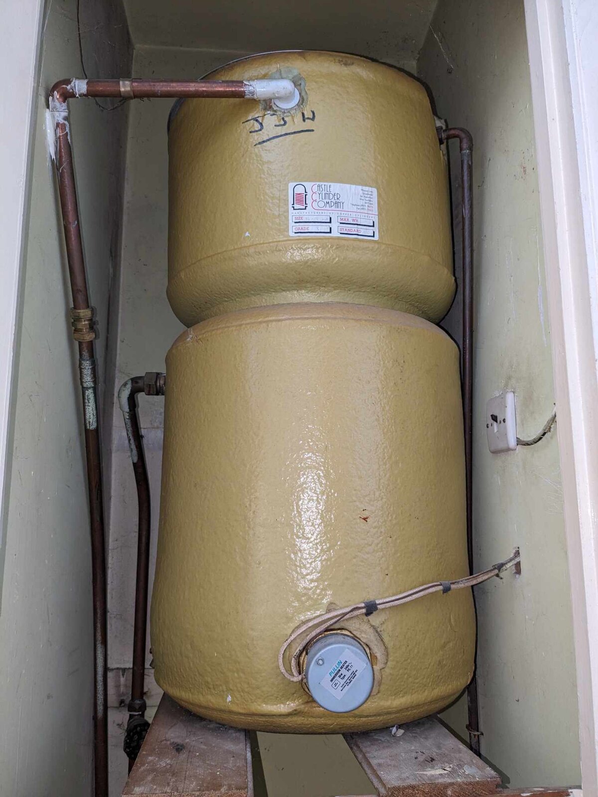

My family and I live in a bungalow, we have lived there for nearly five years. The property was built in 1964. I want to turn off the water supply so I can install a washing machine, the other place where we lived had modern fittings at the back of the washing machine to stop the water.

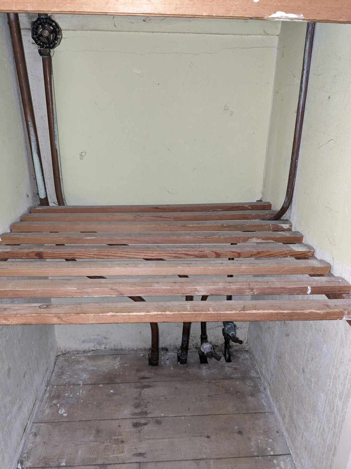

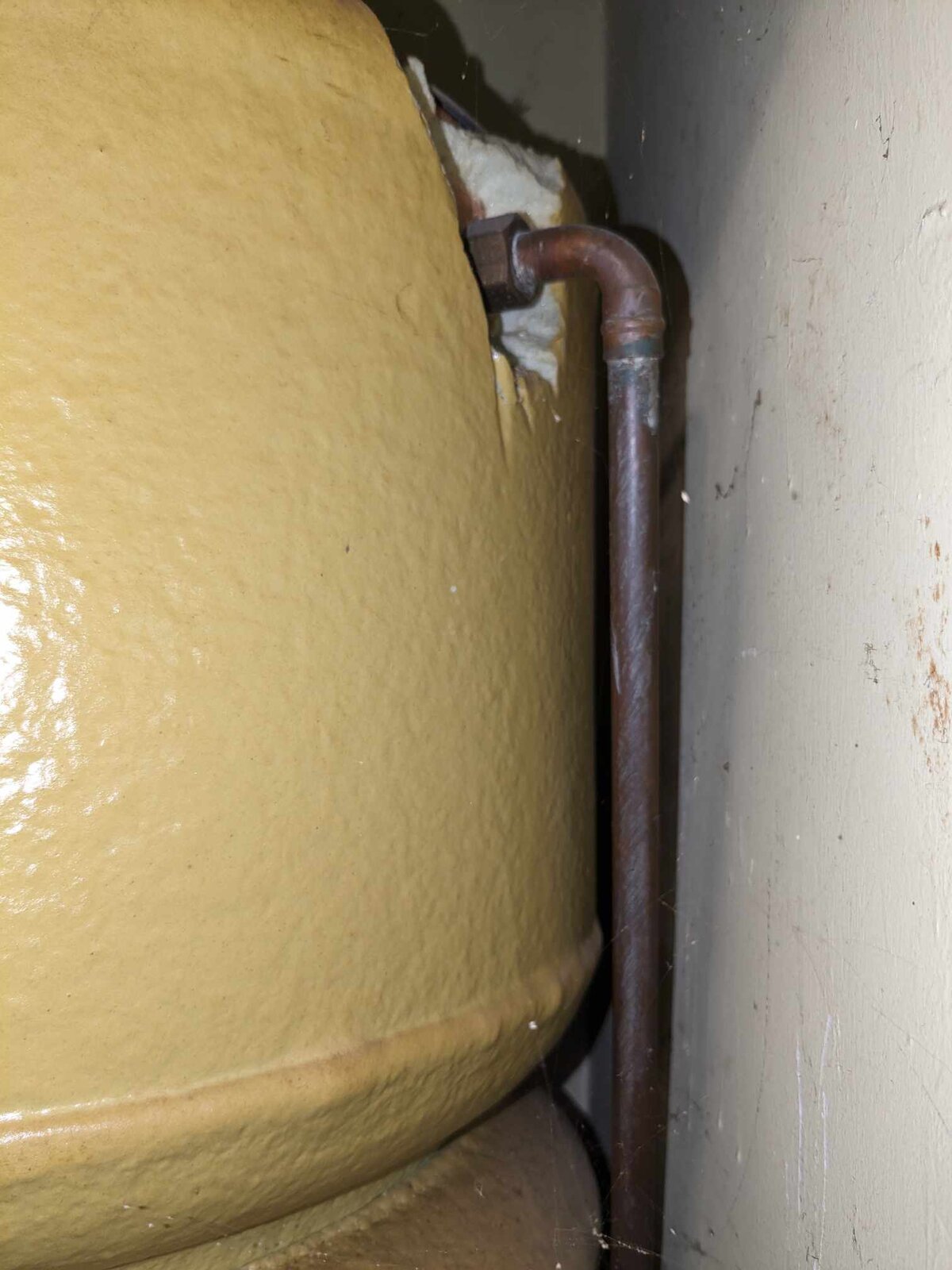

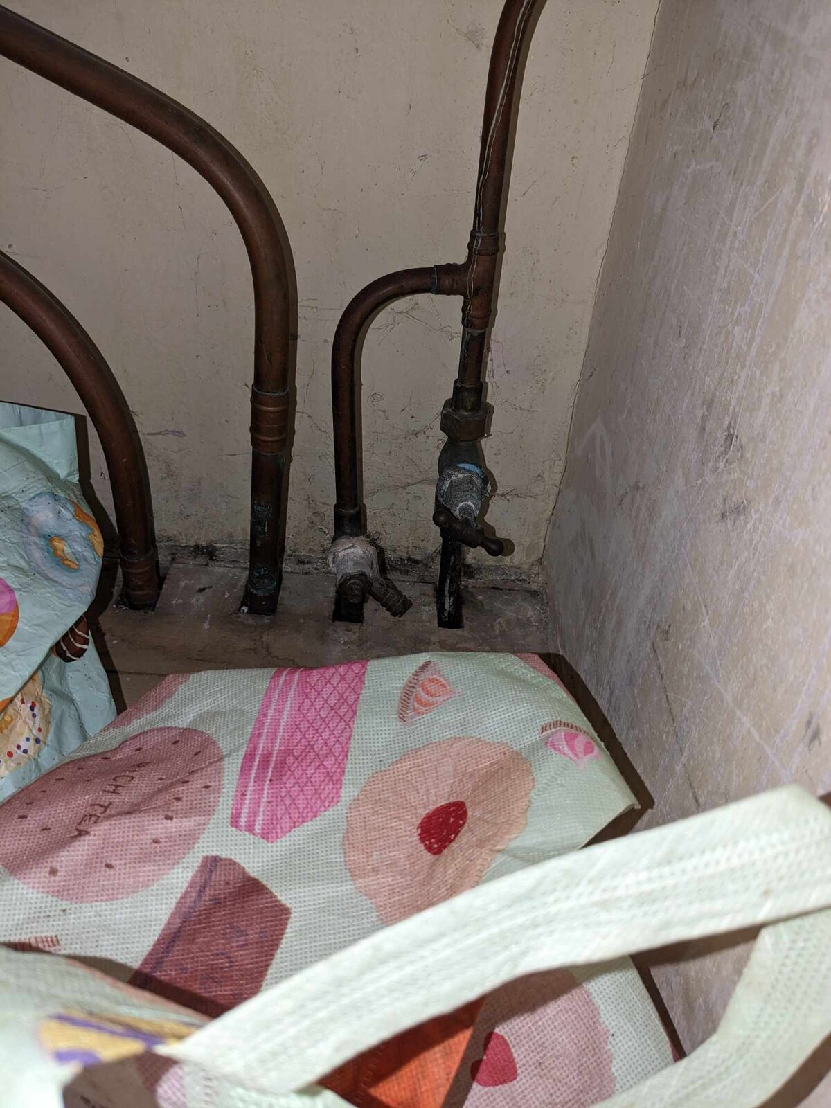

We cannot find the stopcock in the kitchen, we have looked under the sink and cupboards. , There is an old boiler in the airing cupboard, on the top there is a big black round handle, I sure this for the hot water, right at the bottom there is what I think might be the stopcock.
Here is a couple of pictures of the tape/pipe in the airing cupboard.
Unfortunately I turned this stopcock clockwise and also anti-clockwise and it made to difference to turning off the water.

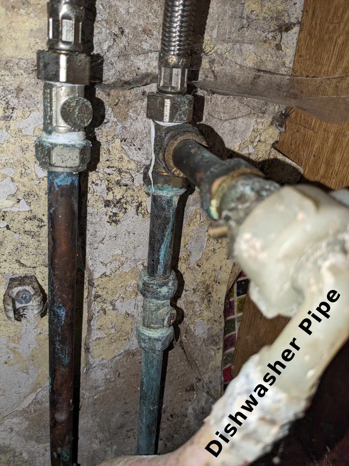

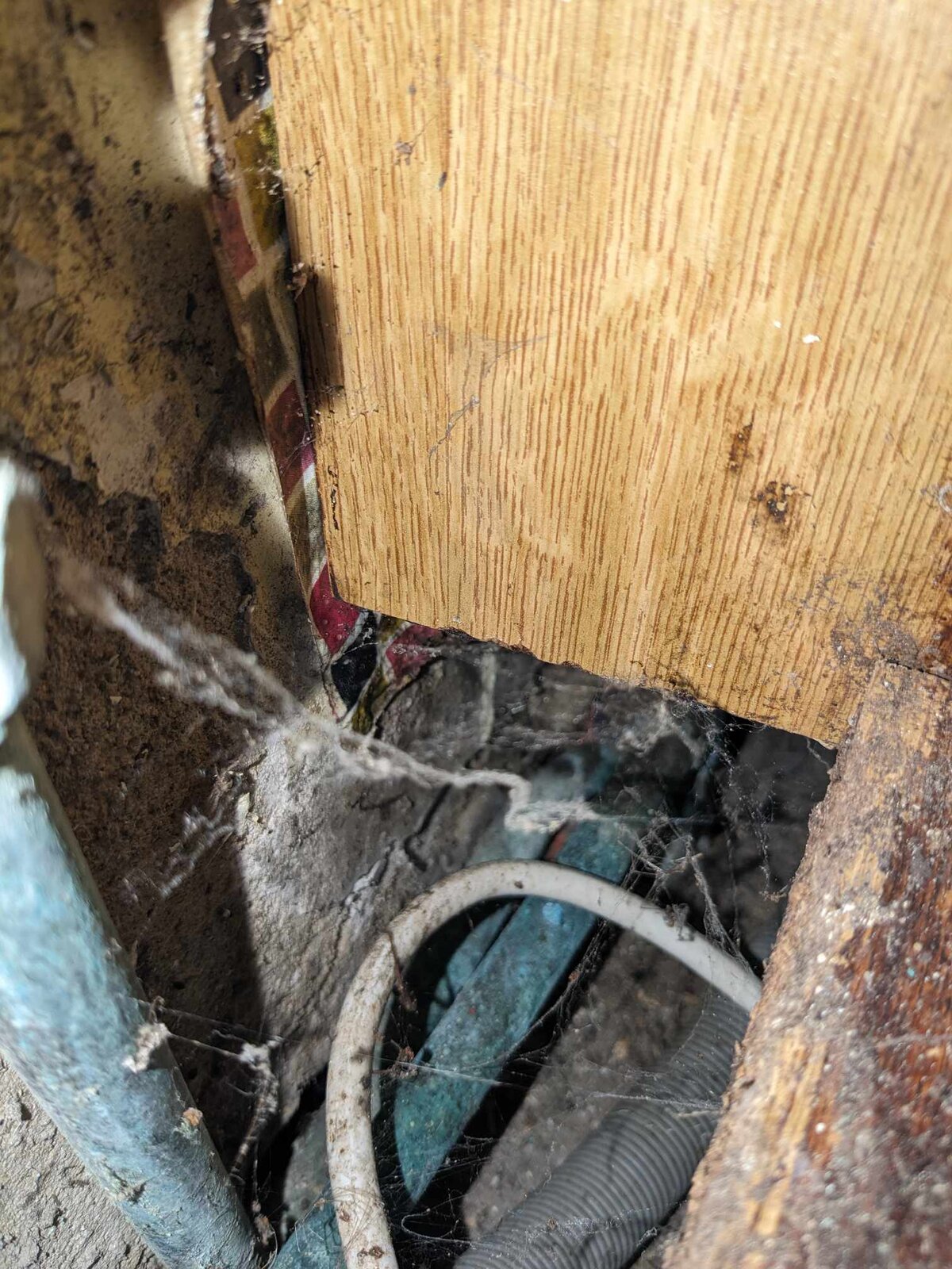

I have looked under the kitchen sink and right under the unit and nothing to turn off the water.
How far did you turn it clockwise? Should be until you feel resistance.
I turned it until it could not turn anymore, plus water slightly leaked, when I fully turned anti-clockwise, the water from that pipe stopped leaking.
  • Thanks
Reactions: CBW
Ok, so there’s a leak on the gland nut too. Did you notice a reduction in flow rate from the cold taps?
Definitely looks like the stopcock. Might just have no washer. Can you turn off outside?
