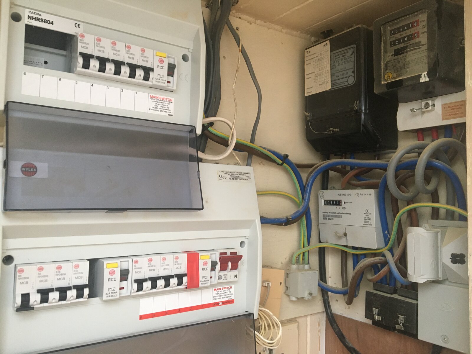

Show us your electricity meter, and the boxes and cables around it please.

Here’s the boards (storage and water at top), meters (24hr at top) and teleswitch.

What I believe I see there is the white meter feeding only the Teleswitch and heater CU. and a dual rate meter controlled by Teleswitch feeding the mains CU.
Incidently you need to fit some blanking plates, as it is you can put your fingers on the live busbars.

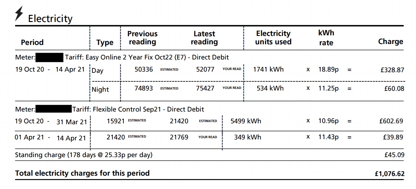

The supplier is EDF. And yes, we're in Scotland. The house has recently been insulated (it was a drafty old croft house but now has an internal 'kingspanned' frame so historic usage probably isn't too helpful) and I'm in the process of moving away from old-style Dimplex storage heaters to Quantumns.
Below are the supply times, and the tariff details are in the attached image.

I think the "flexible control" tariff is the one that goes on and off, it seems to be a cheap rate.
the appearance of the bill is rather unusual

I think the "flexible control" is indeed the "on/off" tariff, although EDF seem to have various versions of "flexible control". They're one of the few energy suppliers who will take on the Total Heating with Total Control metering setup which is still very common in my area.
I really should have done that before posting a picture online! I'll get on it...!

If you can find out how the metered price changes, it will make your question, and the answer, clearer.

Now I'm confused on how your system works as the Teleswitch seems to switch the power to the NSH CU on the flexible rate and also control the E7 which seems to feed the 24Hr CU. I don't know enough about Teleswitches to know if they are capable of doing those two services at different times.
