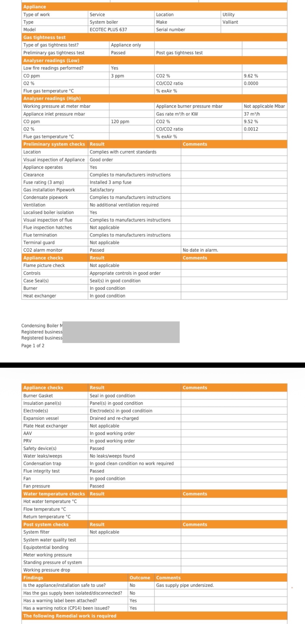

First of all, Im on a learning curve with this topic so any help/ guidance would be greatly appreciated. Thank you!
Long story short, boiler broken, PCB and gas valve replaced (was told that one might have short circuited the other). All working afterwards and engineer also did a service (certificate attached). However, he told us that “Gas supply to boiler under sized. 18mlb at meter & 9.5mlb at boiler on max rate”
The same engineer serviced and issued all-clear certificate last year so I’m shocked now that he said the pipework needs replacing and “happy to ring the office to give you a quote”.

P/S: the gas rate (on high) in the attached certificate said 37 m3/h but I think he probably meant 3.7m3/h? If so, this appears to be within normal range, but how does that work given the pressure is low?

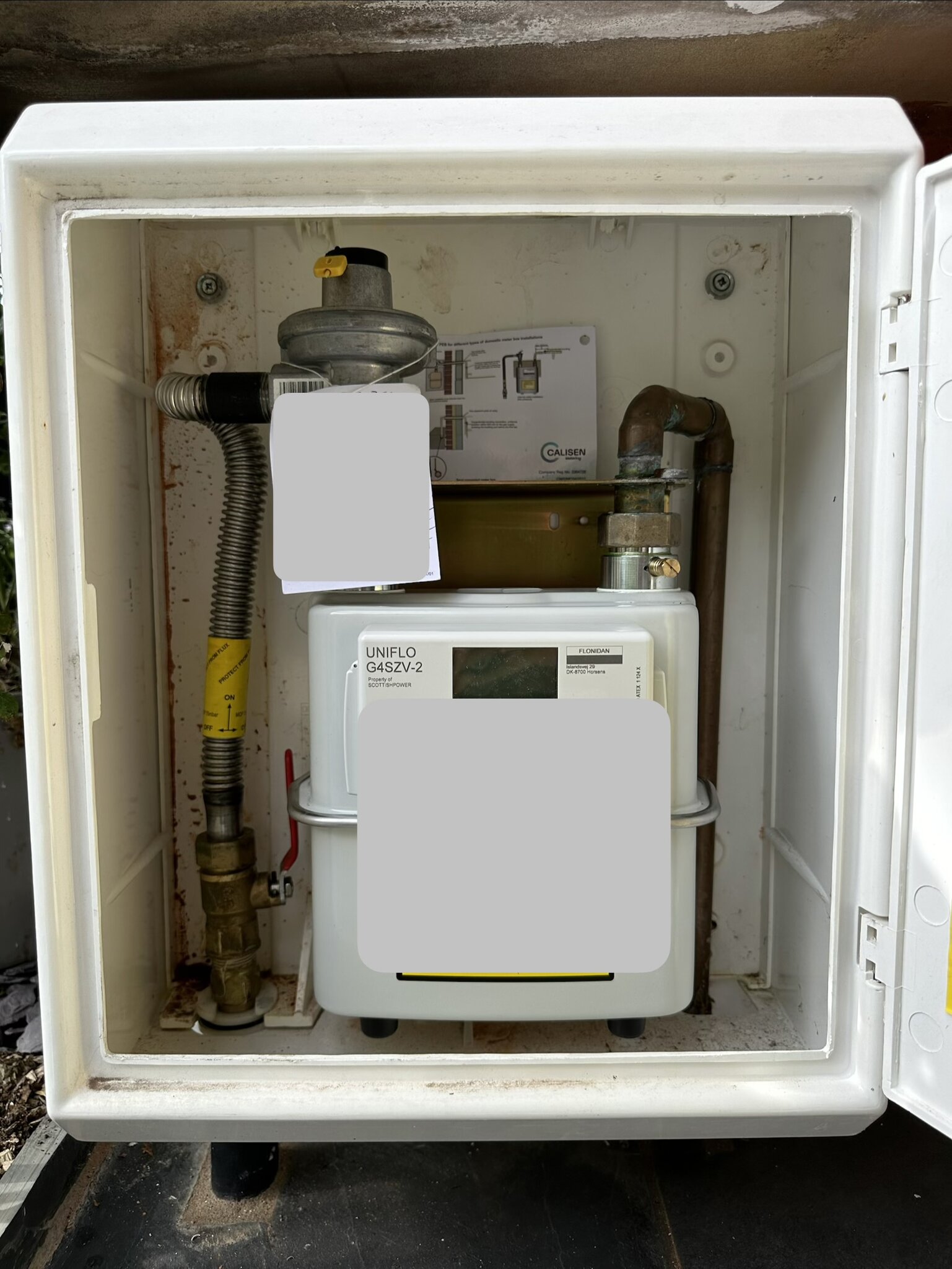

Supplier won’t do anything as it’s not their responsibility, it’s yours. Supply at the meter is only just under at 18, can now be 18.5mbar. If you’re getting 9.5mbar then something is definitely amiss. Do you know what test program was used? Gas rate definitely wrong as well.
It's nothing to do with the supplier.
That's a big boiler you have there. If you have less than 25 rads it's probably never getting to max rate anyway.
What size is the gas pipe and how far does it run?

Suppose I’ll have to measure the pipe on the right of the meter in picture (one that goes to my house)?
We have only 7 radiators, 2 hot rails in the bathrooms and 1 underfloor heating for a c. 350sqft open plan kitchen. So definitely less than 25. The boiler also heats our water cylinder.
On our full use, both heating and hot water on, the flame icon on the boiler has always remained 1/4 of the bar, never reached above 1/3 (not that I’ve seen).
Been running for 10 years with no issues. Last year, the supplier changed to a smart meter (but don’t think this has anything to do with it?). The meter is about 9-10 meters to the boiler.

37 m3hr may have a missing decimal point or perhaps he forgot to change it to 37kw.
Seems a more likely mistake to me and possibly it wasn't gas rated.

Thanks. I did not get the chance to check the reading when he was doing the work. But you are right, the pressure comparison were 1) at the meter and then 2) at the input to the boiler. At boiler, the 9.5mbar is very low vs manufacture recommended pressure ~17mbar (Vaillant EcoTec plus 637).
What I’m struggling to understand is, if pressure is so low as he said, how can the boiler still deliver burn rate 3.7 m3/h (under max load). i.e. the volume of gas delivered to the boiler under max load is still well within manufacture range (max 3.8 m3/h) despite the pressure being just over half of manufacturer’s working required level (9.5mbar vs 17mbar)?? Or is there no relationship between volume burn and pressure?
