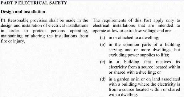

What does that mean? It seems to be an odd comparison - Part P is one sentence, but BS7671 is well over 500 pages.

BS7671 is not law, Part P is law although badly written, we know following BS7671 the requirements of Part P are normally satisfied, however there is nothing in Part P which says "I being the person responsible for the design, construction, inspection & testing" that is BS7671 there does not need to be an insulation certificate, in fact since only the person doing the work can sign the installation certificate if you go down the LABC route often all you have is a completion certificate you don't have an insulation certificate.
P1 is the legal instrument. I think it is perfectly well written.
Maybe you are referring to that guide thing that is called the “Approved Document”.
That is Part P in its entirity. THERE IS NO MORE.
Approved Document P is an irrelevance.
