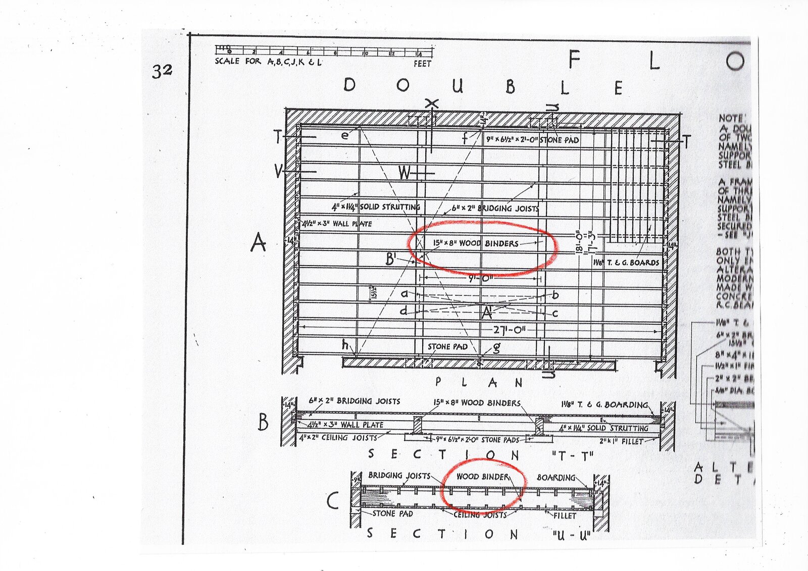

Support for new floor joists in loft conversion short of supporting wall
I had something similar a few years ago and for some reason the SE had done all in wood, no steel.
To support the eaves floor joists, we had to fit a wall to wall beam underneath, in the ceiling below and then box it.
Another solution, maybe easier for you.
Yes, of course it would need calculating.
('Binder' is just an old term for a floor-supporting beam - ref. McKay).

That would be a solution in many cases, but in the OP's case, such a beam might cut across the dormer window.
Refresh my memory "McKay". I seem to remember that reference from the dim and distant past
'McKay's Building Construction', the standard work for trainee architects from - I think - the early 1930's. My own copies go up to 1939 - not interested in anything since then.

Yeah, binders doing binding, not beams doing holding up floors. o_O
I bet old McKay is rotating around his neutral axis. May I be the first to welcome you into the 21st century.
How?
The beam would be below the loft floor joists.
To be clear, on the ceiling of the floor below the loft.
That timber beam/binder won't work if it can't go in in one piece, and I suspect the dormer window will be a factor on that side.
