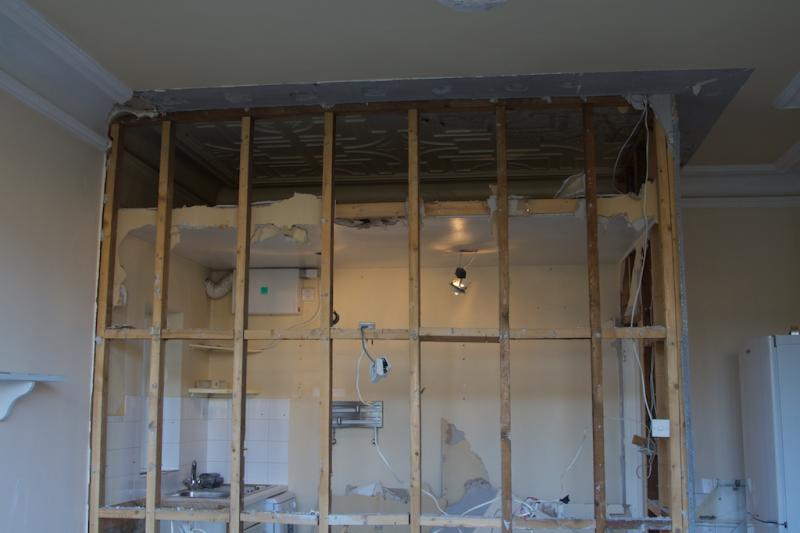

Ok so here is the wall, with the plasterboard removed.
Now from the picture it is pretty obvious that the partition was put up at a later date to the original building construction, as you can see where the old coving goes around the room.
My next question is, is it coincidence there is a solid wall above in the same position? Or maybe the brick wall was always there and they just copied the layout for the remove below when the flats were converted.
The house was converted to 4 flats in 1979, which I assume is when the kitchen partition was built. Is there any reason to build the ground floor partition in a wood stud, followed by a brick wall above it in the first floor?
What do you mean by: "to build the ground ... brick wall above it"?
Careful measurements should be taken at the floor above to determine with certainty, that no other wall sits above the lower studding or even sits near to it.
Its most unlikely, but check.
Why have you damaged the ceiling plaster and the coving? The studding will come down with a minimum effort.
Typo, i meant to say "Is there any reason to build the ground floor partition in a wood stud, followed by a brick wall above it in the first floor"
That's my point. On my level, ground floor, I have the stud wall. Above it in the first floor, a wall sits above. Below the ground floor in the cellar is empty.
The coving used to go around the room, but when the partition was put in the coving was redirected around the new stud wall - and hence a chunk was cut out of it.
The ceiling plaster came off attached to the coving.
Anyway, no matter as most of the coving around the room has seen better days - so it's all coming down and I'm sound proofing and re-plastering the ceiling.

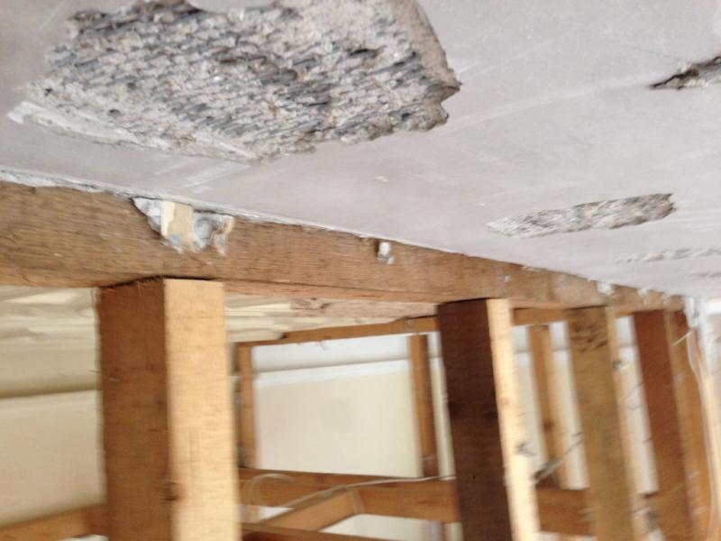

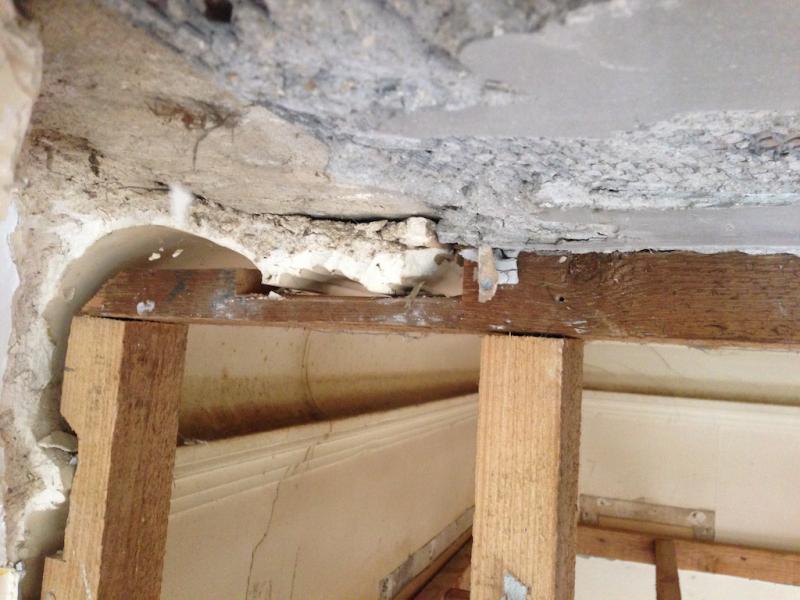

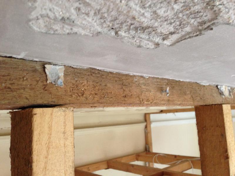

So anyway,.... to the point. There is a solid wall above that - and it's probably been there for 35 years, and it hasn't managed to compress that 2 mm gap between the pieces of wood.
Thin air doesn't hold up a brick wall.
