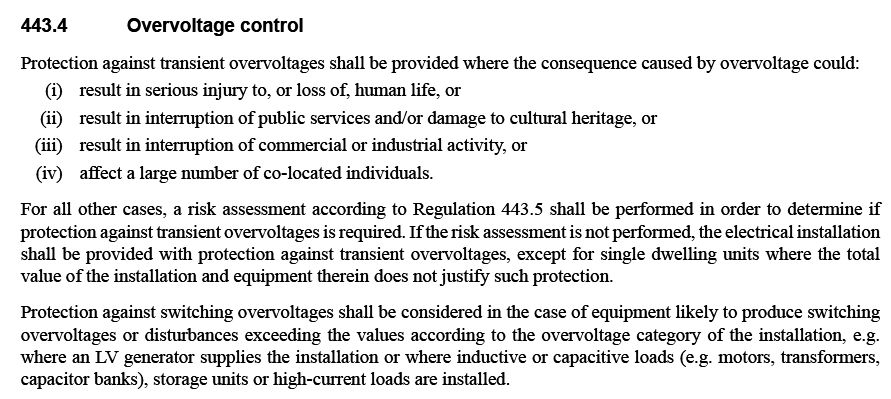

I believe in new installations to the 18th, a SPD has to be installed unless a risk assessment is carried out and says "no". If you can do not to do the risk assessment then the SPD become mandatory.
Is that so?
I think it says.
1) if you live in (e.g 1 bed flat) with little electronic equipment
or
2) You can see the substation from your window,
you don't require one
So SPDs should be in just about every new installation then? In short the norm, as RCDs became.
Commercial, industrial and most everything else that's not domestic - required
Domestic - risk assessment will indicate required or not, but that does NOT cover situations where overvoltage can be caused by things within the installation, so may be still be required even if the assessment says not.
If risk assessment is not done, required unless value of installation does not justify protection.
Installations with nothing of value worth protecting are exceptionally rare, as are those that don't have inductive or capacitive loads.

My point is that the scenarios in which a SPD is omitted will be so few that most CUs fitted will have one. An e.g., even though RCDs were not mandatory they were being fitted becoming the norm.

single dwelling (house)....recommendation only....if the client says no then doesnt have to be fitted
Why is "transient suppression" necessary ?
Because too many appliances / lamps / etc are so poorly designed that they self destruct when they get a piddly little transient up their input circuit.
And/or
The supply network is now compromised by :-
(1) solar PV networks coming on and off line ( tend to be surges rather than transients ) but a 11kv -> 230v network transformer can "spike" it's output when the load on it changes due to a significant PV event
(2) other customers with large inductive loads.
(3) other customers with large capacitive loads.
