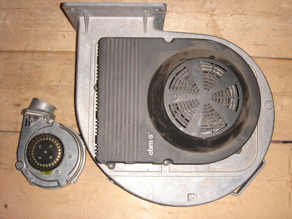

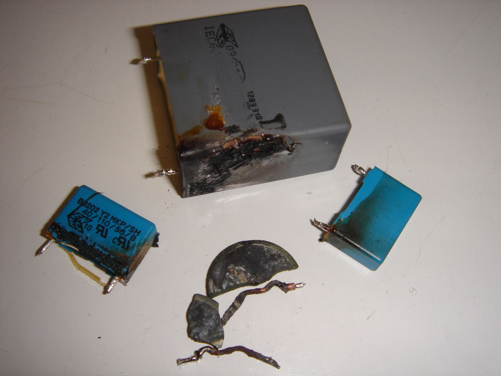

MOVs are a pretty standard component in any electrical device connected to the mains nowdays...and I've seen many destroyed on boiler circuit boards. It's impossible to tell whether they have saved the board in the past by clamping the surge...I only get to see them when the surge has too much energy and the board dies.
Here's a £2500 commercial boiler fan...the MOV couldn't save it...the little fan's from a domestic boiler.
The have very limited ability to cope with surges and do tend to self destruct when faced with any serious surge, often leaving the circuit they were intended to protect, with no surge protection at all.
