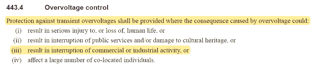

Hi, in a commercial unit with a completely new electrical installation inc DB etc.
Are SPD's required or just a nicety?
I know what they are, how they work and how they are fitted but not if they are needed.
There is a calc that can be done but I cant figure it out, the equipment they protect would be more than 5 times the SPD's value.
Required in almost all installations.
The calculation is mostly useless, if you get to that you have probably missed something already.
Even if it's actually needed, the calculation only covers transients from lightning. Transients from other sources must also be considered.
The section about value of the installation is irrelevant, there are no installations that have nothing of value in them.
I'm a little confused. Why are you highlighting a requirement for SPDs to protect against "interruption of commercial or industrial activity" in this DIY forum which is clearly intended to relate primarily to domestic electrical installations?
Edit: Ah, I've just properly read the OP, which relates to a commercial installation - my apologies. However, your initial response said that SPDs were "required in almost all installations". Did you intend that to also only relate to commercial/industrial ones?
