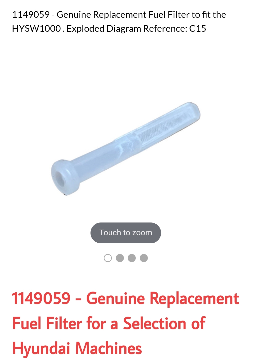

Sure.....some makes have a filter in the fuel feed pipe, others have a fine gauze filter in the tank itself and nothing in the pipe.
If you can give us a pic if it’s the former that would be good!
John
It's one of these, I saw the end when I took the hose out. I'll see if a quick wipe will do the job, the grass really needs cutting this weekend
